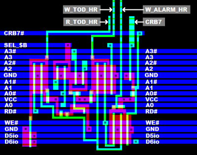

6) address decoder
The address decoder generates all of the high_active register read/write control signals.
It is fed with the RD# (read enable) and WE# (write enable) control signals
which are generated in "2) CS#, R/W#".
It also is fed with the high_active address signals A0..A3 and the low_active address_signals A0#..A3#,
which are generated in "3b) RS0..RS3" for selecting the register to be read/written.
Also, the CRB7 control register B Bit goes into the address decoder.
If CRB7 = 0, writes to address $8,$9,$A,$B write the TOD counter registers.
If CRB7 = 1, writes to address $8,$9,$A,$B write the ALARM registers.
Note the high_active select signal SEL_$B,
which becomes active if the address signals say $B,
regardless of RD# and WE#.
It goes into "14b TOD control".
The address decoder is built with NOR gates (plus a few inverters),
it breaks down into individual blocks (for the different registers),
and said blocks are spread all over the chip.
In the North half of the chip (6a..6e),
the address decoder blocks generate the read/write register control signals
for timer A, timer B, CRA, CRB, ICR.
Every single control signal is generated by a 5 input NOR gate.
Note the FET which pulls D4io to GND when R_CRA goes active for reading CRA.
In the South half of the chip (6f..6h),
for the parallel I\O ports, the serial port (shift register),
the TOD counter registers, and the ALARM registers.
In every block, we have a 4 input NOR gate decoding the address,
which feeds an inverter.
The inverter output goes into two NOR gates
(one generating a read control signal, the other generating a write control signal),
for the TOD counter and the ALARM register it's a bit more circuitry because of CRB7.
I think that the designers had used different address decoder circuitry for the
North half and the South half of the chip to make better use of chip space.
BTW: the address decoder blocks in the North have less propagation delay
than the address decoder blocks in the South.
TTL equivalent of the whole address decoder:

Now for the individual parts that make up the address decoder:

The boxes (14b,14c) are responsible for disabling TOD increments
when the CPU writes the TOD_HR counter register
(and for enabling TOD increments when the CPU writes the TOD_10THS counter register),
for freezing the read data latches between TOD counters and internal data bus
when the CPU reads the TOD_HR read latch
(and for making the data read latches transparent again
when the CPU reads the TOD LSB_10THS read latch).
