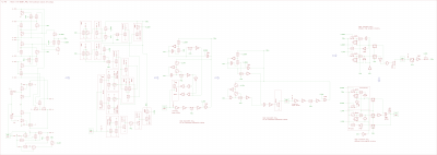

8521 dissection
Post by ttlworks »
Previous thread: 8520 dissection
//In some parts, 8520 and 8521 are pretty similar. In some other parts, they are not...
First: thanks to all those who make these chip dissections possible.
This thread is about a transistor level dissection of the MOS 8521 CIA (Complex Interface Adapter),
8521 features two 8 Bit parallel I\O ports (with handshake),
two 16 Bit timers (down counters),
a BCD real time clock (TOD, time of day) with ALARM function,
plus an 8 Bit shift register for "serial communication".
8521 is the HMOS-II successor of the 6526.
8521 is supposed to be a compatible plug_in replacement for the 6526.
8521 was used in: C64, SX64, C128(D), 1570, 1571.
Nevertheless, somebody better check for little differences between 6526, 6526A, 8521.
For instance, whether the ICR (interrupt control register) responds to an interrupt event\source
with a 1 cycle PHI2 delay or not...
Me and Frank were unable to find an 8521 datasheet in the internet.
So I'm linking to the 6526 datasheet intead.
Note:
Orientation for all the chip pictures: D2 pad is North.
8521\6526 internally are completely different from the 6522,
and to me it feels like the MOS designers simply had re_invented the wheel
after Bill Mensch (TM) had left MOS.
To make it short: the only thing the 8521 has in common with the 6522 is DIP40.
Now for the difference between 8520 and 8521.

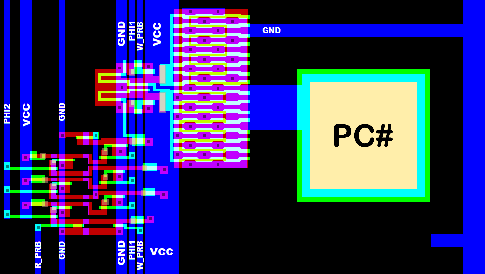

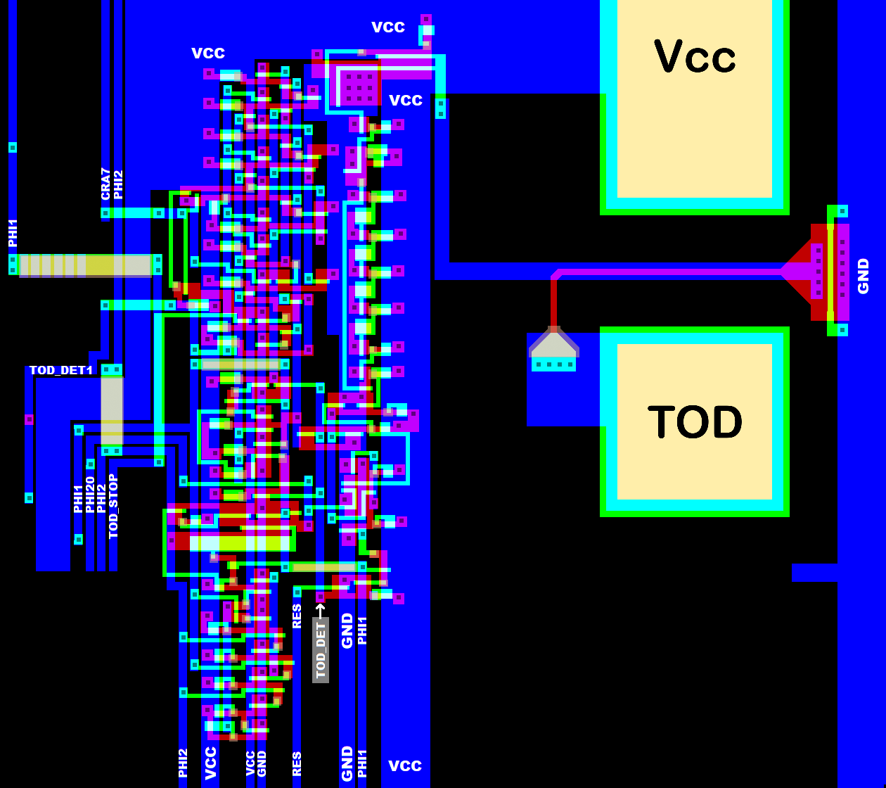

8520:
2) R/W# falling edge is delayed by an inverting super buffer plus three inverters.
4a) PA0..7 have push/pull outputs with a pullup to VCC.
4c) PB6 and PB7 have "open collector" outputs with a pullup to VCC.
5a) FLAG# pad has a pullup to VCC.
5b) TOD pad has a pullup to VCC.
5c) PC# output is "open collector" with pullup to VCC.
7a) CRA7 is cleared on reset, writing to CRA7 has no effect, CRA7 is unused.
8e) in one_shot mode, writing TA_HI sets CRA0 for starting timer A.
9e) in one_shot mode, writing TB_HI sets CRB0 for starting timer B.
10) interrupt source is delayed by one PHI2 cycle before it enters ICR0..4.
14) TOD (time of day) is a 24 Bit binary counter, counting rising edges on the TOD pad without a prescaler.
8521:
2) R/W# falling edge is delayed by four inverters. //slightly less delay than in the 8520.
4a) PA0..7 have "open collector" outputs with a pullup to VCC.
4c) PB6 and PB7 have push/pull outputs with a pullup to VCC.
5a) FLAG# pad has no pullup to VCC.
5b) TOD pad has no pullup to VCC.
5c) PC# is a push/pull output.
7a) CRA7 works and is used for switching the TOD predivider between 50Hz and 60Hz mode.
8e) only a CRA write can set CRA0.
9e) only a CRB write can set CRB0.
10) interrupt source is not delayed by one PHI2 cycle before it enters ICR0..4.
14) TOD (time of day) is a BCD counter, counting rising edges on the TOD pad with a prescaler.
//To make it short: to me, trying to replace a defective 8520 with an 8521 doesn't look like a good idea.

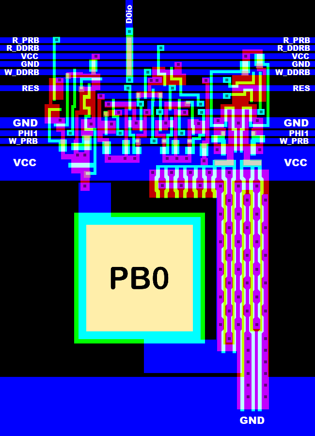

Bugfix:
[Jan 2024] //Maybe dissecting 8520 and 8521 in parallel wasn't a good idea.
Re_calculated resistor values assuming 10kOhm/square FET: 3c, 3c, 4a, 4b, 4c, 5c, 5d, 5e, 13. Done.
A pullup had sneaked into the schematics for SP, CNT: 5d, 5e. Fixed.
PB0..PB5 outputs were not push/pull in the schematics: 4b. Fixed.
Bugfix:
[Mar 2026] Thanks to Daglem for posting some comments\corrections.
Demorganization error in 8e), 9e): polarity of TA_Q and TB_Q was wrong. Fixed.
A transparent PHI2 latch was missing in my 10a) schematic. Fixed.
A pullup actually does not pull up to VCC in 10b), I didn't notice a missing via in the chip picture. Fixed.

Post by ttlworks »
8521r1_dissect_03_04_2026.zip
(866.28 KiB) Downloaded 8 times

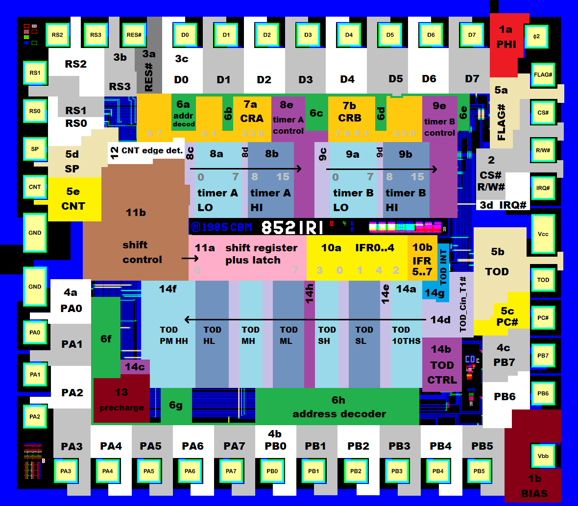

A picture of the 8521R1 silicon, with the interesting areas marked.
Just as a reference, another picture of the MOS 8521R1 silicon without the markings.
ttlworks
Posts: 1464
Joined: 09 Nov 2012
Re: 8521 dissection
Post by ttlworks »
8521R1 cheat sheet:
ttlworks
Posts: 1464
Joined: 09 Nov 2012
Re: 8521 dissection
Post by ttlworks »

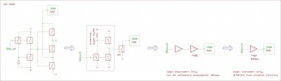

1b) bias generator
//8521 bias generator is completely different from 8520 bias generator.
Basically we have a ring oscillator, buit from five inverters.
In the signal path of the oscillator, R1\C1..R4\C4 set the frequency.
At the output of the oscillator, we have an inverting and a non_inverting driver.
The output of every driver goes through a big capacitor and into a
bridge rectifier which is built from four FETs working as diodes.
The output of the bidge rectifier then gives us the negative bias voltage.

4b) PB0
To the "end user", PORT B, PB0..PB5 has push/pull outputs with pullup resistors (FETs).
Note that when a PORT B pin is configured as an output,
what you are getting when reading the PRB data register is
what's on the PB0..PB7 pads.
So you better be a bit paranoid/careful when using read/modify/write instructions
on the PRB register, like when driving a large capacitive load,
when an external source might be able to switch PB0..PB5 to GND,
or when trying to go for faster speed.
Registers and logic related to PB0 are attached "to the other end" of the PB0 pad driver.
PORT B Register read/write control signals are generated in "6) address decoder".
Layout of PB0..PB5 is similar to the layout of PA7
(so I'm not going to explain the same circuitry again here).

The inversion/delay is done by four "open collector" inverters which have a pullup
to VCC and a capacitor to GND at their outputs, plus a normal inverter.
We have the first RS flipflop which indicates that there was a falling edge on the FLAG# pad,
it is set by the output of the detector NOR,
and cleared by the FLAG_INT signal (which sets the FLAG Bit in the ICR).
The output of the first flipflop goes into a multifunction gate,
which basically is a second RS flipflop gated with PHI2.
The (inverted) output of the second RS flipflop is sampled at PH1 by a dynamic latch,
goes through an inverter, and becomes the FLAG_INT signal,
which now nicely is synchronized with the system clock.
Signal FLAG_INT goes into "10) ICR".

Short form:
TOD pad is supposed to be fed with a signal generated by AC mains frequency.
A predivider is used for dividing the TOD pad input frequency down to 10Hz.
TOD (time of day) real time clock is a BCD counter,
to get a correct time said BCD counter has to run at these 10Hz.
In some countries AC mains frequency is 50 Hz,
then you need to write '1' into CRA7, to make the predivider divide by 5.
in some other counties AC mains frequency is 60Hz,
then you need to write '0' into CRA7, to make the predivider divide by 6.
Note, that there is no pullup resistor (FET) to VCC at the TOD pad.
//in the 8521, there is a pullup.
Long form:
Close to the TOD pad we have a ring counter which generates the PHI20 clock
for the TOD pad edge detector\synchronizer, for the predivider, and for the TOD counter.
I had labeled that clock signal "PHI20", because it is HIGH at PHI2 in every fourth PHI2 clock cycle.
Means that the TOD counter is clocked with PHI2/4, and enabled with a rising edge at the TOD pad.
When designing the circuity which extracts the frequency from AC mains and sends it into the TOD pad:
8521 has no pullup at the TOD pad. //8520 has a pullup at the TOD pad.
The TOD edge detector and synchronizer circuitry builds on the FLAG# edge detector and synchronizer circuitry,
but there are some differences:
There is one less inverter between the TOD pad and the edge detector,
so we have a falling edge detector scanning the inverted signal from the TOD pad.
//And that's like having a rising edge detector scanning the non_inverted signal from the TOD pad.
The multifunction gate containing the second RS flipflop is gated with PHI20 (instead of PHI2),
for sampling the state of the first RS flipflop,
to synchronize the output signal with the TOD counter clock PHI20.
A transparent latch samples the (inverted) output of the second RS flipflop at PHI2,
sends it into a NOR gate together with the RES signal.
The high_active TOD_DET output of the NOR gate resets the first RS flipflop,
aknowledging that the rising edge at the TOD pad was recognized.
Means that if there was a rising edge at the TOD pad while RES is active,
TOD_DET goes active after RES goes inactive.
TOD_DET is sampled by a PHI20 controlled latch, then goes into the predivider.
To be more precisely, it becomes the clock for the four dynamic master/slave flipflops
which make up the ring counter that divides by 5 (CRA7=1) or 6 (CRA7=0).
The output of the predivider counter Bits changes at the TOD_DET falling edge.
Three of the master/slave flipflops are actually counting.
The fourth master/slave flipflop clears the three counter Bits on predivider overflow.
High_active control signal TOD_STOP is generated in "14b) TOD control".
After a write to TOD_10THS, TOD_STOP goes active and prevents the TOD BCD counter from counting
by forcing the fourth master/slave flipflop of the predivider to clear the predivider counter Bits.
For cycle correct timing on how the master/slave flipflops respond to TOD_DET, TOD_STOP and overflow,
please go down the rabbit hole from simplified TTL equivalent schematic to transistor level schematic.
The predivider generates a pulse on TOD_DET1 at overflow.
An edge detector (which is part of "14d) TOD_Cin_T1#" enables TOD BCD counter counting
for one counting step after a rising edge on TOD_DET1.

5c) PC# pad
PC# is a push/pull handshake output, which generates a LOW pulse in the PHI2 cycle
after a PORT B data register read or write cycle.
//in the 8520, PC# is an "open collector" output with no pullup FET.
//in the 8520, there is a two PHI2 cycles delay between PORT B data register read/write and pulse output.
R_PRA (PRA read enable signal) and W_PRA (PRB write enable signal) go into a NOR gate,
which feeds the inputs of a shift register which is built from transparent latches (controlled by PHI1 and PHI2)
and inverters.
A NOR gate attached to said shift register controlls the driver which switches the PC# pad to GND.
Basically, PC# logic works like an edge detector for 'R_PRA OR W_PRA'.
My guess is that the designers wanted to limit the length of the PC# pulse,
like when it comes to read/modify/write cycles on PRA or PRB,
or when the PRA\PRB read/write is stretched for multiple PHI2 cycles while the CPU is hold by RDY.
