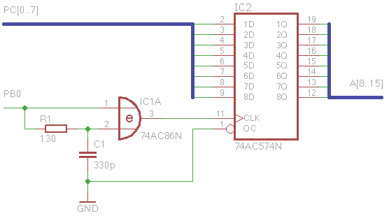

I have come up with the following additional hardware to get some more IO pins.
Upper Address Bits Latch
Then instead of setting the address with the following instructions
            out   abuslo,pcl        ;opcode fetch
            out   abushi,pch
I use
            out   abuslo,pch        ;opcode fetch
            out   PINB, one         ;toggle address latch clock
            out   abuslo,pcl
of course this requires an AVR processor that supports the toggle function when writing a 1 to a bit of one of the PINx registers. As I use a ATMega1284P, this is the case. This uses one additional cycle for all RAM accesses but on the same time the ATMega1284P supports a clock of 20MHz which more than compensates for the extra cycle. And your code is really squeezing the last cycle out of the emulation. So it is still very fast.
Regards
Peter

Peter,
nice idea! Maybe I will convert all loads to the address bus into a macro to allow an easier change of this function.
cheers, Klaus
