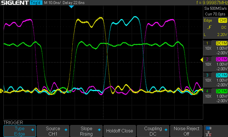

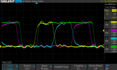

So I did connect it and here's what the signal looks like. The inputs yellow, cyan and purple taken from the left hand half-circle pins and the output green on the right hand full circle pin.

And just to be sure it isn't the 5V VHC chips managing to hold the 3.3V LVC OR gate high rather than having little downwards spikes here is the same with everything running at 3.3V.
Still surprisingly flat.

Hm! Very nice to see.
I'm guessing you noticed the propagation delay of the OR logic? It's shifted by some nanoseconds. Perhaps because of that, the input signals change faster than it can propagate, thus it remains high. Interesting.
This would of course assume signals that would hit the OR gate at the same time, thus allowing for that to work like that. Still, good to know and good to see. Thank you!
I had a bit of learning moment thinking about this.
Full disclosure, I haven't been doing hardware stuff for very long and I really dislike analogue signals.
What I think is happening here is that the transistors in chip can be viewed as little amplifiers. For LVC (being TTL 3.3V) anything above 2.0V is going to swing to a logic high within the data sheets specs and the same for anything below 0.8V swinging to a low. But the zone in between is not undefined it's just out of spec for the given propagation times. An input signal is still going to cause the transistor to swing high or low. But slowly (where slow is very relative with LVC).
I assume manufacturers are going to tune - is that even the word? - their ICs to amplify up or down around some given voltage. Digging through Nexperia's datasheets didn't turn up anything but looking at the datasheet for Texas Instruments' SN74LVC245 it looks like the threshold voltage is 1.5V for a VCC of 3.3V. So anything above 1.5V is going register as high output for that OR gate. And in my example the OR gate was already driven high by the previous signal so the output doesn't need to swing at all to remain high. And even though the input dips are quite large none drop below 1.5V.
But also as you mentioned there is a propagation delay (about 2ns) before the OR gate starts responding at all and by the time it would start responding the next input is already within the spec'ed 2.0V.
I'm glad you asked this question because I built that circuit last year to test if I could use a counter, a decoder and some OR gates to generate PHI2, but never really thought about why it worked.
 Post subject: Re: Decoded PHI2
PostPosted: Thu Nov 17, 2022 5:58 pm
Indeed, sometimes it's useful to think of digital gates as very high gain analogue amplifiers.
And indeed, it's important to see specs as what they are: if you reach a certain voltage by a certain time, then you'll be OK. It doesn't say anything about whether or not you're OK in other circumstances.
Even if this circuit seems empirically glitch-free, I'd say it's a bit of a risky choice: different parts, different temperatures, different supply voltages, and it might glitch. We've particularly seen trouble with high speed devices, which can detect glitches which slower ones can't - and by detect glitches, I mean react to edges with misbehaviour.
It might be OK for hobby use, of course. But things which just about work most of the time are the hardest to debug, so watch out for that.
