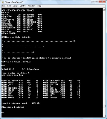

PostPosted: Fri Nov 11, 2022 2:08 am
Posts: 1120
Dietrich,
I have new development on porting CPM-65:
The BIOS has not changed, but I changed BDOS. This is because I didn't know what 'DD' directive associated with command table BEFTAB does in the original assembly, so I substitute '.dword' which was a mistake. BEFTAB is collection of jump tables invoked by push high jump address byte into stack then low jump address byte into stack then execute a rts. So 'DD' directive probably rearrange the table so high address is first and low address next so the BDOS routine will push the correct byte order into stack and execute rts. I separated the jump table into high address bytes table, BEFTABhi, and low address bytes table, BEFTABlo, and re-wrote the BDOS dispatcher. Attached it the original BDOS.ASM and modified BDOS assembled by CA65.
With the BDOS modification, I now have CPM-65 sign on, follow by A> prompt. If I enter a 'd' it responded with BDOS Error $DD because 'd.com' does not exist. OK, I'm making progress.
original_BDOS_and_modified-BDOS.zip [17.67 KiB]

PostPosted: Fri Nov 11, 2022 10:38 am
Joined: Wed Jan 01, 2003 6:32 pm
Posts: 34
Dietrich,
Hi Bill, glad to see you making real progress really fast.
Regarding 'DD', you got that right. My assembler knows 2 directives to place 16 bit values in code:
DW  L/H byte
DD  H/L byte
Thats sometimes handy, but you found a valid solution anyhow.
I quickly skimmed above your modified code - looks good. And definitely your system prompt indicates, that essential functions of the systems are there especially console input and disc read commands.
Dietrich

Thank you for your detailed reply. You've resolved most of my questions. I do know putting DIRBF, SCSIBUF, and DMA below CCP can be problematic but I have insufficient space above the original BIOS memory allocation to accommodate these big buffers. Now I have a better understanding, I'll relocate BDOS, CCP so to give BIOS more space.
I'm still confused about DIRMSK. In the original BIOS there are 32 sectors designated for directory, so that's 256 directory entries and value of DIRMSK is %10000000. I want to have 512 directory entries so that's 64 sectors for directory. What should the DIRMSK value be?
The question now is how to get CPM65 files into the CF disk. In CP/M-80 I would load the XMODEM binary in TPA, start CP/M and use CCP's 'Save' command to create XMODEM.COM and then use XMODEM to bring in rest of the files. 'Save' command is not in CPM65's CCP, but I can still load XMODEM binary in TPA, patch the CCP so when CPM65 starts up, it jumps to TPA to execute XMODEM binary. There is a 'cflag' for CPM65's CCP that may be used for this purpose?
But this morning I tried another method to load CPM65 files into the CF disk. What I did was modifying DOS/65 disk format to match CPM65 DPH and use DOS/65's XMODEM to copy CPM65 files to the CF disk. I also assembled d.asm using CA65 assembler and copy the resulting d.com to CF disk. The screen shot shows the results. First half of the screen shot shows DOS/65 booting up and display the content of drive A which are the CPM65 files I previously xmodem over. I used DOS/65's 'go' command to enter my monitor and load CPM65's BDOS, CCP, BIOS and start execution at BIOS's BOOT @ $e400. 2nd half of the screenshot shows CPM-65 boot up and I entered 'd' to invoke d.com which display the CPM65 files. Pretty cool, huh.
Still lots to work on but I think I have a good grasp of CPM65 now.
