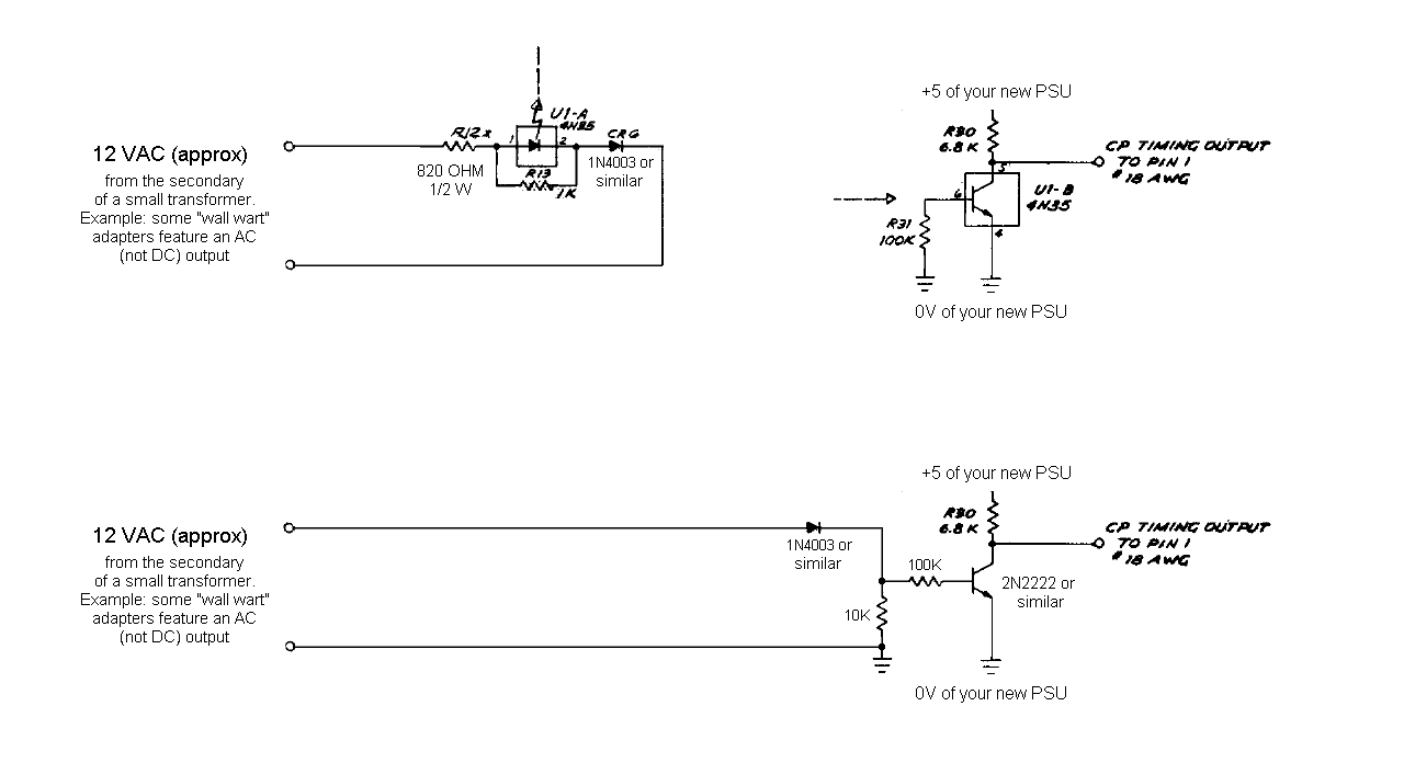

Posts: 3525
Re: Building +5v 60kHz PWM with a TL494 ic
vmarcus wrote:
Trying keep the solution, as simple as possible. +5v in, and +5v PWM coming out.
I already have a Mean Well PT-65B power supply, which addresses the GND, GND, -12V, +12V, & +5v requirements.
All I wanted was to replicate the 60Hz signal that feeds into the Pin #1 of the power connector.
[...] But I'm thinking since this signal has to so precise, I'll likely need to resort to a crystal oscillator and divide the frequency down to 60Hz.
The oscillator/divider would be a worthy project, and would help develop your skills. But if you feel there's already enough on your plate then you could consider the following approaches, which are much simpler but are a bit clunky to use, as they require a separate AC adapter aka "wall wart" in addition to your Mean Well power supply. NB- many wall warts deliver DC output; you need to locate one that has AC output. Thrift stores are a good source of assorted wall warts. Any output voltage from about 3 VAC to 30 VAC is acceptable.

GaBuZoMeu

vmarcus wrote:
Yes, this is for the video syncing and the for the Jiffy clock.
This is more important than you might think: if the clock isn't synchronized to the AC main you will have video issues for sure.
That is why I recommend Jeff's suggestion using a wall wart AC adapter is save and easy.
good luck!
