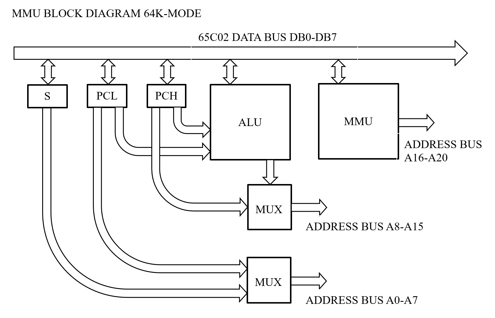

Re: WDC/Rockwell 65C02 core with MMU
Ah, so it is a stack in the MMU... I think it would help a lot to have some kind of block diagram of the MMU.
kakemoms
Posts: 349
Joined: 02 Mar 2016
Post by kakemoms »
In 64K-mode the block diagram should look something like this:
In 4K-mode, the MMU simply takes over more of the address bus (A12-A19).
Hrrm, the MMU is still a black box there. What would help me is seeing what the internal state is, what internal computations are being done, if any. For example, it wasn't clear that there's an internal stack for long subroutine calls.

I second Ed. More internal view would be great.
How is the MMU internal jbank stack affected when the user manipulates the normal CPU stack or just the stack pointer? Is there an internal stack pointer on the jbsnk stack that can be manipulated?
I’m afraid thats the best I can do. My drawing skills are limited.
There is a flag (BANK_REG_MEM) that exposes the JBANK stack in the $0100-$01FF area and the internal registers from $0000 and upwards. E.g. you can read and write to it directly as you please.
