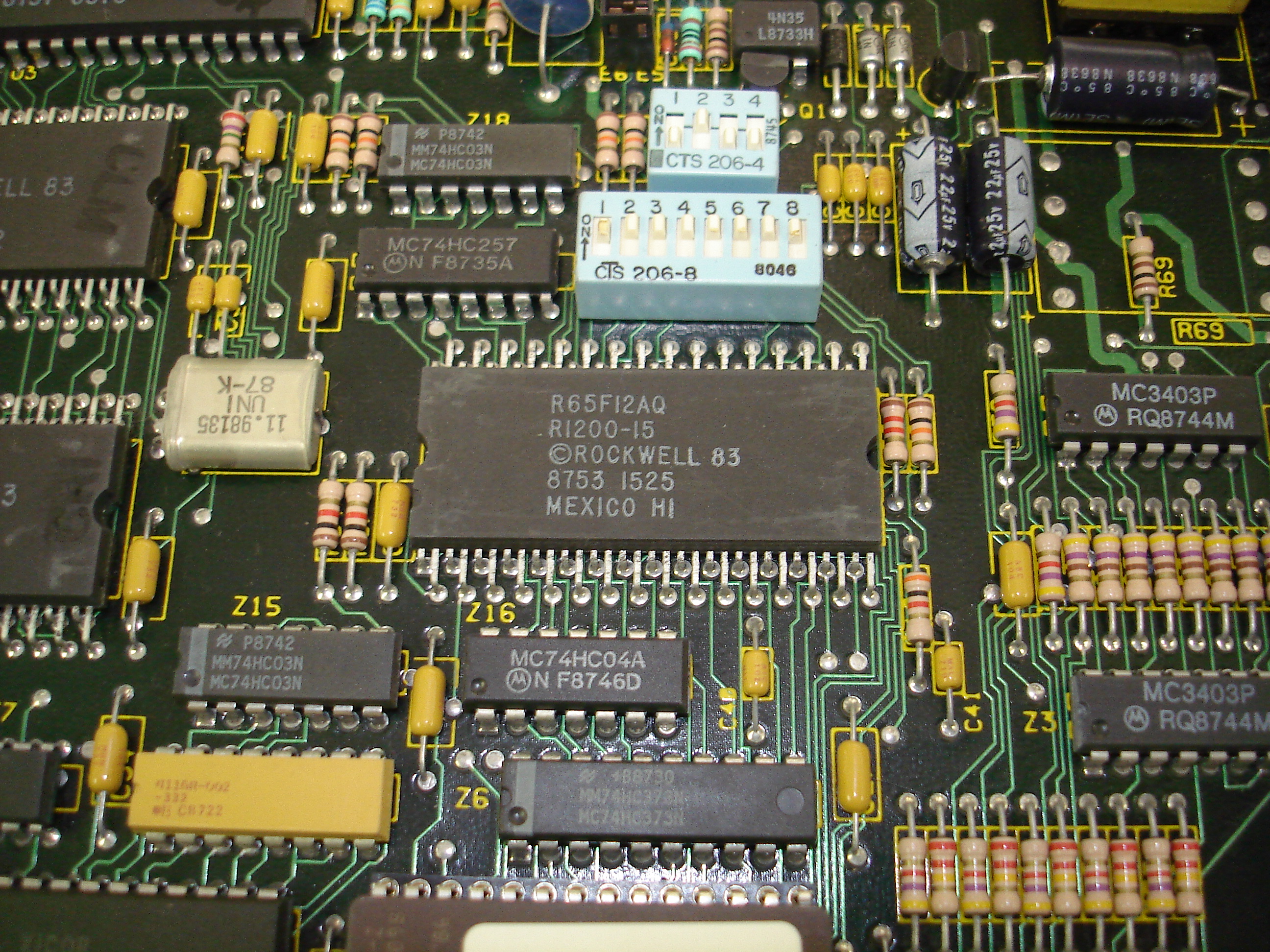

Writeup here: http://www.glitchwrks.com/2022/10/25/dec-scholar
I picked up two of these last year because the lot came with the power adapter, which most of these seem to be missing. It's a triple-voltage wall wart (pinout in the writeup). I was expecting just another 2400 BPS non-Hayes command set modem, but found this inside:
(image uploaded separately, apparently no IMG tags here?)
It's a Rockwell R65F12 FORTH chip! I dumped the ROM, TangentDelta is working on deconstructing it (he's getting the second modem). The ROM dump is linked in the writeup, too.
So, yeah, it's a non-Hayes 2400 BPS modem, but it's neat to see a mass market product from a large manufacturer that includes a Rockwell FORTH chip!
File comment: Rockwell R65FR12 FORTH chip

TangentDelta has been working on disassembling the ROM, and it's looking like mostly 6502 machine code. He says a lot of the code doesn't make a ton of sense from an optimization point of view, and looks like it may be output from a higher level compiler. We're thinking maybe their RM65 FORTH development system, which according to some of the FORTH chip datasheets will output machine code.

Later Rockwell modems used a chipset with one of the chips being a 6502 based microcontroller, this started with the R65C19, which was similar to the R65F12 but with an added host port that could emulate a 16450 serial chip, and added Forth instructions. The last of the line was called the L28 and could run at up to 35 MHz. So a lot of old Rockwell modem cards have a very nice 6502 based micro-controller on them. These microcontrollers also have a hardware bank switching system which allows access to up to 512k of RAM. A lot of the modems had 128k ROM and 128k RAM. I haven't found any documentation on the software side, but since they went to the effort to add special instructions for Forth it would be logical to think that they did use Forth in the modem firmware.
