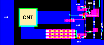

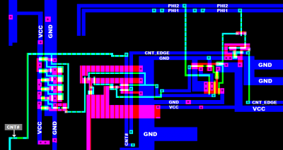

5e) CNT pad
CNT pad is the clock input/putput pad for the serial port (shift register),
also it can be used to enable timer A or timer B counting.
CRA6 control register A Bit configurates the serial port to either work
as an input (CRA6 = 0) or as an output (CRA6 = 1).
In input mode, the serial shift clock has to be generated outside the chip, and sent into the CNT pad.
In output mode, the serial shift clock is generated inside the chip, and comes out of the CNT pad.
In output mode, CNT has an "open collector output".
The output circuitry related to the CNT pad isn't much different from what we had at the SP pad.
Note, that there is a pullup resistor (FET) on the chip which ties the CNT pad to VCC.
At the input side,
the high_active signal from the CNT pad goes through an inverting Schmitt trigger,
an inverter, an inverting super buffer, and becomes the low_active CNT# signal.
CNT# then goes into "12) CNT edge detector", which technically senses a rising edge on the CNT pad,
and generates the high_active CNT_EDGE signal if this was the case.
CNT_EDGE goes into "11b) serial port control", where it is used for generating the clock signal
for "11a) shift register plus latch".
CNT_EDGE also goes into "8c) timer A LO carry input generation".
CNT_EDGE and CNT# also go into "9c) timer B LO carry input generation".
At the output side,
the low_active serial output clock signal SP_TCK# goes together with CRA6 into a NAND gate.
The output of the NAND gate goes into an inverting super buffer,
which controlls the driver FETs switching the CNT pad to GND.
When CRA6 = 1 (serial port in output mode), and SP_TCK# is HIGH (inactive),
the CNT pad is switched to GND.
The SP_TCK# signal is generated in "11b) serial port control".

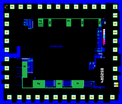

The address decoder is built with NOR gates (plus a few inverters),
it breaks down into individual blocks (for the different registers),
and said blocks are spread all over the chip.

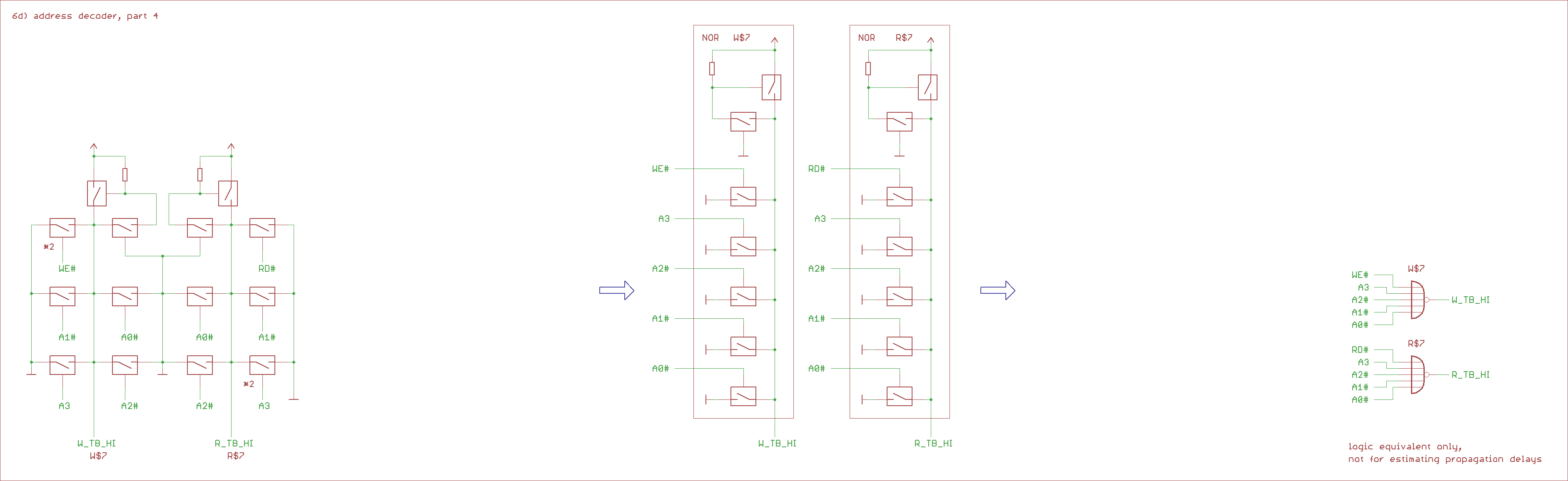

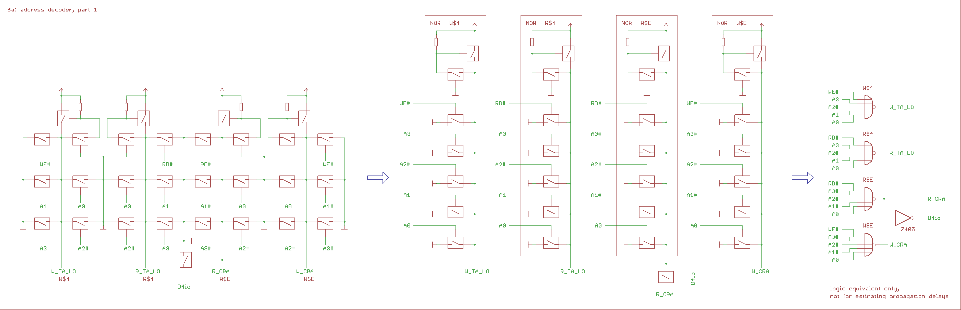

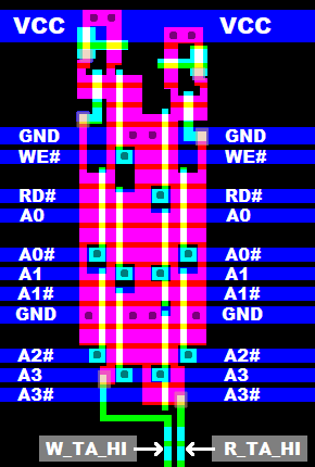

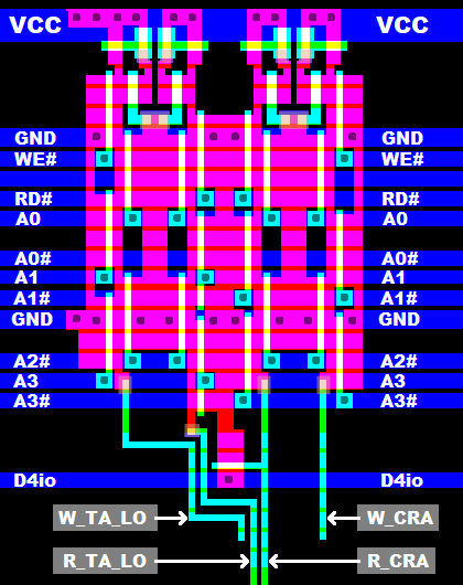

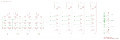

In the North half of the chip (6a..6e),
the address decoder blocks generate the read/write register control signals
for timer A, timer B, CRA, CRB, ICR.
Every single control signal is generated by a 5 input NOR gate.
Note the FET which pulls D4io to GND when R_CRA goes active for reading CRA.

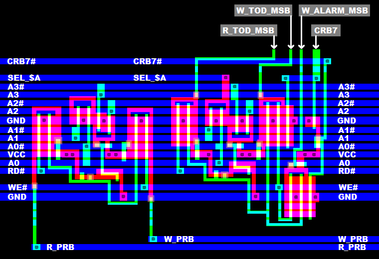

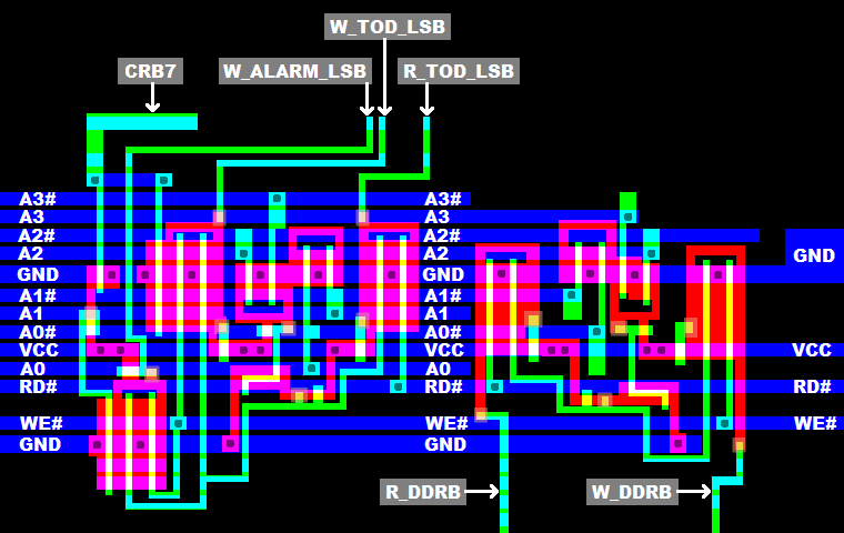

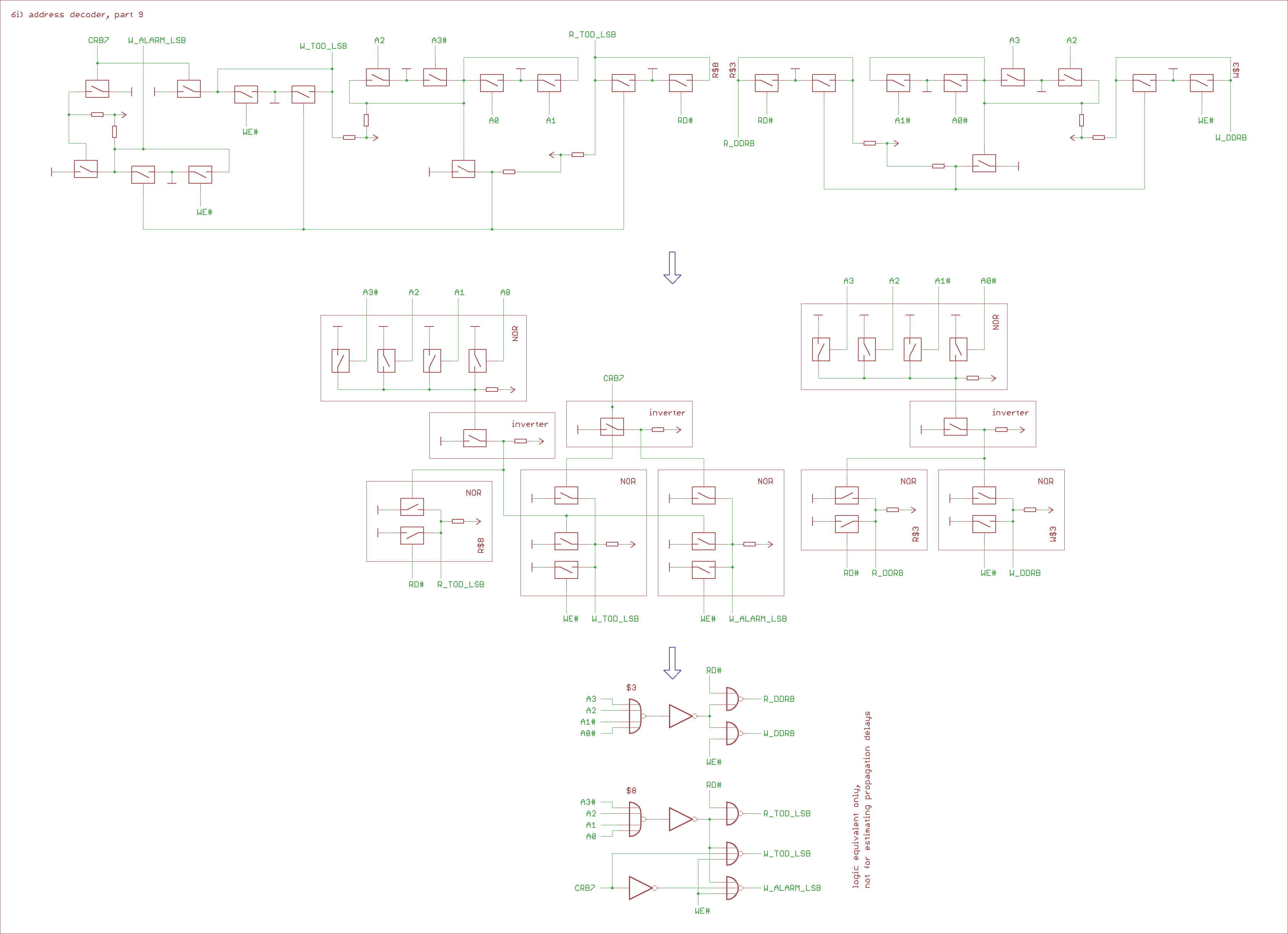

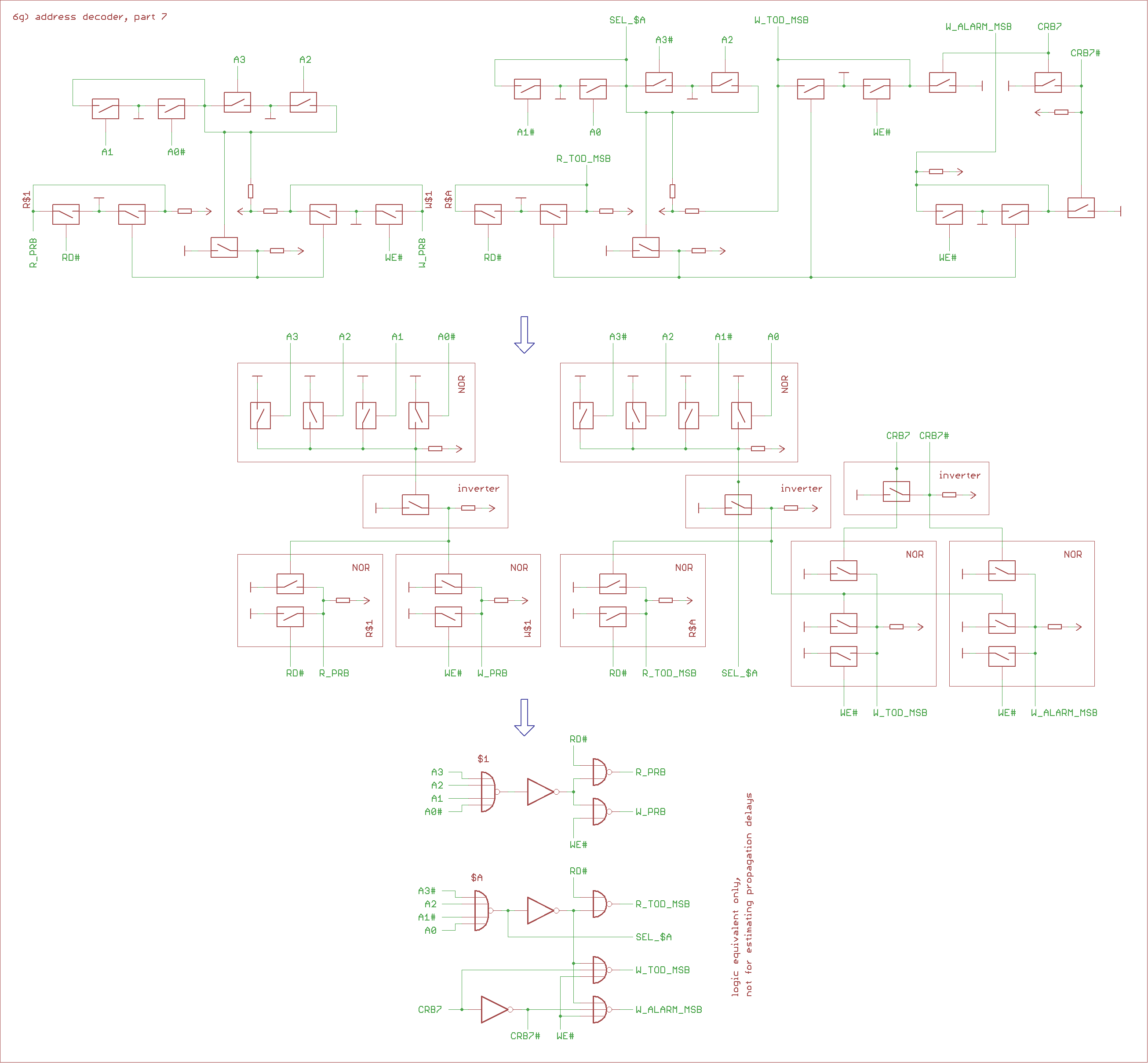

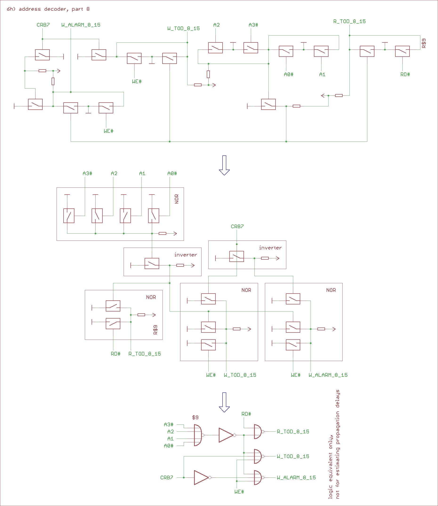

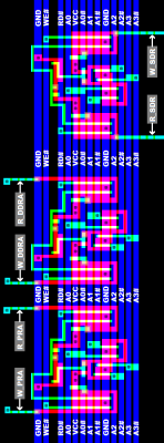

In the South half of the chip (6f..6i),
for the parallel I\O ports, the serial port (shift register),
the TOD counter registers, and the ALARM registers.
In every block, we have a 4 input NOR gate decoding the address,
which feeds an inverter.
The inverter output goes into two NOR gates
(one generating a read control signal, the other generating a write control signal),
for the TOD counter and the ALARM register it's a bit more circuitry because of CRB7.

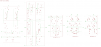

TTL equivalent of the whole address decoder:
Now for the individual parts that make up the address decoder:

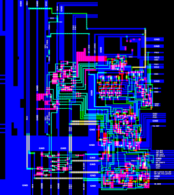

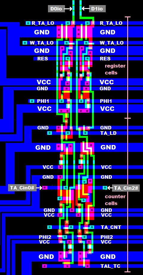

8a) timer A LO //Bit 0..7
Timer A LO is a block of 8 cells, one Bit per cell, it's the timer A low Byte.
North half of the cells are the timer A registers,
which are written by the CPU.
Registers are half_statich latches, and they are
written by high_active control signal W_TA_LO at PHI2,
refreshed at PHI1, and cleared with RES at PHI1.
The basic concept isn't different from what we had
in the CRA\CRB control registers.
Also, the CPU can read the contents of the counter cells
with the high_active control signal R_TA_LO.
South half of the cells are the timer A counter Bits,
and it's a down counter.
The CPU only can write the registers,
the registers are transferred into the counter cells
by the high_active control signal TA_LD which changes at PHI1,
it is generated in "8e) timer control logic".
Counter cells use an inverting/non inverting ripple carry,
the low_active carry input of the LSB is at the West side of the 8 Bit block.
Also, the counter cells store the Bits in non_inverted/inverted form.
The result for the next counting step is latched at PHI2,
and transferred into the counter Bits with high_active control signal TA_CNT
at PHI1.
TAL_TC basically is a NOR gate, which checks for 8 Bit counter underflow.
It changes at PHI2, and it becomes HIGH when the 8 Bit counter is $00
with "the count enabled".
//For "count enabled", see "8c) timer A LO input carry generation.
Two timer A LO cells look like this:

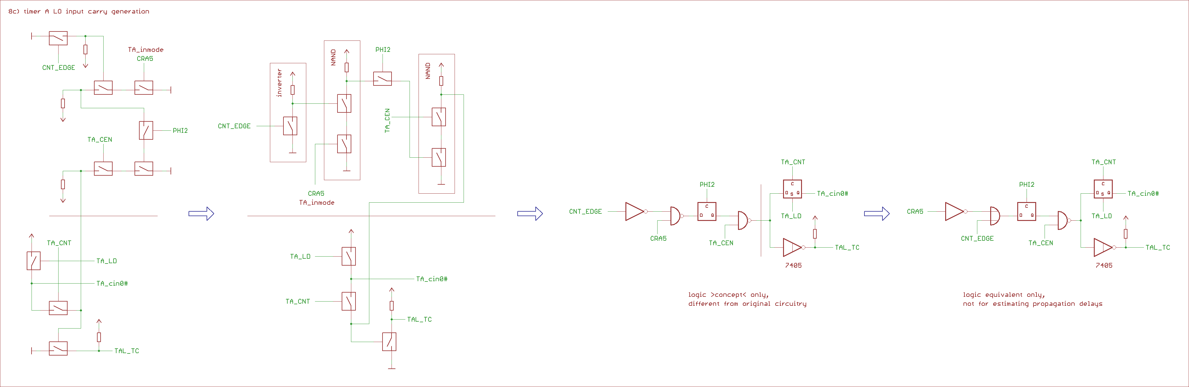

It generates the low_active input carry for the timer A LO Bit 0,
means it enables/disables timer A down counting.

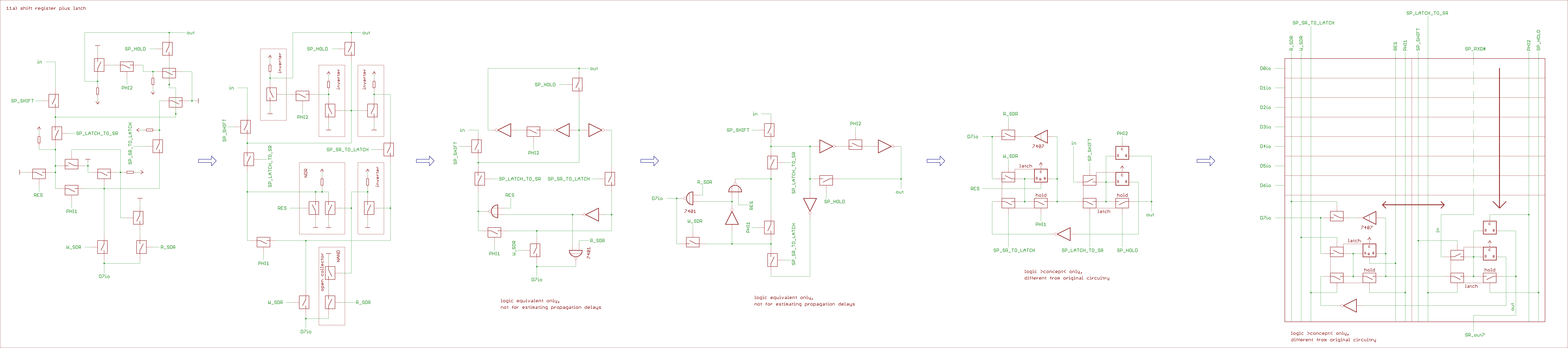

In the silicon, it is located West from timer A LO.
The high_active signal CNT_EDGE is generated in "12) CNT edge detector",
it is active for one PHI2 cycle after there was a rising edge on the CNT pad.
When CRA5 = 0, counting always would be enabled, and timer A LO decrements at PHI2 speed.
When CRA5 = 1, counting would be enabled for one step after there was a rising edge on the CNT pad.
An inverter plus a NAND gate check if that is the case.
The output of the NAND gate is sampled by a transparent latch at PHI2.
The output of the transparent latch goes into a NAND gate,
together with the high_active control signal TA_CEN
which is generated in "8a) timer control logic" from CRA0.
//CRA0 in control register A enables/disables timer A counting in general.
If the output of that NAND gate is low (active),
the NOR gate TAL_TC is enabled for sensing timer A LO underflow.
Also, for counting one step the low_active carry input of the timer A LO Bit 0
goes active... when the high_active control signal TA_LD does not load the
timer A counter from the timer A registers.
//Note, that TA_LD changes at PHI1.

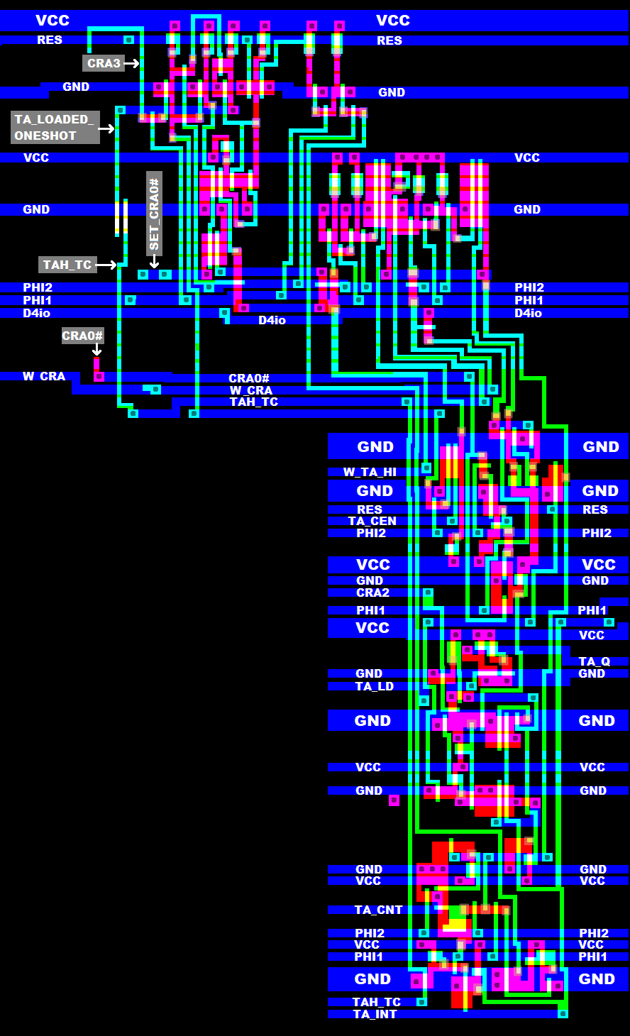

8e) timer A control logic
It's quite big, and in the silicon it's located East of timer A HI
and East of the CRA0 control register A register Bit.
It controls the timer A counter cells (by signals TA_CNT, TA_LD, TA_CEN),
it generates the timer a underflow interrupt signal (signal TA_INT),
it generates the pulse\toggle output signal TA_Q which goes to the PB6 pad driver,
and it sets/clears CRA0 when timer A is in one shot mode.
About controlling the timer A counter cells:
High_active control signal TA_CEN enables timer A counting in
"8c) timer A LO input carry generation".
TA_CEN is the output of a latch which samples CRA0 at PHI2.
//At PHI2 in the cycle after the CRA register write cycle.
High_active control signal TA_CNT loads the timer A counter cells
with the result of the next counting step at PHI1.
It is active by default at PHI1 when TA_LD is not active at PHI1.
High_active control signal TA_LD transfers the contents
of the timer A registers into the timer A counter cells,
it changes at PHI1.
There are four conditions which enable TA_LD:
RES is active.
There is a timer A underflow with counting enabled.
Load is forced for one PHI2 cycle after writing 1 to CRA4
(by high_active CRA write control signal W_CRA).
When timer A was set to continous mode (at least) in the previous cycle,
and when timer A counting was disabled by TA_CEN = LOW,
in the PHI2 cycle after a TA_HI register write.
About TA_Q and timer A underflow interrupt:
High_active signal TAH_TC indicates a timer A underflow when counting is enabled.
TAH_TC is sampled by a transparent latch at PHI1.
The output of the latch gives us the high_active signal TA_INT,
which will set the timer A interrupt flag.
When CRA2 = 0, TA_Q is the inverted TA_INT signal.
TA_Q then changes at PHI1 and goes LOW for one PHI2 cycle.
When CRA2 = 1, TA_Q comes out of what basically is a one Bit counter
built from two AND\NOR gates and two transparent latches.
The counter advances at PHI1 when TA_INT is active.
The counter output which goes into TA_Q is forced to LOW at PHI1
by a rising edge detector in the PHI2 cycle after CRA0 changes from 0 to 1.
Also, the counter output which goes into TA_Q asynchronously is forced
to HIGH when RES is active.
About timer A control logic setting/clearing CRA0:
If CRA3 = 0, timer A is in continous mode.
If CRA3 = 1, timer A is in one shot mode.
Short form:
If TA_HI is written when timer A is in one shot mode CRA0 is set.
If there is a timer A underflow while timer A is in one shot mode, CRA0 is cleared.
Now for the longer version:
If timer A was set to one shot mode (for at least) in the previous PHI2 cycle,
and if the TA_HI register is written, low_active signal SET_CRA0# sets CRA0 at PHI2
for starting timer A.
If the timer A counter cells were loaded with TA_LD in the previous PHI2 cycle,
and CRA0 is not set by SET_CRA0# (both things are checked by a RS flipflop),
if timer A was set to one shot mode (for at least) in the previous PHI2 cycle,
the high_active signal TA_LOADED_ONESHOT goes active.
Signal TA_LOADED_ONESHOT and high_active signal TAH_TC (which indicates
a timer A underflow with counting enabled go into "7a) CRA0".
If both signals are active, this clears CRA0 at PHI1.
Note, that the PHI1 controlled latch in the timer A control circuitry
which samples CRA3 at PHI1 is redundant, because CRA3 already
is sampled by a transparent latch at PHI1 in the CRA3 register Bit.
//So maybe timer A control circuitry and the CRA register Bits were done by different designers,
//or by one and the same designer who had to do too much different things in between.

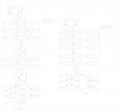

Now for a bigger picture showing the simplified schematic
of timer A, plus timer B, plus the related control logic:

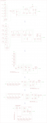

10b) ICR7
When the CPU writes ICR with high_active register write control signal W_ICR active,
D7io is sampled in a transparent latch.
In the PHI2 cycle that follows the write cycle,
the output of said latch is used to either clear or set interrupt enable flipflops
(for interrupt enable flipflops where D0io..D4io was HIGH during the write).
If the output of the latch is 0, high_active signal IER_R (SET) goes active at PHI1 for one PHI2 cycle.
If the output of the latch is 1, high_active signal IER_S (CLEAR) goes active at PHI1 for one PHI2 cycle.
Both control signals go into "10a) ICR0..ICR3".
The "interrupt active" RS flipflop is set when the low_active signal INT_ACT# is active (LOW).
INT_ACT# is pulled LOW inside the ICR0..ICR4 cells when the interrupt flag flipflop
and the interrupt enable flipflop in at least one of these cells both are set.
The "interrupt active" RS flipflop is cleared asynchronously when RES is active,
or at PHI1 in the PHI2 cycle that follows an ICR read cycle.
The high_active output of the "interrupt active" RS flipflop goes through an inverter,
then goes as low_active IRQout# signal to the "3d) IRQ# pad driver".
If the flipflop is set, the IRQ# pad is pulled LOW.
Note, that for the IRQ# pad, flipflop CLEAR has a higher priority than flipflop SET.
The low_active output of the "interrupt active" RS flipflop can be read by the CPU
in inverted form by high_active register read control signal R_ICR into D7io.
Note, that for reading ICR7 from the CPU, flipflop SET has a higher priority than
flipflop CLEAR.
If your FPGA or TTL implementation of the 8520 somehow "forgets" active interrupts,
please check if you got the priority for any of the RS flipflop inputs to any of the RS flipflop outputs
messed up somewhere in "10) ICR".
Bit 5 and Bit 6 in the ICR are unused.
If ICR is read by high_active register read control signal R_ICR,
two FETs are pulling D5io and D6io to GND.
To make sure that the unused ICR Bits are read as '0'.

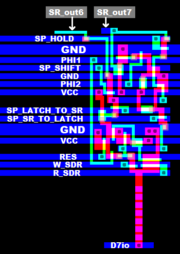

The only thing that 8522 and 8520 have in common is DIP40.
In the 6522, the CPU did read the shift register directly.
Means if a shift sequence is in progress,
the CPU is not supposed to read/write the shift register.
For the 8520, it's different:
In the 8520, there is a data latch between the shift register and the internal data bus.
There are 8 cells with identical layout, every cell contains a Bit of the data latch
and a Bit of the shift register itself.
This complicates the serial port control circuitry a little bit,
but on the bright side the CPU now has more time for reading received data.
The data latch is just another half_static latch, refreshed at PHI1.
The CPU can read the data latch with high_active register control signal R_SDR,
and write the data latch with high_active register control signal W_SDR.
High_active control signal SP_LATCH_TO_SR transfers the contents of the data latch
into the shift register at PHI1. //for transmitting serial data
High_active control signal SP_SR_TO_LATCH transfers the contents of the shift register
in inverter form into the data latch at PHI2. //for receiving serial data
In inverted form, because the serial data goes into the shift register LSB
in low_active form as SP_RXD# from "5d) SP", which reads the SP pad.
Maybe this was another of them odd tricks for saving some chip space...
//When the serial port is in "transmit mode", SP_RXD# is forced to active (LOW).
High_active control signal SP_HOLD goes active at PHI1 if the shift register does nothing,
just for refreshing the Bits in the shift register, because the shift register
is built from half_static latches too.
High_active control signal SP_SHIFT goes active at PHI1 when the shift register shifts
one Bit position to the left.
The outputs of all the shift register Bit cells change at PHI2.
The high_active MSB output SR_out7 of the shift register goes into "11b) serial port control",
into a half static latch which is loaded at PHI1 with SP_SHIFT and refreshed at PHI2.
//the ninth Bit of the shift register, you might say.
When the serial port is in "receive mode", said half_transparent latch is forced to LOW.
Basically, the output of that half_static latch is sampled by a dynamic latch,
which feeds an inverter which sends the low_active serial data signal SP_TXD#
to the "5d) SP" pad driver.
Technically, in "5d) SP pad driver SP_TXD# goes into a NAND gate with CRA6.
If CRA6 = 1, the serial port is in "transmit mode".
The "open collector" NAND then pulls the SP pad to GND.
Means that transmitted data on the SP pad is high_active again.
"Shift register plus data latch" control signals which are generated in "11b) serial port control":
SP_LATCH_TO_SR @PHI1: data latch > shift register
SP_SR_TO_LATCH @PHI2: shift register > data latch
SP_HOLD @PHI1: refresh shift register contents
SP_SHIFT @PHI1: shift one Bit position left
And that the control circuitry for the serial port
uses a ring counter with an edge detector attached
for checking if a serial transfer is completed.
In 'transmit' mode, the shift clock for the serial data transmission
is generated inside the chip, toggles with 16 Bit timer A underflows,
canges at PHI1, and comes out of the CNT pad.
In 'receive' mode, the shift clock for the serial data transmission
has to be generated from outside the chip, and fed into the CNT pad.
CRA6 control register A Bit selects the mode for the serial port:
0 = shift in //receive, RX
1= shift out //transmit, TX
First, we have an edge detector scanning for a rising/falling edge at CRA6.
If CRA6 changes, the serial port control logic is reset for one PHI2 cycle.
Means, that switching the serial port mode from 'receive' to 'transmit',
or from 'transmit' to 'receive', serial port control logic is initialized again
in the whole PHI2 cycle that follows the CRA register write cycle.
Also, an active RES signal resets the serial port control logic.
The high_active reset signal SP_RES (generated by CRA6 edge detector output OR RES)
affects the following of the serial port control logic:
'TX_initiate' RS flipflop is cleared,
'TX_active' RS flipflop is cleared,
Toggle counter which generates SP_TCK is set, //default: serial transmit clock is HIGH
Bit counter is cleared. //4 Bit ring counter counting the received/transmitted Bits
If the serial port data latch was written in the previous PHI2 cycle
with high_active register control signal W_SDR, and if CRA6 = 1 (transmit mode),
the 'TX_initiate' RS flipflop is set at PHI1.
Said RS flipflop (built from two NOR gates) has the purpose of transferring
the contents of the data latch by high_active control signal SP_LATCH_TO SR
into the shift register (at PHI1)...
when no active transmit shift sequence already is running.
The RS flipflop is cleared when the transfer is done.
When the transfer is done, this sets the 'TX_active' RS flipflop
(built from two NOR gates), which enables toggling of the serial port transmit clock.
Said flipflop is cleared with the high_active SP_INT signal
which indicates the end of a shift sequence...
when the 'TX_initiate' RS flipflop indicates that a new sequence is not needed.
A one Bit binary counter (forced to 1 by SP_RES) basically generates
the serial port transmit clock SP_TCK.
The counter flips in the PHI2 cycle after TA_INT was active
(after a 16 Bit timer A underflow, that is).
If no transmit sequence is running and SP_TCK is LOW,
the next TA_INT makes SP_TCK flip to HIGH again.
//Default for SP_TCK is HIGH.
Basically at the falling SP_TCK edge, the output of an edge detector
advances the Bit counter and makes the shift register shift with
high active control signal SP_SHIFT by one step (at PHI1).
If the shift register does not shift,
and if the data latch is not transferred into the shift register,
high_active control signal SP_HOLD refreshes the contents
of the shift register Bits (at PHI1).
The Bit counter (which counts the Bits in a shift sequence)
is a 4 Bit ring counter, and it's quite difficult to spot the MSB
of the counter as such in the silicon.
The output of the rising edge detector which basically scans SP_TCK
goes into a RS flipflop, which generates two clock signals
(which change at PHI2 in the next PHI2 cycle) for the counter:
If there was a rising edge, the next counting step is prepared.
If there was no rising edge, the outputs of the counter Bit cells are changed.
A NOR gate (fed from a delay chain built from transparent PHI1\PHI2 latches)
makes sure that refresh for the half_static latches in the Bit counter
is not done before the counter cell Bit outputs are updated.
//Output of the NOR changes at PHI1.
//16 Bit timer A at 1MHz could give you baud rates down to 7.629... Hz,
//so mere dynamic latches won't do for building the ring counter.
The 4 outputs of the ring counter go into a NOR gate plus an edge detector.
After the ring counter has reached the value $0, SP_INT goes active
for one PHI2 cycle (at PHI1), indicating the end of a shift sequence.
SP_INT goes into "10a) ICR". //interrupt control register
High_active signal CNT_EDGE is generated in "12) CNT edge detector".
It is active for one PHI2 cycle after a rising edge on the CNT pad was detected.
It changes at PHI1.
In 'receive mode', it is used for advancing the Bit counter and the shift register.
//At the rising edge of CNT.
There is no difference between 'transmit' and 'receive' mode when it comes to
how the ring counter works and how the SP_INT signal is generated.
Anyhow, in 'receive' mode SP_INT triggers the high_active control signal
SP_SR_TO_LATCH, which transfers the contents of the shift register
into the data latch (at PHI2).

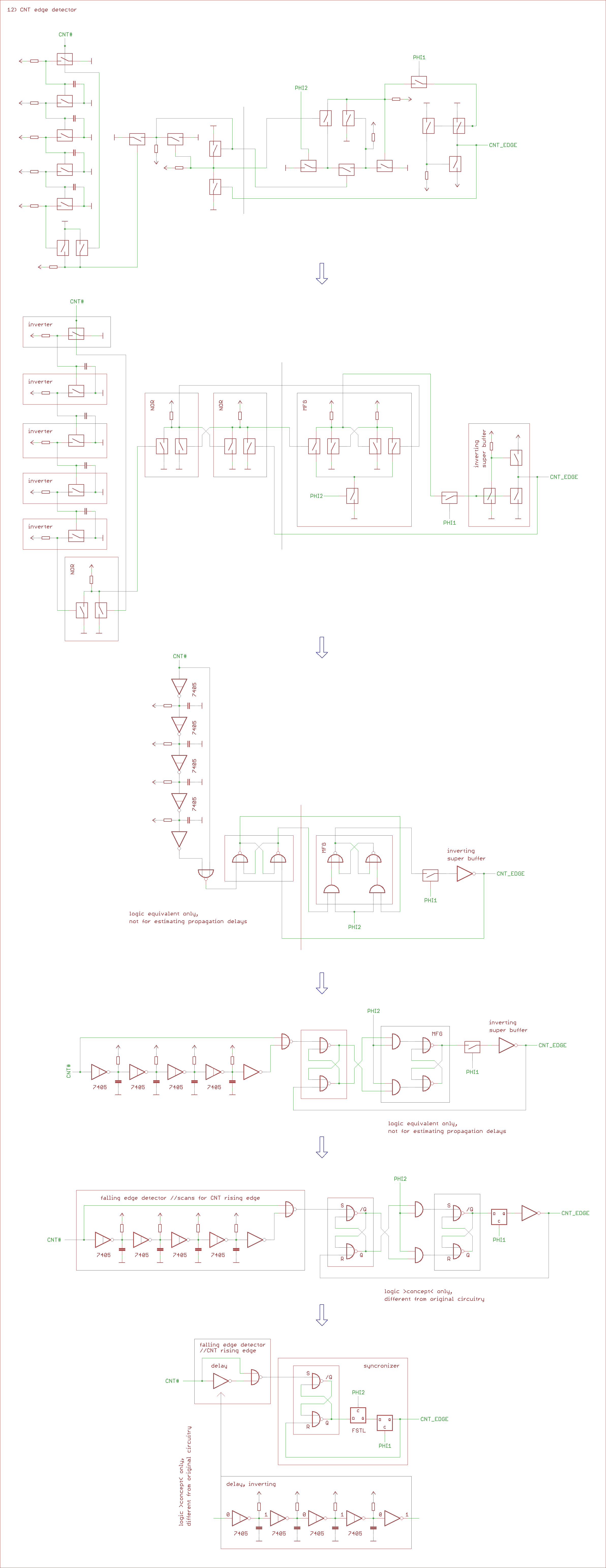

If there was a rising edge on the CNT pad,
it sets the high active signal CNT_EDGE to active in the next PHI2 cycle.
CNT_EDGE changes at PHI1.
The game is similar to what we already have seen in the "5a) FLAG#" and "5b) TOD pad" edge detectors.
The low_active CNT# signal comes from "5e) CNT pad buffer\driver",
basically it's the signal from the CNT pad inverted by a Schmitt trigger.
So technically, the CNT edge detector (which is a falling edge detector)
scans the CNT pad for a rising edge.
CNT# directly goes into a NOR gate, together with the inverted/delayed CNT# signal
Inversion/delay is done by four "open collector" inverters (with pullup resistors
to VCC and capacitors to GND at their outputs) plus one normal inverter.
If there is a falling edge on the CNT# signal, the NOR gate emits a pulse
which sets the first RS flipflop. (The width of the pulse is set by the delay).
The first RS flipflop (built from two NOR gates) is cleared again,
if the high_active CNT_EDGE signal is active.
A multifunction gate contains the second RS flipflop,
which is gated at PHI2 for sampling the contents of the first RS flipflop.
The (inverted) output of the second RS flipflop is sampled by a transparent latch at PHI1.
The output of the latch goes through an inverter and becomes the CNT_EDGE signal,
which now nicely is synchronized with the system clock.
It is active for one PHI2 cycle after there was a rising edge on the CNT pad.
CNT_EDGE goes into:
"8c) timer A input carry generation",
"9c) timer B input carry generation",

14a) two TOD counter cells
In the 8521\6526, we have TOD (time of day), and it's a BCD up counter.
In the 8520 datasheet, it's actually called EVENT instead of TOD,
and it's a 24 Bit binary up counter.
But since TOD and EVENT are in the same address range,
and it might be possible to re_use some of my 8520 dissection schematics
in the upcoming 8521 dissection (which is next),
I decided to deliberately stick with TOD for 8520 and 8521.
My end result for the 8520 TOD section looks like this:

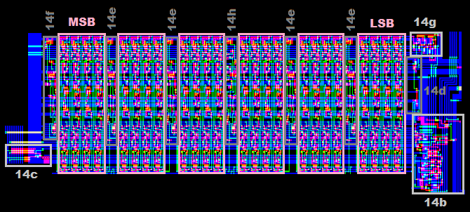

First a simple overview of what we are dealing with in the silicon:
The six big pink boxes are 4 Bit binary up counters,
MSB is west, LSB is east.
The dark grey boxes (14d,14e,14f) East and West of every pink box
are related to controlling the counter function of said pink box,
this includes the generation of the 4 Bit counter input carry.
The light grey boxes (14b,14c) are responsible for
disabling TOD increments when the CPU writes the TOD MSB counter register
(and for enabling TOD increments when the CPU writes the TOD LSB counter register),
for freezing the read data latches between TOD counters and internal data bus
when the CPU reads the TOD MSB read latch
(and for making the data read latches transparent again
when the CPU reads the TOD LSB read latch).
The light grey box labeled 14g basically is an edge detector
which generates an ALARM_INT pulse when the values
in the TOD counter registers and in the ALARM registers
are starting to match.

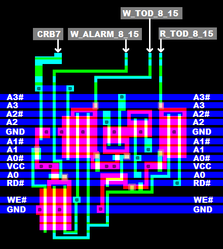

Next, we have the ALARM register Bits creatively crammed in.
Again we have half_static transparent latches, refreshed at PHI1,
written with high_active register write control signals
W_ALARM_MS, W_ALARM_8_16, W_ALARM_LSB which are generated in

ALARM registers use a similar concept like the CRA, CRB registers,
it's just that the transparent latches controlled by PHI1
in the outputs of the ALARM registers (for preventing spikes
when writing the register) are creatively crammed into
the comparator section.
Next, we have the TOD counter Bits.
Even Bits have low_active carry input, high_active carry output.
Odd Bits have high_active carry input, low_active carry output.
Carry input of a 4 Bit counter block changes with PHI20.
Count result is prepared at PHI1.
Counter outputs change when high_active clock signal TOD_CNT_20..23 is active (changes at PHI20).
Note, that every 4 Bit block has its own TOD_CNT_* signal.
Counter Bits are cleared with high_active control signal TOD_CLR_20..23 (changes at PHI20).
Note, that every 4 Bit block has its own TOD_CLR_* signal.
TOD_TC_20_23 is a 5 input NOR gate which checks if the 4 Bit counter
is in overflow condition ($F) while counting is enabled.
We now have reached the North of the TOD Bit cell,
and that's where the comparator sits.
Comparator basically uses XOR gates for comparing TOD counter register contents
with ALARM register contents, then pulls ALARM_EQ low if they don't match.
ALARM_EQ is a 24 input NOR gate, and its output goes into
"14g) TOD INT", where an edge detector generates the TOD_INT signal
when detecting a rising edge on ALARM_EQ,
for setting the ALARM interrupt flag.
