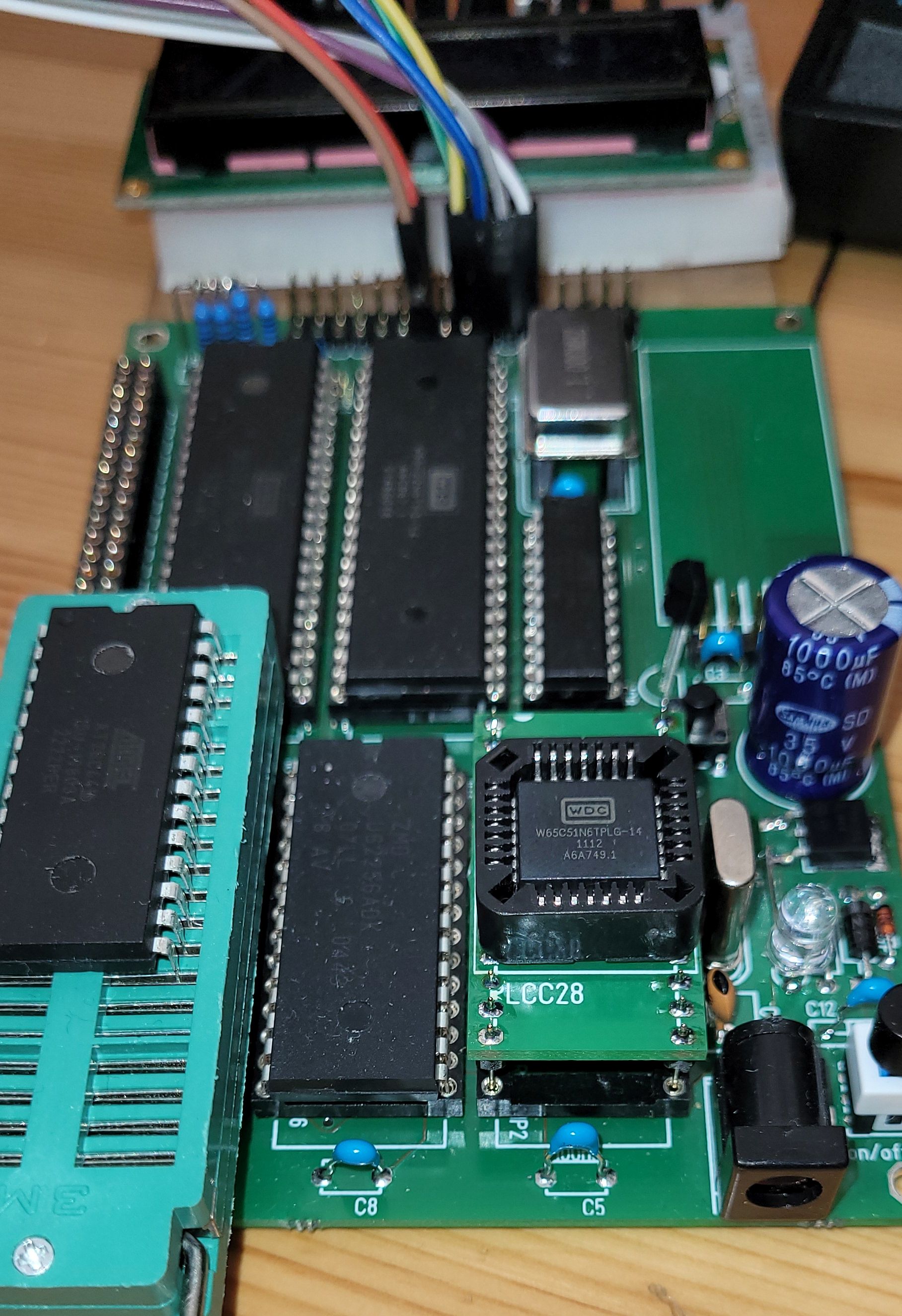

Adapter time,
PCB have come and seems to work.

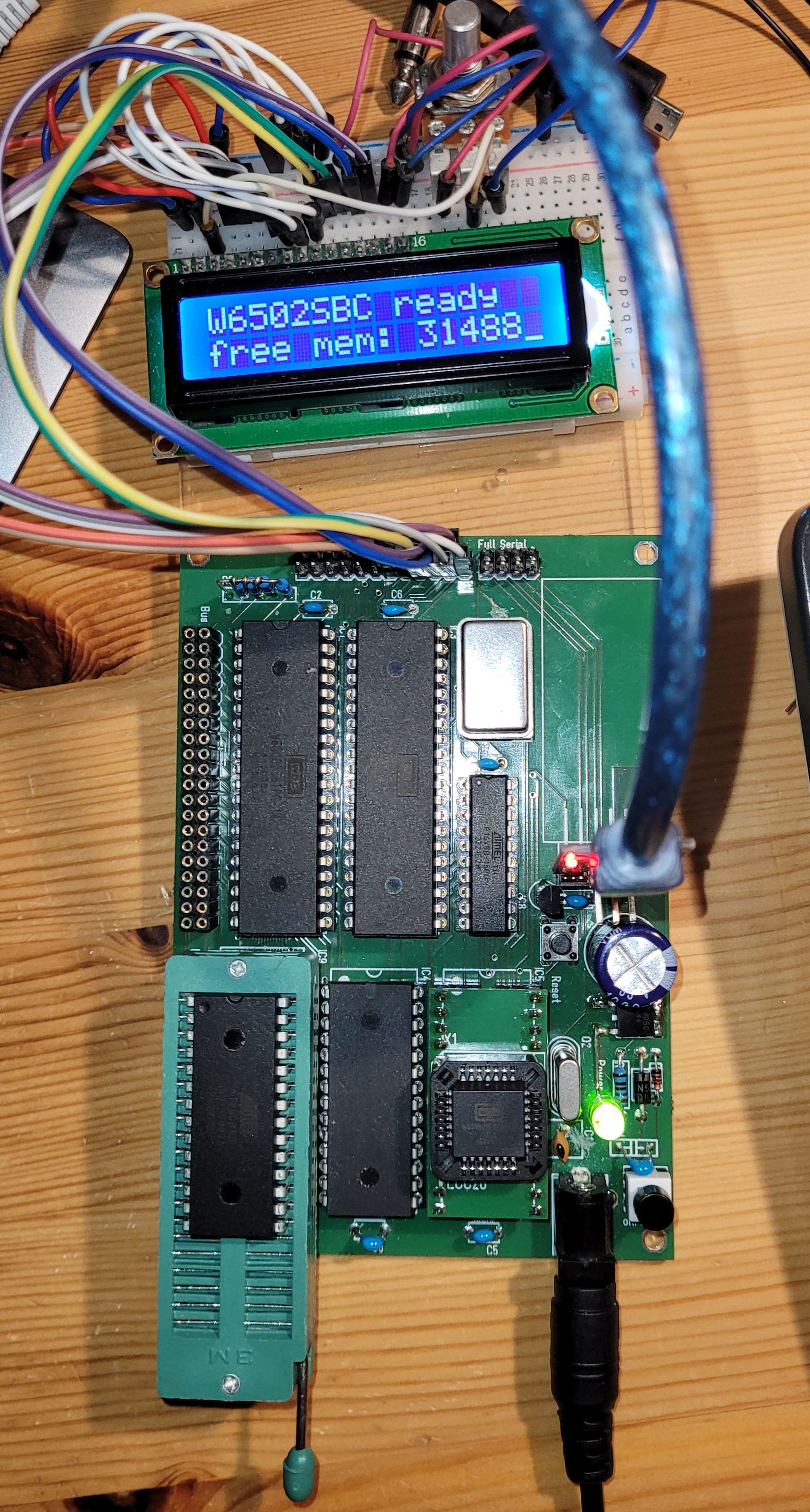

Next big step done:
implementing 6551 transmit/receive and a extended version of wozmon:
https://hackaday.io/project/186414-w650 ... 5c51-die-2
Mow the next evolution is coming, a simple basic...
