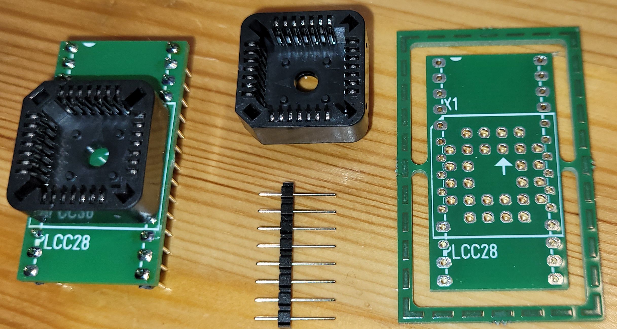

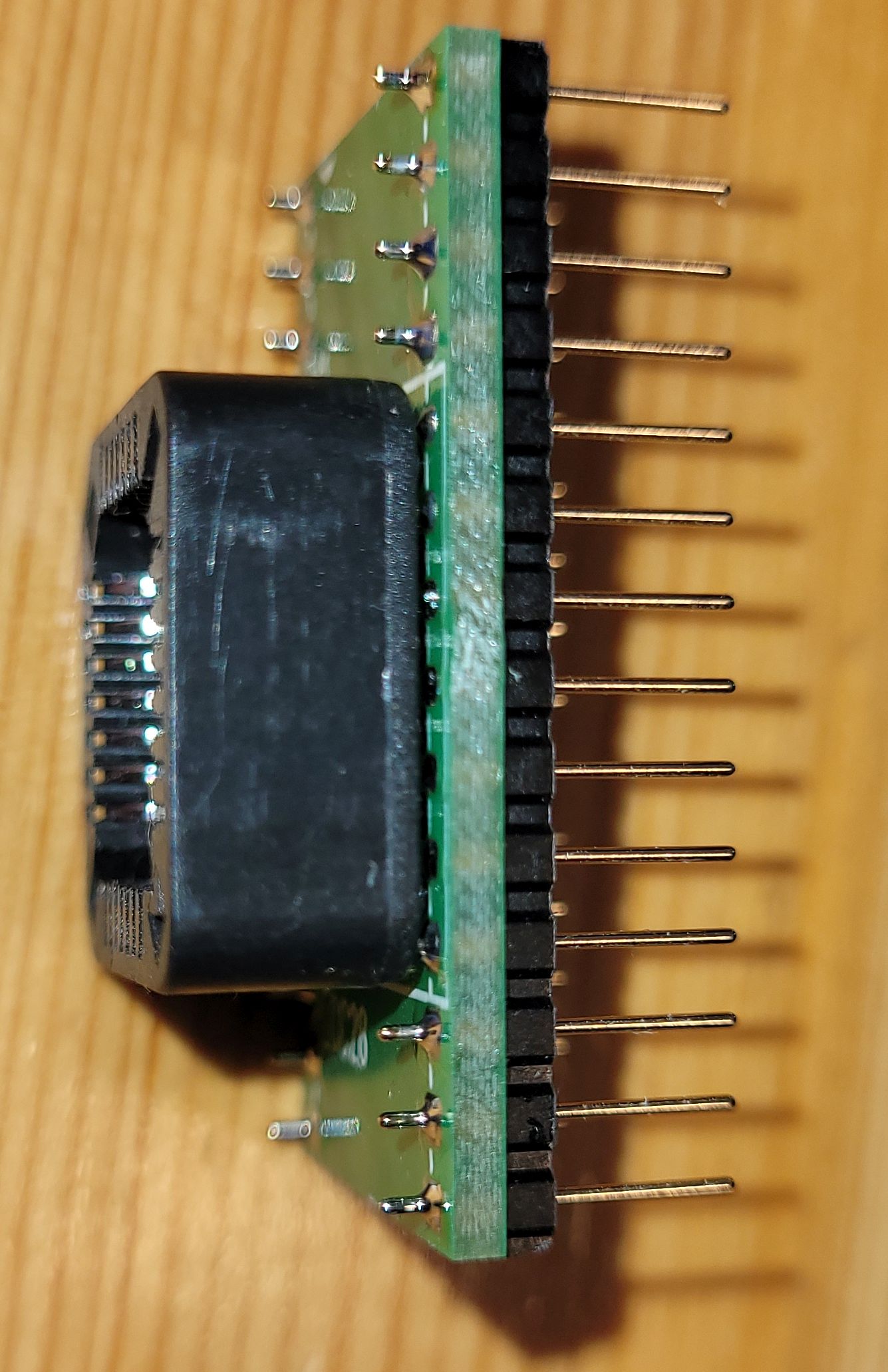

Adapter time,
PCB have come and seems to work.

Re: W6502SBC, a simple 6502 sbc
Nice! Can you give a link to those pins. Interplex NAS has some nice pins for this kind of application but I just looked into them for a work project and found that because they have so many combinations of options, they don't want to stock them or even start up the machines to make them until you order, and minimum order was tens of thousands of dollars, non-returnable and non-cancelable! We had to find a different way to do the job.
willie68
Posts: 54
Joined: 27 Jul 2022
Post by willie68 »
Sure, this are Pin strip RM 2.54mm, straight, 1-row, 36-pin with round contacts 0.5mm.
https://www.reichelt.de/stiftleiste-rm- ... tml?&nbc=1
Its my favorite distributor for my personal use.
