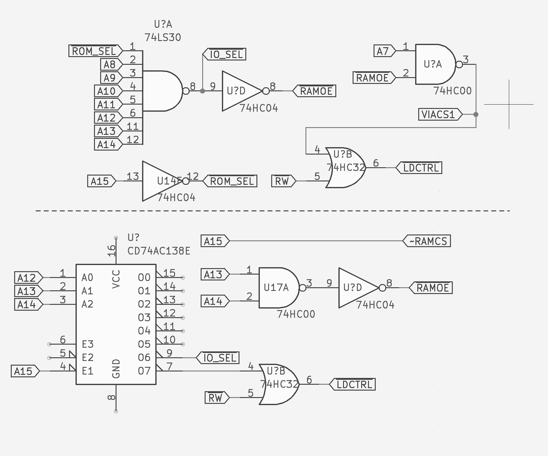

I'm not super happy with my result here as I don't actually manage to "save" a whole IC but only manage to gain two logic gates, some RAM address space and to make sure my output only register doesn't write on read.
Memory map:
$0000-5FFF: RAM (OE is activated with ~RAMOE)
$6000-7FFF: 6522 VIA (Selected with ~IO_SEL)
$7000-7FFF when ~RW low: Output only register - selected with ~LDCTRL (74xx273).
$8000-FFFF: ROM
Will this work as intended? Can I slim down the address space for the 6522 VIA even further with the '139(maybe by throwing one of my saved OR gates at it)? Or another single decoder?

~RAMOE will be active (low) for the ROM address range (A15 high) as well as for the RAM address range you quoted above. That may be OK so long as you're also gating the RAM's CS line with A15. Writes to the whole range of low addresses will then go to RAM. Note that writes also need to be gated with PHI2 at some point, so you never write data when PHI2 is low.
The setup of the bottom unit doesn't seem quite right though. As it stands, when A12 is high ($7000-$7FFF), or during a write operation (or when A15 is high, or either A13 or A14 is low), O1 will remain high, and so ~LDCTRL will be high and ~IO_SEL will be low. If A12 is low and it's a read operation, then ~LDCTRL will go low, and ~IO_SEL will go high. It feels unlikely that this is what you wanted as it looks like your write-only register will only be selected on reads, and it's not clear whether the VIA might be selected for too many addresses (~IO_SEL is exactly the inverse of ~LDCTRL so it'll be active for most of the address map). So a lot depends on what is being used to activate the VIA's other chip select input.
Ouch! Missed that ~RAMOE will also be active when A15 is high. I have WE gated though.
I have A0 and A1 swapped XD
Attached update - that should be more like what I intended, but cost another gate since I can't gate RAM CS with A15... Or "maybe" I can - I'm a bit fuzzy on that. I'll have to pass A15 through my tristate buffer as well and have a pulldown on it as well as the other lines.. I think..?
Hmm. You'd need the RAM's chip select active whenever phi2 is low (for the video side to read from it) and also when phi2 is high so long as A15 is also low. Then the RAM's ~WE is only low if RWB is low while phi2 is high.
To be clear, I think your first diagram still has this problem - the RAM will have its WE enabled whenever the CPU is writing to something, and writing to $8000 will cause writes to $0000.
In fact you probably want to delay WE bit beyond the start of phi2, because at the point phi2 goes high, you enable those transceivers and start giving the RAM a new address to be written to; you need a little time to let that settle before the RAM actually starts writing, otherwise it can corrupt other unrelated addresses. I think we discussed that a bit recently elsewhere!
Another point is that you ought to provide some definite signal to U11 pin 9 - it's an input pin on a CMOS IC, so even if you don't care what value it passes through, you need to pull it one way or the other. Connecting it to pin 8 or pin 10 would be an easy fix.
For the second diagram, ~IO_SEL is still the inverse of ~LDCTRL - so one or the other is always active. Writes to $7000-$7FFF will set ~LDCTRL low; and any other operation (any read, or a write to a different address range, including ROM) will set ~IO_SEL. So the way you've set the other 6522 pin becomes pretty important there.
Correct - that's not unintentional. I'm aware writing to $8000 will also write to RAM and I don't really mind the compromise.
RAM's OE is low when Ø1(B indicates "buffered" and is Ø0 inverted through an and gate) is low while ~RW is LOW. The two gates phi2 goes through before reaching ~WE is ok.
Also correct, sadly. If I run A15 through the '245 and put a pulldown resistor on the other side like A11-A14 for when it floats, I should be able to use it to disable the RAM when reading ROM/phi2 is low. And also ensure a defined state.
I'm afraid it's too slow though.
I guess it's time to dig through some address decoding examples as what I intended isn't as easy as it seemed.
