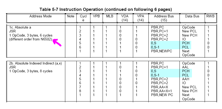

The 65816 works differently, if its datasheet is correct. It fetches the full target address before writing the old PC, so it should go to $1234.

PostPosted: Fri Sep 23, 2022 1:11 pm
Whoa, well spotted, John! And the datasheet seems adamant on this point, as there's a specific note included: "different order from N6502"
Also I notice the Absolute Indexed Indirect mode uses a different order once again, with the stack push cycles occurring consecutively and very early indeed.
