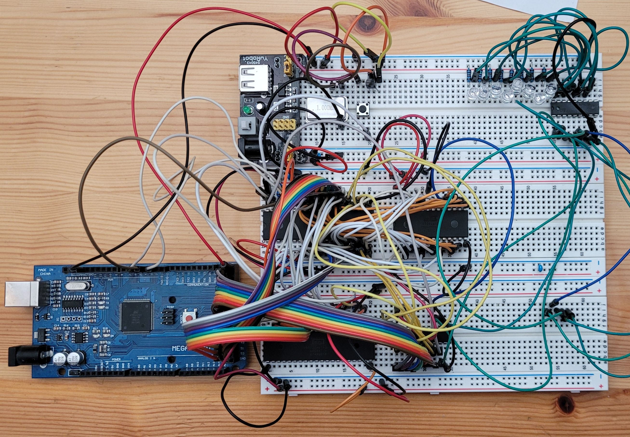

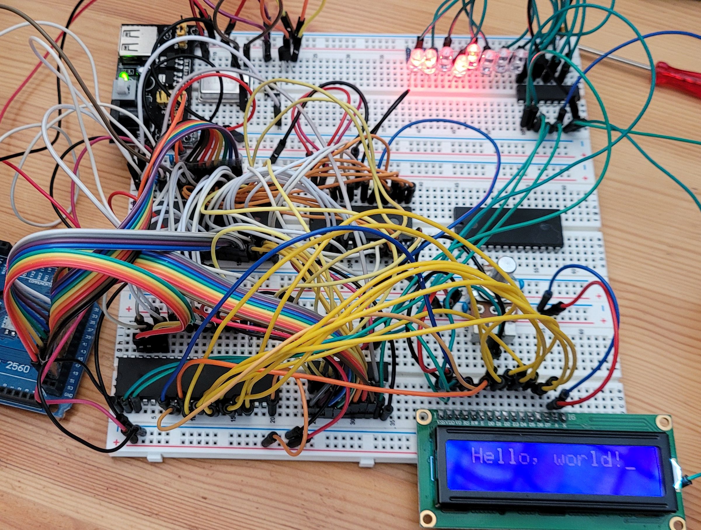

a short update, as the first breadboard build didn't work, i'll give it another try.
Removing all and starting again, with an Arduino Mega as a clock source and bus monitor.
Aun i think, i found the problem with the first build. A13 had no connection from the CPU to the breadboard bar. So I opened up the breadboard and used the pliers to squeeze the brackets together a bit. Now it's working. Next I need to put the RAM back in and repeat my initial tests with the 6522.

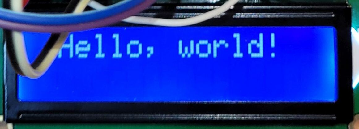

Today I wanted to breathe a little more life into the SBC. Actually, I wanted to install the RAM, but you wouldn't have seen anything there, except in the monitor. So I decided without further ado to connect the LC display. I didn't find the direct method so convincing, so I connected the display to the 6522. (I might do that later with 4 bits or I2C) I connected it to port B with full 8 bits and 3 lines to port A like Ben Eater did in his video. And indeed it is alive. A few small changes to his source because of the different addresses and the RetroAssembler and I could already see the Hello World on the display. Here's the proof:

Nice progress.
The direct attachment does work quite well though.
http://www.6502.org/mini-projects/optrexlcd/lcd.htm

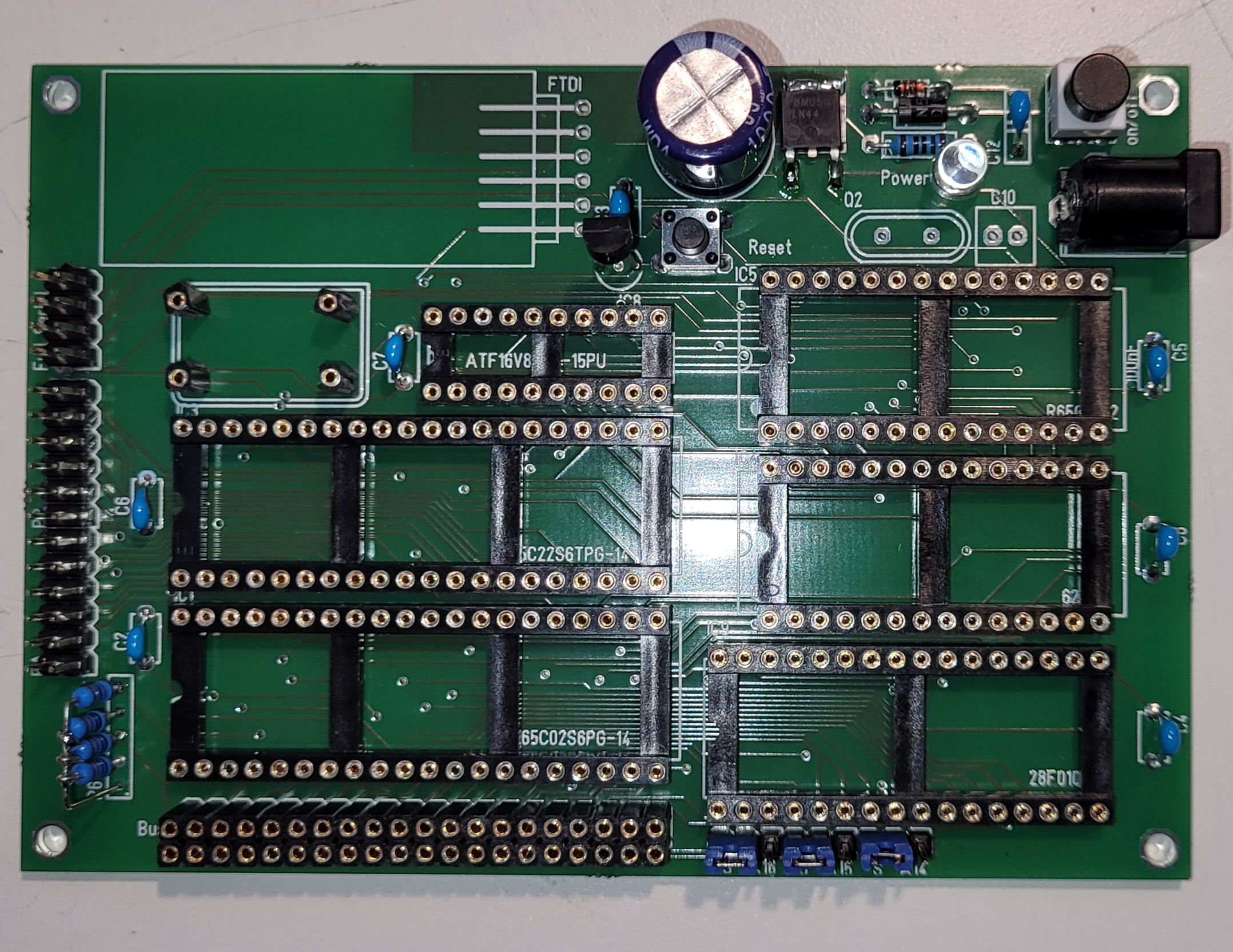

the first Proto PCBS have arrived...
found 2 bugs already...

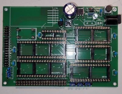

because I constantly have contact problems with the breadboard, I assembled the PCB and eliminated the 2 problems. Lo and behold, plugged in my monitor and the LCD and it's up and running.
Next point: ZIF socket with connector for the EEPROM.
Now the whole thing looks more like an SBC.
Hello, SBC! :)

Congrats on getting your PCB up and running! Always a nice feeling when your system works after spending all the time.
Now it's time to start writing code! Get a 6551 and USB-to-UART and direct attach to your PC using a terminal program.

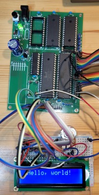

Here is the current progress, not much but for me ok:
- working LC-Display with 4-Bit interface
- Jiffy Clock (20ms)
