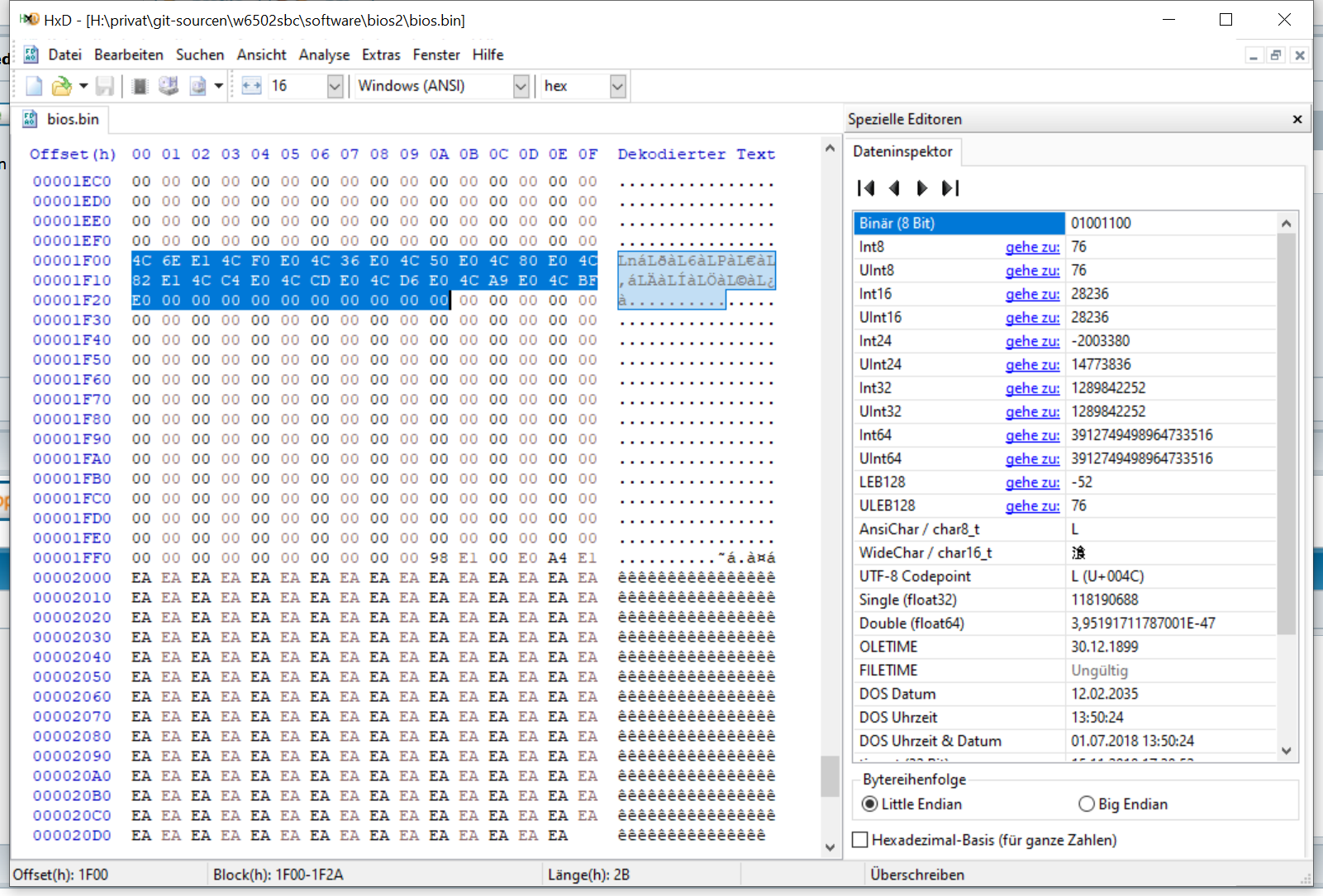

Thats the point, but in the linker generated bin file, all jump are directly behind each other, ignoring the .org directrive.
With retro assembler (which didn't need a linker) it work like charm. But retroassembler is a assembler only.

I don't know why you navigated to $1F00 in the screenshot. That's quite the distance from $FF00 where the first JMP opcode should be.
PostPosted: Fri Aug 26, 2022 7:33 am
Joined: Wed Jul 27, 2022 6:14 am
Posts: 54
because the eeprom base adress is at $e000,
so $1f00 +$e000 = $ff00

What does the line containing "JUMPTABLE" in your mem map config file look like?
PostPosted: Fri Aug 26, 2022 7:46 am
Posts: 54
THis is the full config file

Not sure; since you know the first jmp is in the correct spot, can you try putting each jmp in its own segment and specify the addresses you were using with .org in the memmap configuration? JUMPTABLE1, JUMPTABLE2, etc.
