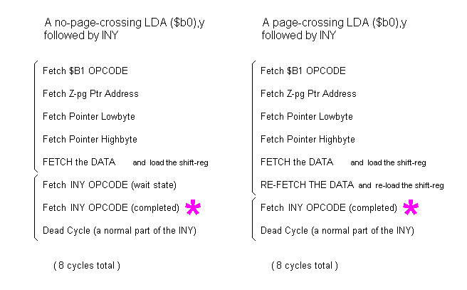

I'm struggling, too, Bill -- with the explanation, at least... My previous post was kinduva mess, so I went back and made some edits, particularly to the final paragraph -- dunno if you noticed the (hopefully) improved version. :roll:
And today I'm including a chart of what happens each cycle, with and without a page crossing. It should be clear that these two sequences end up in the same place even though they each take a different route to get there!
It's also true that the data on the shift register output needs to end up in the same place, timing-wise, despite traveling by different routes. As a reference point, the big asterisk shows when the first of the fetched bits actually appears at the shift register output.
In the case on the left there is a 2-cycle delay from the "Fetch the DATA" cycle to the asterisk cycle. Check me on this, but I reckon it's consistent with what I said about aligning the shift-reg load one place further upstream (ie, via the Early Load path).
In the case on the right there is only a 1-cycle delay from the "RE-Fetch the DATA" cycle to the asterisk cycle. The shift reg actually gets loaded twice, but of course the results of the first load get overwritten by the second load (which puts the byte further downstream, via the Late Load path).
Is this making sense yet? I admit I had an "oh, crap" moment while writing this post... (ie, is this idea fundamentally misconceived??) :lol: But mostly I do think I'm on solid ground, and with luck I've now managed to make it clear why there's never any discarded data bit and also no need to insert a wait state into a previous instruction.
[Edits, including better notations in the chart.]
[Edit: the chart again]
snooptrick sequence .png (6.69 KiB) Viewed 12183 times

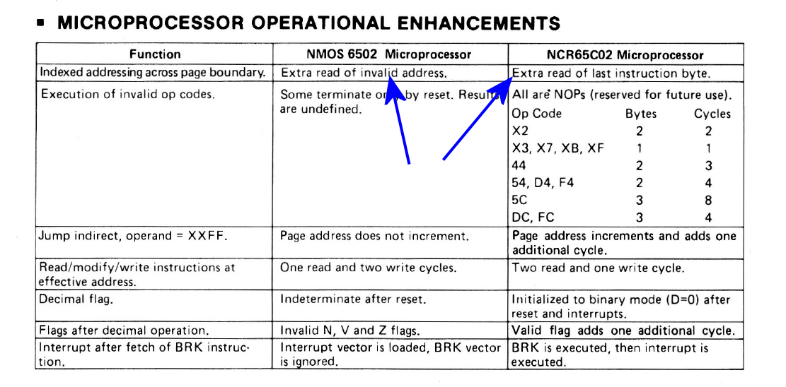

Different than other 'C02s? No, the 'C02 dummy cycles from WDC are the same as those for a 'C02 from Rockwell, etc. But 'C02 dummy cycles do differ from those of the NMOS '02.
On the NMOS '02, when indexing results in a page crossing, the first attempt at accessing the data will fail to account for the carry into the highbyte of the address. As a result, the highbyte will be too low by 1 (ie; the address as a whole will be too low by $100).
This wonky address during the dummy cycle had potential to cause trouble (such as by inadvertently touching IO), so when the 'C02 was introduced it included a remedy. The "too low by $100" address still occurs, but only internally within the chip. Externally, the dummy cycle accesses the last instruction byte instead (ie, it puts PC on the address bus), and that's sure to be safe.
I think this explains why you only see one 40nS pulse every time.
To be honest, I had somehow forgotten about the 'C02 fix until now. :oops: I apologize for incorrectly telling you (upthread) that "Every LDA ($b0),y will touch the $4000-$DFFF region for either one cycle or two." Although two cycles may be consumed, only one will touch the $4000-$DFFF region.
(BTW and FWIW, the 'C02-style protective remedy was removed when the 65C816 came along. Instead, the '816 introduced the VDA pin, an output which will be low during this and other dummy cycles, and if you have read-sensitive IO you want to protect then access to it can be qualified with VDA.)

Something to note is while the dummy cycle wonky address problem was corrected in the C02, a new bug was inadvertently introduced, at least in the WDC 65C02s.
Thanks, BDD and floobydust. Yes there's a bug, and it applies to all 'C02s (not just WDC's). But, to clarify slightly, it's not a new bug that was introduced. The NMOS 6502 had it, too. But it's somewhat of a special case, and it "fell through the cracks" (although only partially) as far as the 'C02 fix is concerned.
( Warning! Descent into nerd-dom ahead! :wink: )
Ordinarily speaking, indexing will never result in an extra (aka dead) cycle unless a page crossing occurs. Ie, no page crossing means no extra cycle. Certainly this is true for all indexed reads (such as LDA, CMP, ADC etc). And the 'C02 fix does apply to indexed reads.
But STA abs,X and STA abs,Y -- which of course are writes -- are very strange animals because the extra cycle always occurs. You'll get a read followed by a write... and it's the read that can prove problematic.
If there's a page crossing then the 'C02 fix does kick in, and the read (harmlessly) uses PC as the address; then there's a write to the correct address. But if there's not a page crossing then the fix doesn't kick in. What you get is a read of the correct address followed by a write to the correct address. :shock: Some IO devices will tolerate this, but others won't. Somewhat counter-intuitively, you can work around the issue if you can somehow ensure (rather than prevent) page crossings when using STA abs,X and STA abs,Y to address a read-sensitive device! And that's the approach used in Kevin's code.
This and other dead-cycle phenomena are described in a detailed document published by Drass and me in 2018. Line 3 and footnote 8 have relevance to the topic at hand.
3. abs,X/Y — write w/o pg. crossing [8]
[8] abs,X/Y write operations without a page-crossing actually read from the Fully Formed Address before writing to it. The read can be troublesome when accessing I/O devices where reads are destructive. For 65C02 there's a software workaround, which is to ensure that the write to abs,X/Y triggers a page-crossing, which means the address during the dead cycle will be a PBA, not the Fully Formed Address. The only software workaround that works on both NMOS and CMOS 6502 is to avoid abs,X/Y address mode when writing to the read-sensitive device.

Subsequent discussions made clear that page-crossing case of LDA ($b0),y does not access data memory twice for the W65C02
Right; there'll be two accesses, but not both to data memory. Probably I fumbled that detail because mentally I'm in another scenario where the address simply doesn't matter. That's my story, and I'm sticking to it! :wink: Anyway, sometime later we can, if you're willing, discuss why accesses to the video buffer should ideally be identified by the cycle in which they occur (ie, timing), rather than the address which they place on the bus.

And during that following cycle we find out whether the load was good data, or just garbage because of a page crossing. If we have good data then at the end of the cycle we cause the reg to shift (and this shift will cause the first of the newly-fetched bits to appear at the output of the shift reg). But if we have garbage then the CPU will re-run the fetch and at the end of the cycle we cause the shift reg to do a second load. We're no longer one cycle ahead of schedule, so we use the Late Load path to put the byte one place further downstream so it'll immediately appear at the output of the shift reg.
INC y with one wait state is 3 clocks, and LDA ($b0),y crossing page boundary is 6 clocks
Yup. So, let's look at what happens during those 9 clocks. I'm appending a rehash of the chart I presented earlier.
Note that the asterisks (which show when the first of the fetched bits actually appears at the shift register output) are exactly eight clocks apart, as required. That's despite the fact that bytes won't necessarily enter the shift-reg at an exactly regular pace.
Questions welcome. It's hard to feel confident that this is clear now, and I haven't omitted anything important... :roll:
'no-cross then cross' sequence .png (8.94 KiB) Viewed 12100 times
