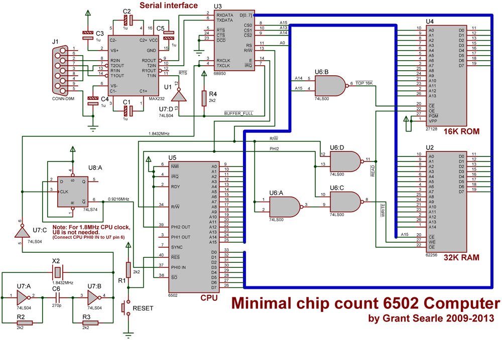

In the meantime, can someone clarify something on the schematic for me? What does the blue line mean? Do I connect all of the pins along the same line or does each pin go to its corresponding pin on RAM and ROM? I do have schematic reading experience, but this confuses me.
Once again, thank you all for the great tips and recommendations!
A heavier line represents a bus, ie, a whole set of connections. It should be drawn with connections coming out of it diagonally though, as if it were a bundle of wires and wires were coming out of the wrapping. See the very basic whole-computer schematic in the circuit potpourri page of the 6502 primer at http://wilsonminesco.com/6502primer/pot ... ml#BAS_CPU . You can add a UART (or even several) in that one too, with no additional glue logic, per the notes there. I would not use a 6850 though, as it doesn't even have an onboard baud-rate generator. [Edit: I see I mentioned that in an earlier post above, too.]
