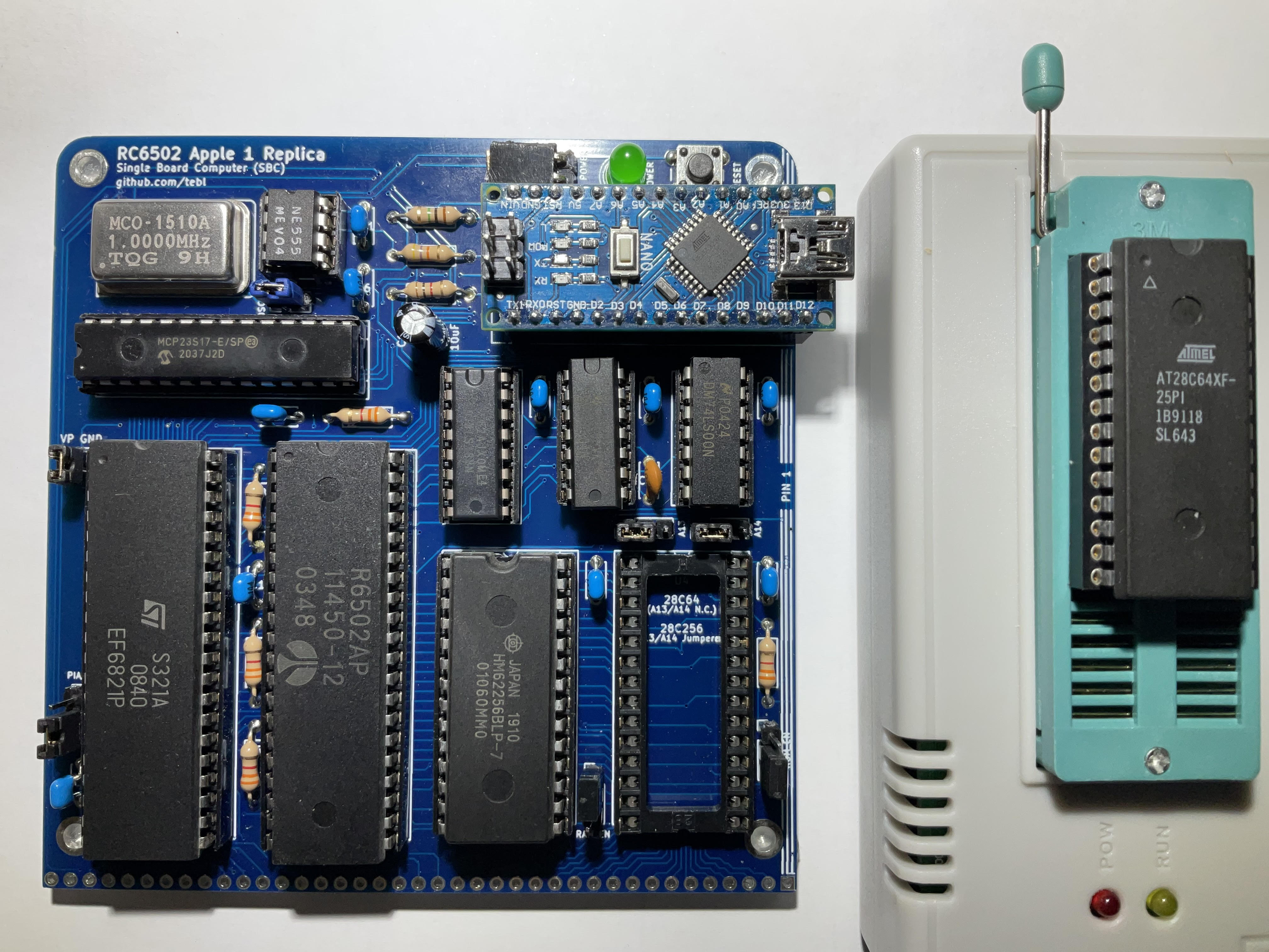

Hi all,
Newbie here, building an RC6502 Apple 1 SBC using an Issue H board.
Soldering is complete and to speed things up, I got a TL866 II Plus to burn the EEPROM which is an AT28C64XF-25PI (from EBay)
TL866 is new out of box and I reflashed the firmware in it. The device drop-down doesn't show an exact match but tried various flavours
and no joy.
I suspect the 28C64 is a 250mS part and I wonder if it is too slow???
Any ideas??
Reg

250ms would indeed be too slow :shock: but I think you mean 250 ns, which should be fine. :wink: (Your clock rate is only 1 MHz, am I right?)
It might be a mistake to focus your troubleshooting on the EEROM. Perhaps that chip is misprogrammed, but it's also possible your project has a problem elsewhere.
In order to assist most effectively we will need more information, starting with photos (which you're allowed to attach to your post). And the CPU -- is it really "RC6502" or is it actually R65C02?
A schematic will also be helpful; also the symptoms you've observed so far. IOW, how does the system behave? Cheers,

Double check your jumper settings before you try anything else... A14 Select and A15 Select need to be un-jumpered to use a 28C64, and ROM_EN needs to short pins 1 and 2 to enable the ROM chip. The way the board is laid out can make this non-obvious at first.
Make sure your ROM chip is good by reading it back and comparing the dump file with the file you wrote. I seem to remember that the EEPROM programmer you have has a "detection mode," so you can tell it to look for a specific chip (in this case, 28C64) to make sure you bought the part you think you did.
If that doesn't uncover the problem, give more details... what specific CPU are you using, what clock speed, etc. I found the SBC version to be a bit fussy to get working, but I did eventually find success. (My modular backplane version is zooming along at 8Mhz with a modern WDC 65c02. :)
Edit: Hey, rereading your first post, I think maybe I misinterpreted your question. You're having trouble getting the ROM to work with the programmer, not with the SBC, is that right? In that case I'd suggest abandoning the manufactured software and switching to "MiniPro:" https://gitlab.com/DavidGriffith/minipro/. I run it on an old ThinkPad with ubuntu; there's also a MacOS version. Not sure if there's one for Windows.

I am building the SBC off the github/tebl and will be using the 8k .bin file from there (when I can burn it).
Have done basic post-soldering tests and all chips except 28C64 are socketed but I have NOT turned on the power.
I am trying now to program the EEPROM in the TL866. Never done this before and it is a new toy :D
TL866 is from XGecu and the supported devices list from their site (28-pin dil only) is :-
AT28C64 AT28C64B AT28C64B(Non-Standard) AT28C64E AT28C64F
I have tried several of the above to no avail. I must admit I cannot find much detail on the XF variant.
Just noticed there are "HC" variants (not tried) of the 28*** but mine is definitely a "C"
I have attached a bit of 6502 Pron for you.
Thanks
Reg

Thanks. Yes, I am still trying to bet the .bin file onto the 28C64 using the TL866.
I will give that alternative software a whirl later on and get back. Manufacturer's software often lets these devices down.
Linux isn't a problem; use WIN for day-to-day but have a laptop and another box on Linux.

Great! My database has an "AT28C64" entry, which I think should work with your chip. I'm not totally sure what "XF" means, however. The Atmel data sheet doesn't list an "F" suffix, and googling for your exact chip doesn't turn up much.
Edit: I also came across this blog post: http://stuffandnonsense.elephantandchicken.co.uk/?p=904 Hopefully, you have not been the victim of counterfeit parts, but if you have you might be able to get it working by trying some alternate model codes. I'd suggest getting some more ROMs from, e.g., Mouser. You can never have too many ROMs! :D

Have you tried the Catalyst CAT28C64 device on the programmer? I had a case with a AT28C16 where the programmer wouldn't work with the Atmel device but would with the Catalyst.
PostPosted: Thu May 19, 2022 8:44 pm
Posts: 1385
Maybe it's nothing, but the 74LS04 looks a bit odd sitting in the socket. Might be worth checking to ensure all leads are inserted in the socket and that all chips are making good contact.
Beyond that, hopefully the software you're using to program the EEPROM can read the chip contents and allow you to view the buffer contents. This should allow you to get an idea of what's on the chip.

Thanks ever so much for the help; it seems to be working now got into WozMon at least :D

It is indeed still working nicely this morning. I had the usual panic when plugging in because the jumpers were incorrect (who said non-obvious?). It is a good job it worked after that because my tools are limited to a soldering iron & DVM.
Have had a quick whirl on WozMon, Krusader & Basic.
Is there a sane way to get back to WozMon from the others?? (RST is fine though)
The MiniPro software worked perfectly using 28C64 although it is a long time since I have seriously used CmdLine (Solaris on Sun workstations mid-late '80s???). We get spoilt usin GUIs :cool:
MiniPro programmed and reported verified OK. I re-verified OK using Xgpro but noticed a "Pin Detect" error which may have been my original error.
Indeed, the 74LS04 was a bit twisted in the socket but making good contact. Not sure how I managed that.
