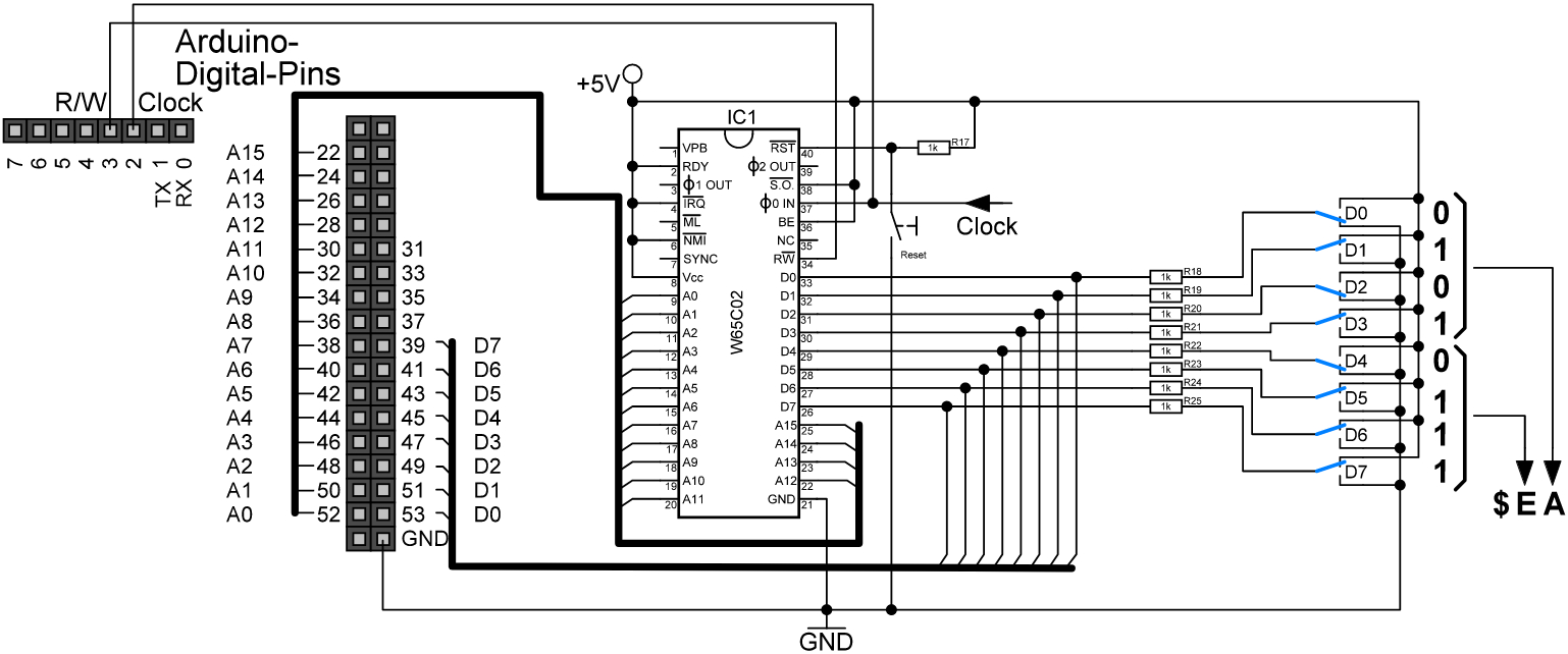

Hello everybody,
here ist the circuit-diagram, and it's really simple for you guys. it's embarrassing for me!
So there's no code needed because of the $ea on the data-bus.
I inspected the address- and data-bus with the connected arduino, like Bean Eater did it.
As I said, on the breadboard it works fine, an on my pcb, it sometimes worked. Very seldom! I love these unpredictable errors :-(
Thanks a lot for your support!!
Best
Erik

If your implementation works sometimes - even if not often - then you should check your construction. In particular, check the soldering, particularly for dry joints (the molten solder should have flowed over both parts of the joint, should be smooth and shiny.) For a small project, it might be worth simply re-soldering all the joints, with plenty of flux.
PostPosted: Fri Aug 12, 2022 7:18 am
Maybe bounce on the reset button. I would hook up the reset button to an Arduino input pin, and then hook up an Arduino output to the reset line so you can generate a nice clean pulse.

I cleaned up everything and re-soldered some connections. Now it's fine.

You need to debounce your reset switch with a Maxim DS1813 or similar. Without some kind of debouncing, there’s no assurance the MPU will execute a clean reset. The pullup resistor (R17) should be 3.3K, or thereabouts.
Also, RDY must not be directly wired to VCC. RDY is a bi-directional pin and if, by chance, a WAI (WAit for Interrupt) instruction is executed, intentionally or otherwise, RDY will try to sink VCC.

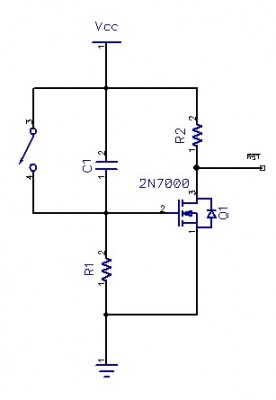

Posts: 1007
DS1813's are getting pricey. They are 1/3 of the cost of a W65C02 these days. The DS1233-15 is a more reasonably priced device. However, a small cap, a couple of resistors and a little MOSFET like a 2N7000 can provide a nice reset circuit for well under $1.

I've seen some awfully noisy, bouncy switches, including pushbutton. (They get worse as they age; so just because it works nicely when new doesn't mean it always will.) If you happen to get one of these and don't realize what's going on, it could be awfully discouraging. There's often (usually?) a spare gate section somewhere on the board, and especially if it has a Schmitt-trigger input, you can use it for a reset circuit with a few discretes that altogether cost a few pennies. I show such circuits on the reset page of the 6502 primer, at http://wilsonminesco.com/6502primer/RSTreqs.html .
BTW, the DS1813 does have an internal pull-up resistor which the data sheet says is typically 5.5K, and may be quite a bit lower. I don't think there's any point in adding an external one.
