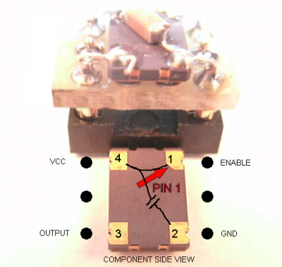

Posts: 3526
Re: SOT: Why, oh why? Oscillators
BillO wrote:
Actually, I was just looking for stand alone 5V oscillator in a can.
Perhaps it's the "in a can" aspect that's problematic. At any rate, I had no difficult with price or availability in 2015 when I selected an 80 MHz oscillator in SMD format. (And it's 5V powered.)
I hacked my own mounting, as this was for a through-hole project (wire wrap, in fact) with very little available space.
That's another possibility I could look into.
