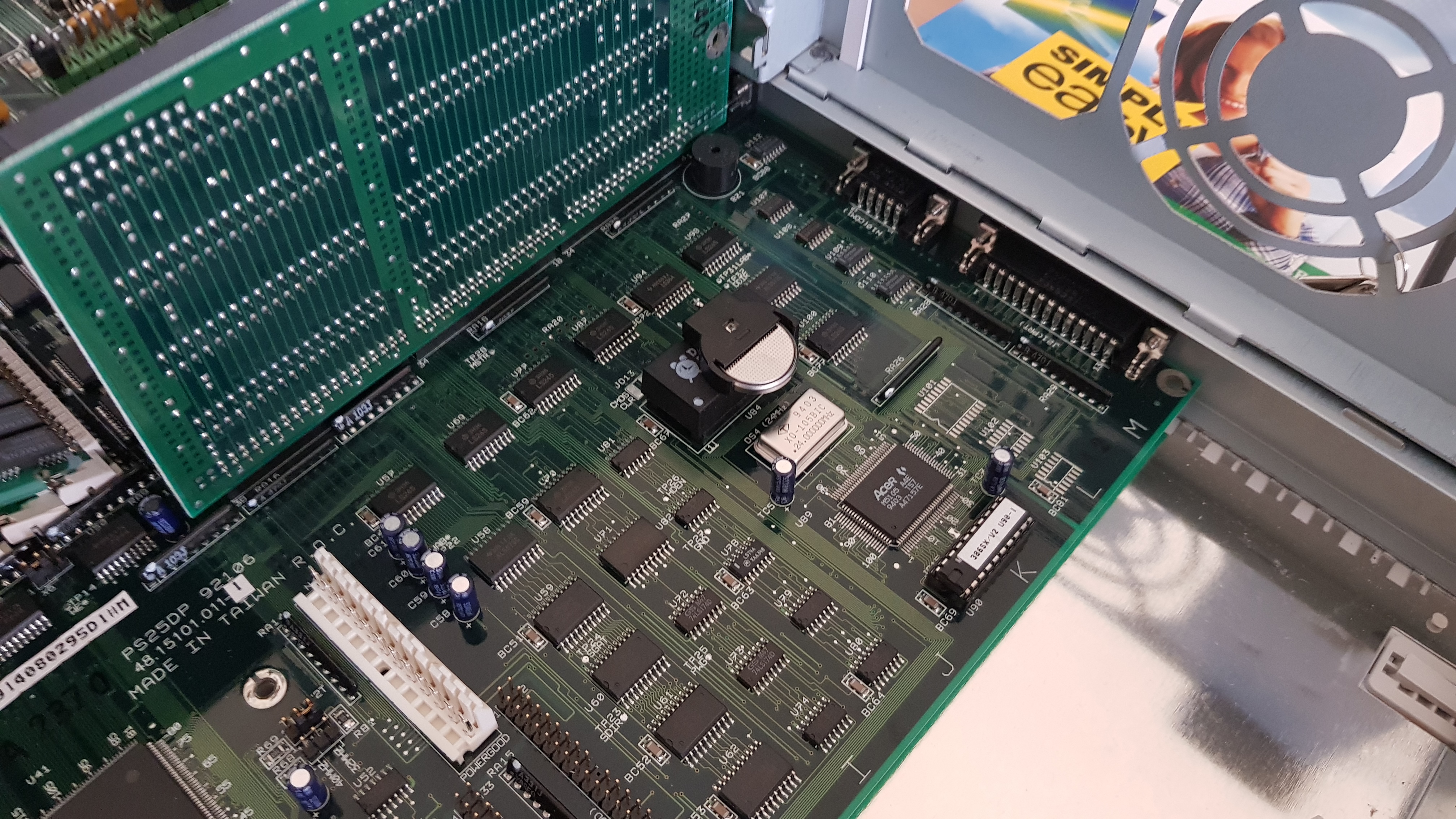

I've seen people show how you can take a dremel to some of these packages, to expose the internal supply rail and to allow the fitting of an external battery. Of course you'd need to have the right part in the right package to be sure of excavating the right spot.
I once did that for an old 386 PC using nothing but a triangle file and vice, it was surprisingly easy.
I put a generic CR2032 cell holder ontop and it works perfectly fine.
EDIT: i still have one of those but without the holes, a DS1287 to be exact
