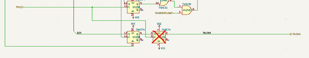

Ok, so, testing on TIMERA is completed. I may still try more stuff eventually, but it feels quite good. I manage to get my missing CNT pulses... I just missed a pull-up resistor on the SBC!
Yesterday I said START was arriving a cycle earlier, however I have one extreme case, which makes me doubt it, and now I'm thinking it's a deeper issue. This fragment of code :
               lda #$06
               sta CIA2_TALO
               lda #$00
               sta CIA2_TAHI
               lda #$01
               sta CIA2_CRGA
               lda #$00
               sta CIA2_CRGA
I setup TIMERA to count down from $0006. Then load $01 into CREGA to start the timer, then load $00 to stop it. Even though the timer is running in continuous mode, and we should see 6-5-4-3-2-1-6-6-5-4-3-2-1-6-6, by stopping the timer right on underflow, reload is not triggered. This is normal behavior, and I get it on original hardware, but also on 74HCT6526. So, if timer is starting one cycle later, then it's also stopping one cycle later, and indeed... In my last revision, I added a new FF in the clock pipeline to sync the clock pulses, instead of trying detect rising edge of PHI2 to count. This, of course, delays the whole pipeline by one cycle.

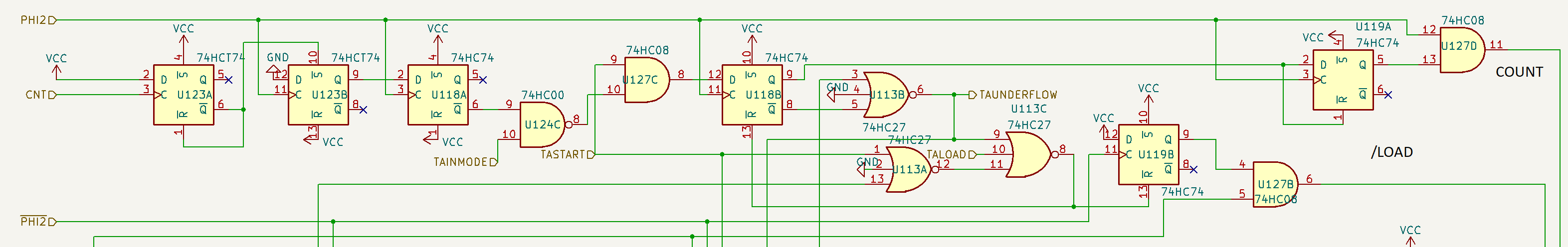

But also, a flip flop was also added to extend the LOAD Pulse for the timer (Before, as soon as one timer output was reloaded, the pulse ended, and this was causing many issues). Again, this delays forceload by one cycle.
The clock pipeline is complex, big, and kinda has it's own consciousness. It's based on Wolfgang Lorenz model (https://ist.uwaterloo.ca/~schepers/MJK/cia6526.html) with many tweaks to make it work. Although it now seems to work ok, I feel it's the weakest link, and that any attempt to make it better... will just make it worse.
After a very intense week, I'm going to let it cool a bit. Meanwhile I'll start working on B2 reusing B1 as it is.

PostPosted: Sun Jul 31, 2022 2:55 pm
Posts: 192
Location: Madrid, Spain
daniMolina wrote:
As stated before, FORCELOAD is a cycle earlier than it should be.
Not quite correct... FORCELOAD was a cycle later, not earlier!
Just bypassing one flipflop solved the issue, and now the behavior on FORCELOAD is cycle exact. Saving this one FLIPFLOP means I can remove a whole IC from the board.

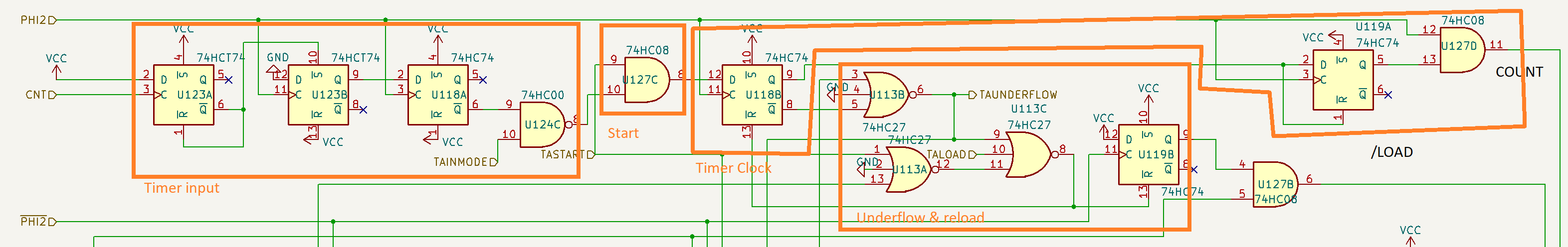

One last thought for TIMERA, before moving on to B2.
This is my clock pipeline for the timer:
These are the sections of the pipeline :
Timer Input. It switches counting between CNT to PHI2, depending on the TAINMODE input from the Control Register. When TAINMODE=0, timer input always outputs 1. When it's 1, it emits a pulse after each CNT rising edge. As the CNT input is not syncronized to the system clock, these DFF convert the rising edge to a single clock pulse.
Start. If TASTART is 1, it equals the Timer Input value, allowing the timer to count. If TASTART is 0, nothing happens after this point
Underflow & Reload. This section handles the timers reload from the latches whenever needed. It isn't relevant to my issue.
Timer Clock. This section mixes the output of Timer input, whenever START=1, with PHI2, to generate a pulse each time the timer needs to count down. It's, I'd say, very convoluted, and it is so it can replicate the behaviour of MOS6526.
When counting down on PHI2, the moment we reach 0000 in the timer, it resets and reloads the original value from the latches. At this moment, U118B is reset, so during a PHI2 cycle, there's no clock to the timers, and the reloaded value is repeated for a cycle, with no 0 appearing at any time (3-2-1-3-3-2)
This is different when counting CNT pulses (Or TAPULSES for TIMER). Here we get 3-2-1-0-3-2-1....
I've made the following time diagram, when counting PHI2.
The issue is, the second FF (U119A) delays the clock by 1 cycle, so the timer starts counting 1 cycle late. Removing this FF fixes this, but then I'm not able to skip a clock after underflow. I've been scratching my head for a week, trying different solutions, but doesn't feel I'm getting any closer.
As I said before, this pipeline feels... delicate. Changing anything affects everything, and I'm actually amazed it works the way it does. So, for now, I'm moving into B2. Schematic is complete, and routing of the PCB is almost there. It's pretty much a reuse of B1, so it's been an easy one.
Oh, BTW, If the pipeline is complex, keep in mind that, when TIMERB is counting TA underflows, I'll have two of them chained.
Let's just hope a cycle offset it's not harmful :)

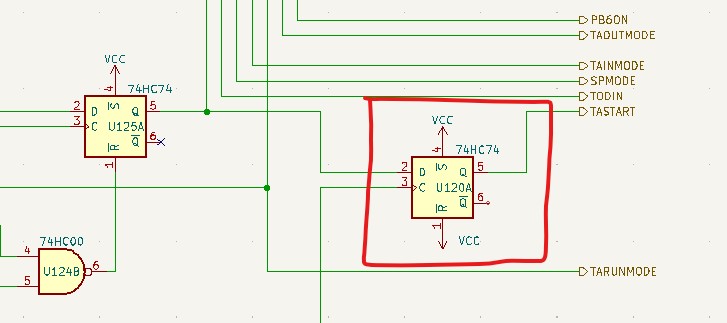

Ok, I'm very sorry, but I lied. I didn't know it when I posted this.... but I lied. I couldn't move it out of my mind... I was so close...
I've spent the last four days drafting tons of time diagrams. Trying to understand all the signals from the "timer clock" section of my previous schematic.
Reloading was perfect, skipping the cycle it had to skip. Starting and stopping seemed OK, counting just as many cycles as an original MOS6526.. but one cycle late. Start was arriving too late, and I needed it to reach the pipeline faster. But every attempt failed. At one point I got creative and I kind of invented the FFFF (FlipFlop From the Future). It had the value of my start bit, one cycle before setting it (Impossible, of course, but desperate situations require desperate measures), and with this, my hand-made simulations worked.
Yesterday, I gave up. There must be something very wrong with the whole design, if I need a FFFF, right?
Nope.
I have to go back to school... I may need some basic maths, like... very very basic.
Start wasn't arriving one cycle late, it was one cycle too early. Timer was one tick ahead of where it should, so... I was starting to count to early, not late!
So, of course, my FFFF became a regular DFF, of which I have no less than 100 in handy little packages of two (74HC74).
So...
And...
All test pass. So, until now, everything is cycle exact.

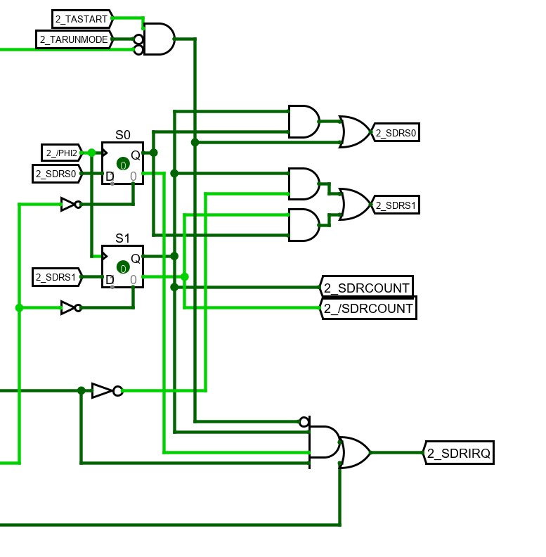

daniMolina wrote:
For SDR, I think I may finally cheat a bit. I'm tring to simplify the state machine than controls the register, but with no results. I may need somewhere between 8-10 74xx ICs to build this. So I may go the GAL route. I have no experiences with them, but I think a 16V8 will be enough. I need 7 inputs, 3 outputs and 3 FlipFlops. Will need to investigate further, but seems within the capabilities of this chip. Still. I will try a full 74xx implementation.
Ah! The wonders of boolean algebra!
In turns out that this :
Is exactly the same as this :
I resorted back to 2 bit states instead of 3. One less bit, one less equation for the state machine. Juggling around the value for each state, and with some simplications... I can cut the IC count in half.
The main improvement has come from one little change. I have an idling state, a "Load shift register" state, and two for "Emit byte", one with no more bytes in the queue, one with an additional byte in the queue. By loading the shift register also on the Idle state, everything fell into place. True, I'm reloading the output shift register eache PHI2 cycle but... it doesn't matter at all.
This brings down the total IC count for SDR to around 21. ICR will be aproximately the same, so I'm looking at 40+ ICs in a single board, meaning this will be, so far, the densest of all the stack. Right now B2 is the densest one, with 28 ICs.
However, either I'm getting better at this, or somehow SDR turned out ot be more logically organized. The point is, layout is coming out very nicely, and I'm managing to cram the ICs very very close to each other :
