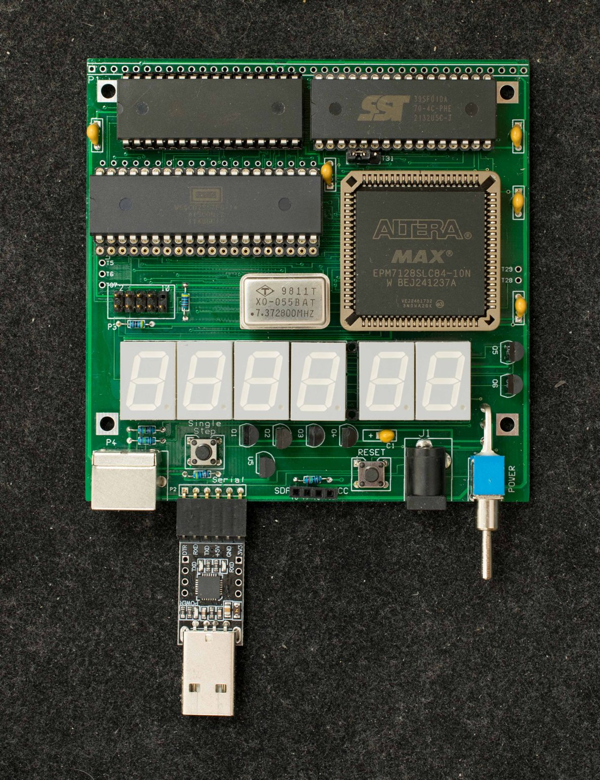

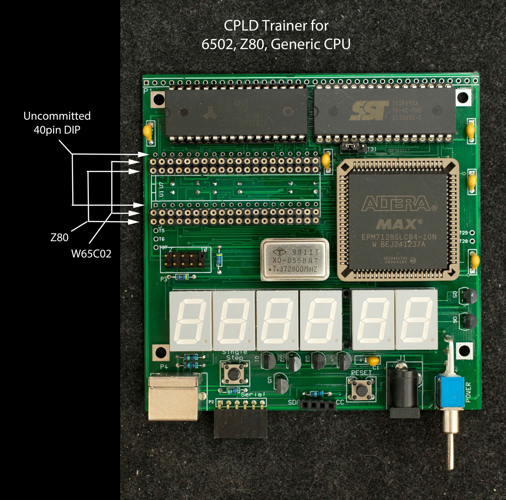

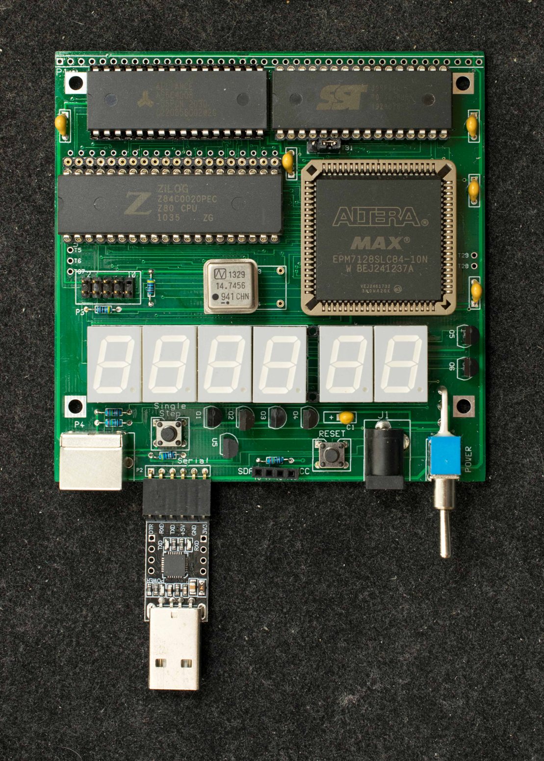

Updated the CPLD trainer to rev1 pc board to fix known pcb errors. I also added a new feature: multiple 40-pin CPU are co-located on the pc board. Because CPLD can be reprogrammed to accommodate different CPU, the same pc board design can accommodate different CPU as long as the CPU is in 40-pin 600-mil DIP package. Each CPU is located in the same board area but offset by 0.1". In theory 6 different CPU can co-located in the same area but rev1 pc board implemented 6502, Z80, and an uncommitted 40-pin DIP which can be any 40-pin CPU with connections manually wired in. This is part of my efforts to develop common platform for retro-computers.

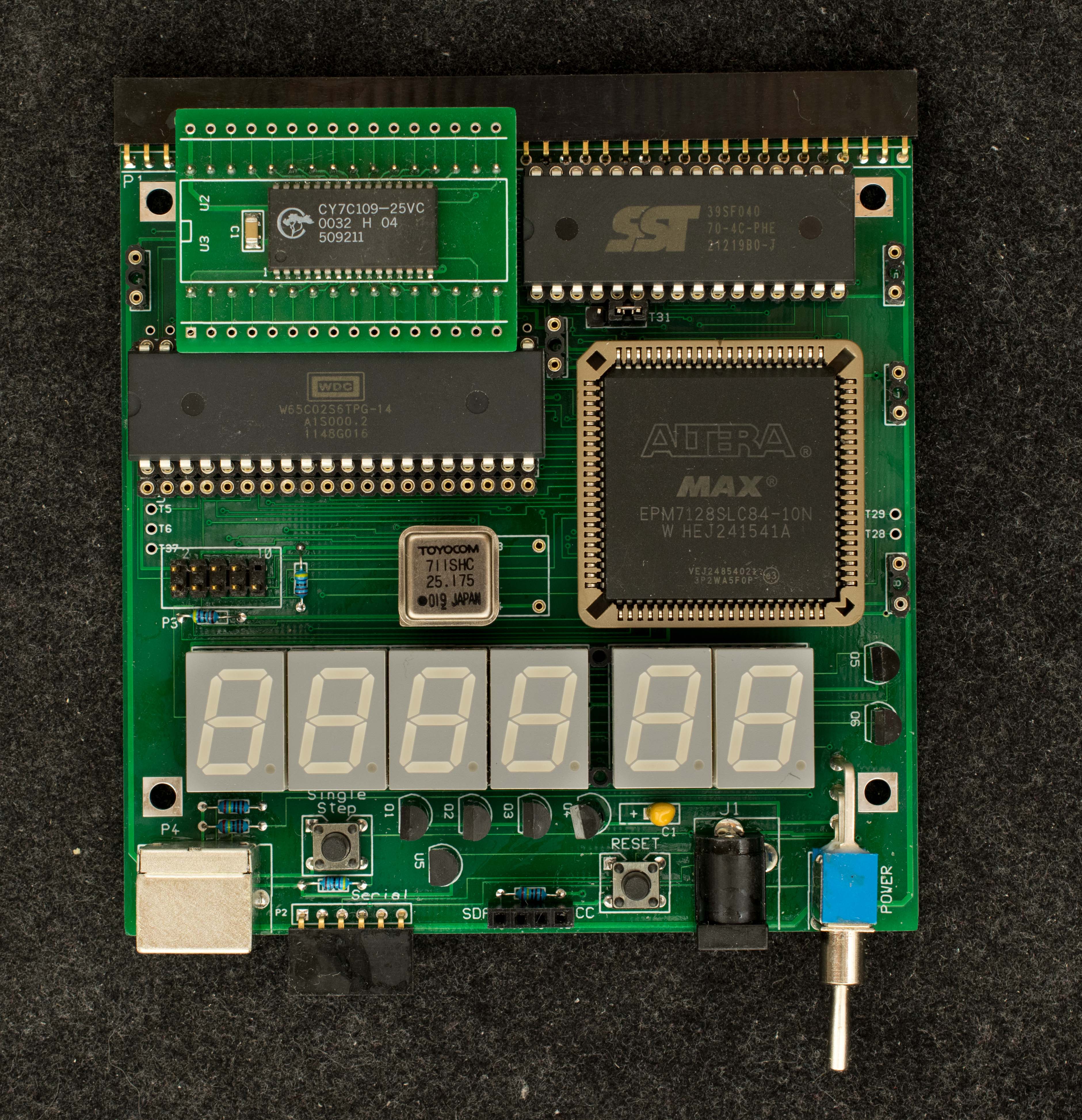

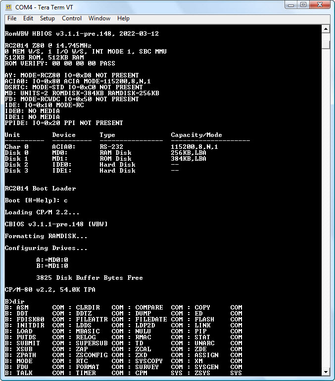

By reprogramming the CPLD for Z80 timing, populating the trainer with Z80, 512K RAM, 512K flash and installing ROMWBW software in flash, it booted up and able to run CP/M with 384KB of ROMdisk and 256KB of RAMdisk. This is sufficient to explore CP/M. For more disk space a compact flash board can be added to the expansion bus.
Replace Z80 with W65C02, reprogram the flash, and reprogram the CPLD, it becomes a 6502 SBC.
I have several 6809. I can wire the uncommitted socket for 6809 and see what it takes to get 6809 running on this board.

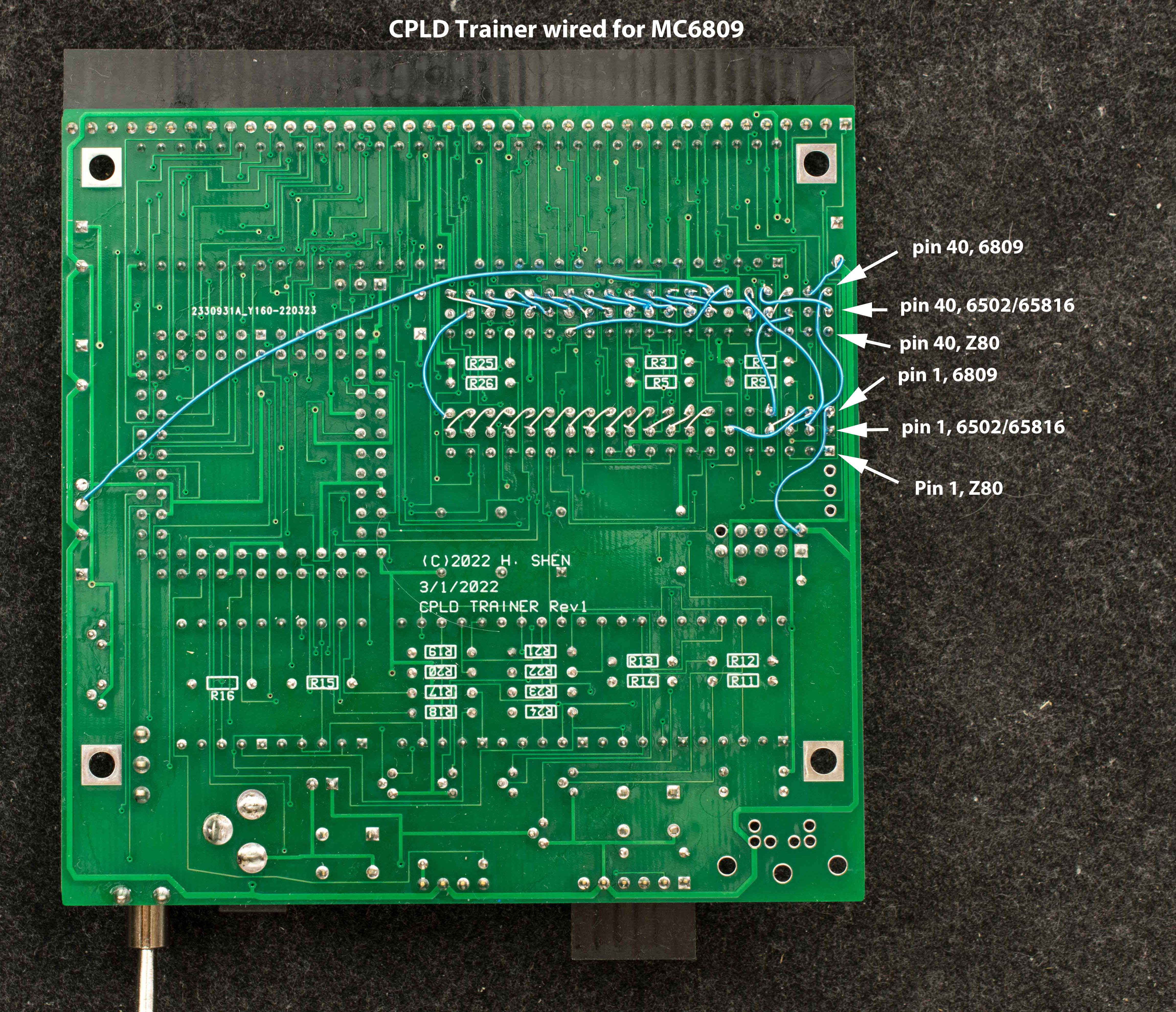

I built up another CPLD trainer and wired the uncommitted 40-pin socket for 6809. I'm surprised to see how similar the pin assignments of 6809 and 6502 are. So wiring address/data/control from 6502 to 6809 are fairly simple and neat. 6502.org is not the place to talk about 6809 so I'll continue the exploration of 6809 on retrobrewcomputers.org.

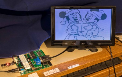

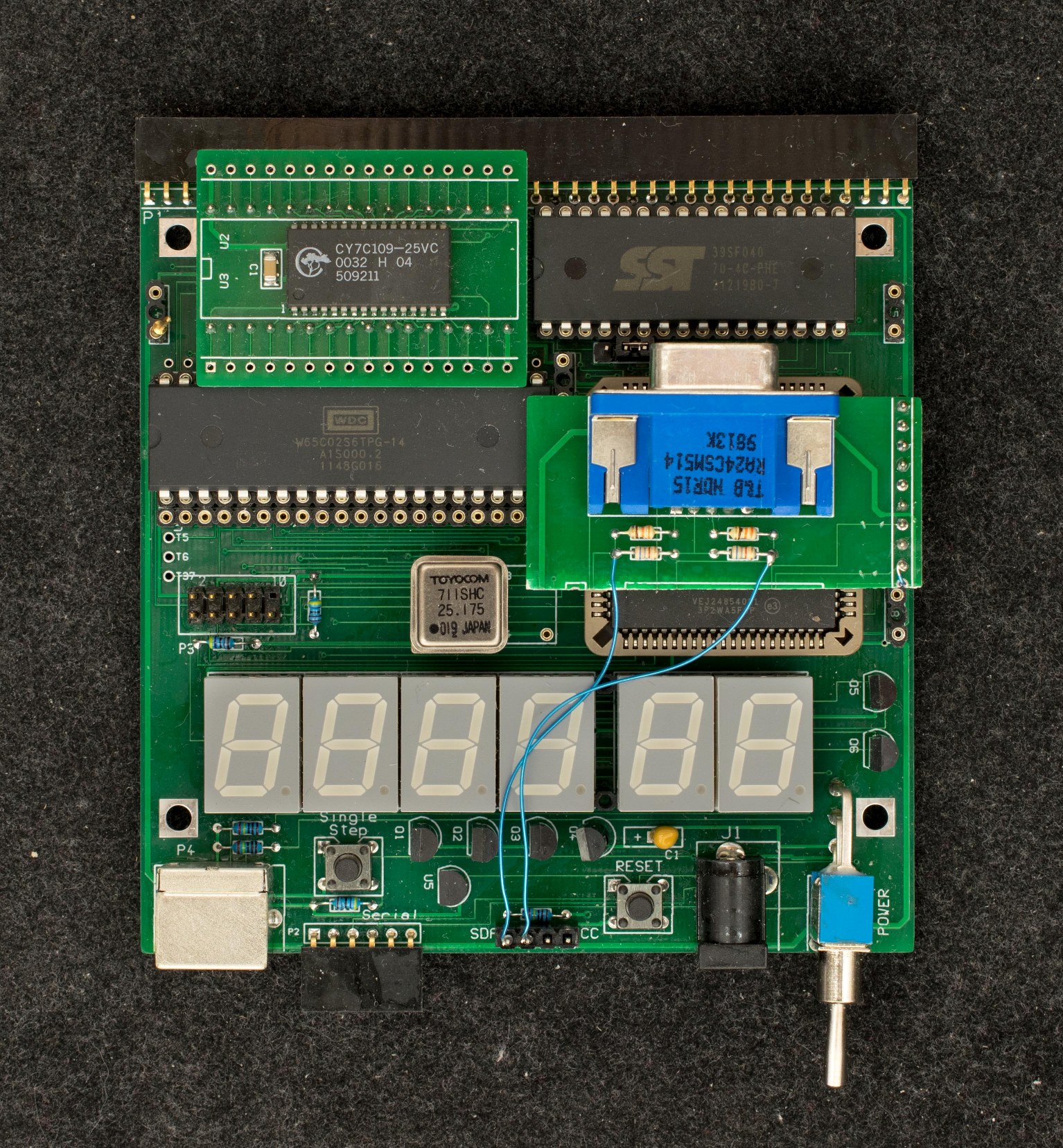

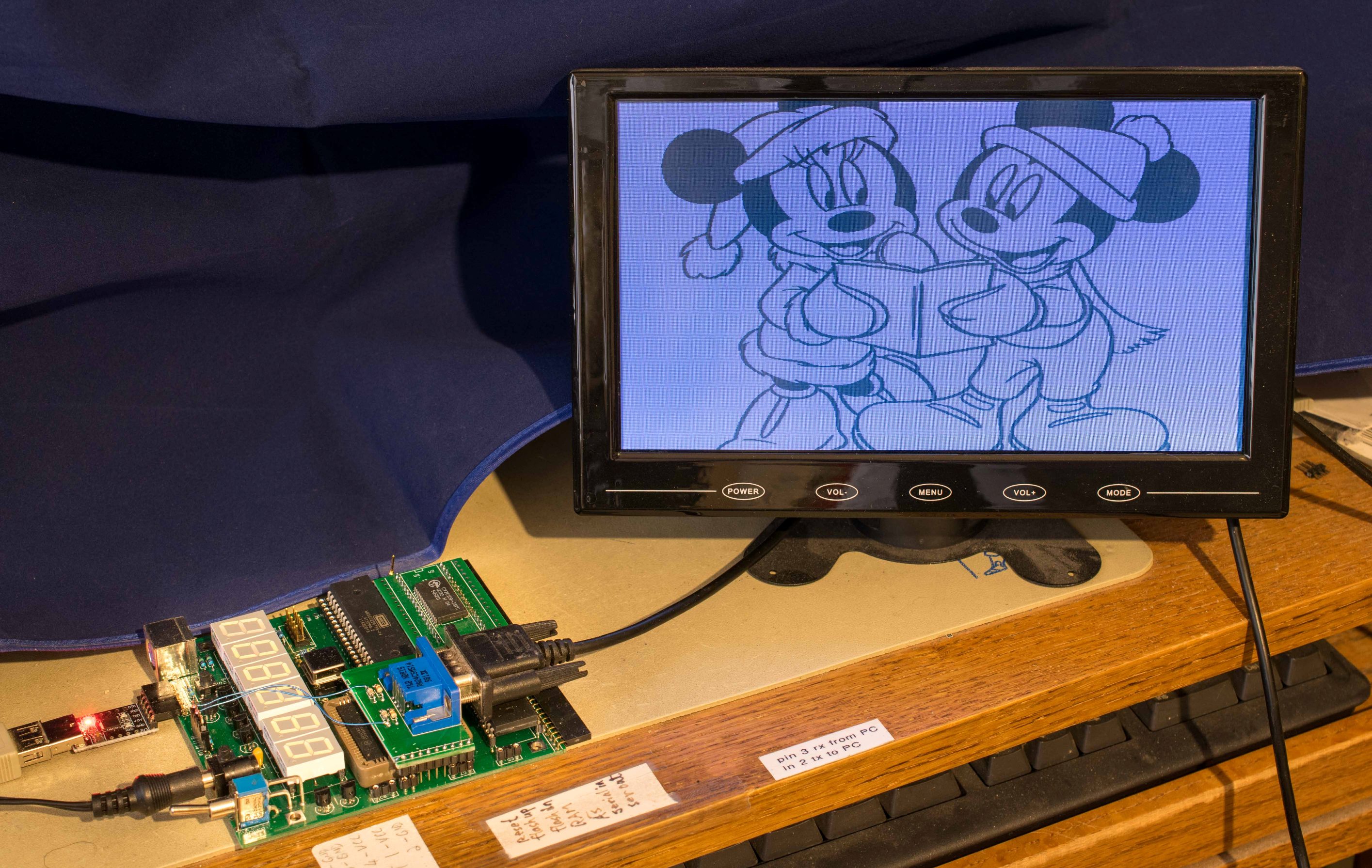

The project is creeping along--way too many distractions. I added a VGA connector and wired HSync, VSync to spare pins. VGA's RGB signals are driven with repurposed I2C signals. The 31KHz HSync is generated by dividing 25MHz by 800 in CPLD hardware. HSync also drives 6502's interrupt such that 80 bytes of video data are shifted out in the interrupt service routine to form 640 pixels per HSync. Vertical Sync is generated in software. This scheme works well enough to display a static 640x480 image. The challenge is how to display 640x480 video.

Can you give us a little more detail, please, re the ISR for NMI? I have a feeling there's a trick involved, but I'd like to hear you explain it.
 Post subject: Re: CPLD + 6502 Trainer
PostPosted: Sat Aug 13, 2022 12:30 am
Posts: 1076
Very nice, Bill!
Jeff,
I used IRQ instead of NMI, but now you've mentioned it, NMI may be a better choice, assuming it is turned off initially and can be turned on by writing to a magic location.
The program always waits for IRQ while executing WAI instruction so it has a consistent interrupt response time. The IRQ service starts off with some NOP as front porch followed by 80 set of the following instructions:
.byte 3 ;single cycle NOP
LDA ($b0),y
INY
Each set of instructions take 8 clocks to execute; ZP $b0,$b1 points to graphic data in RAM region $4000-$DFFF; hardware in CPLD snoops memory access between $4000-$DFFF and load the data into a 8-bit shift register that shifts data out at 25.175MHz. Oh, maybe this is the trick you are thinking of: the original graphic data needs to be reformatted to fit 3 lines per page so LDA ($b0),y does not cross page boundary. The reformatting is done to the original graphic data during the vertical retrace period.
While 6502 has some spare capacity to receive/store serial input during each horizontal retrace, processing of the serial data needs to be done during the vertical retrace period.
Attached are the VGA test program and schematic of CPLD (the VGA-related logic is in the bottom 1/4 of the CPLD schematic).
