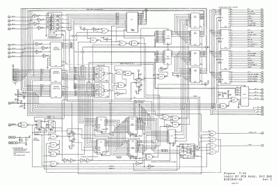

Posts: 3526
Re: Turing Tarpit Programming Challenge
I'm relatively sure some very early machines offered subtract only, rather than add only
Yes, and the list of "very early machines" even includes some embedded applications! Diablo daisy-wheel printers had a processor built entirely with TTL (ie, no microprocessor), and I had a client that used a fleet of Diablo model 1345's in their manufacturing operation in the late 1980's and well into the 1990's.
Based on the schematic diagram (below) I was able to reverse engineer the instruction set, and it is painfully limited (ie, only ten instructions). In that respect its context seems relevant to this thread.
And Ed's remark is applicable, as there is no "plain vanilla" ADD instruction. Only two approximations are available.
  • There's an instruction that'll fetch a register, add-with-carry an immediate constant hard-coded in the program and, then store the result back to the register; and,
  • there's an instruction that'll fetch a register, fetch a second register and invert the data, add-with-carry, and then store the result back to the first register. Because of the inversion, this instruction is essentially a subtract (with borrow, if carry is clear). To accomplish a register to register addition you need to firstly create an inverted copy of one of the operands and then subtract.
Martin_H wrote:
I actually didn't need any bit operations for this project, but I included them on the list because eventually you would need them.
The firmware for the Diablo relied heavily on bit operations, and there were several registers which each contained only a collection of unrelated bit fields. But (as with addition), things weren't entirely straightforward. :roll:
There was no logical OR instruction, so the only way to set a bit in a register was to use the instruction (noted above) which adds a hard-coded constant to the register. But of course that's inappropriate if the bit happens to already be set! :shock:
So, if you wanted a certain bit set, you'd first test that bit to see if it's already set... and then do a conditional branch! (ie, take no action if it's already set; otherwise add $01, $02, $04, $08 or whatever you need in order to set that particular bit! :lol:
I got completely sucked down the rabbit hole, and eventually ended up reverse engineering the firmware and then hacking it. And yes it'd be fair to call this a Tarpit programming challenge! (Why hack the original firmware? The second half of this page describes the goals (although not the actual code). And there's a page about the processor itself here.)
