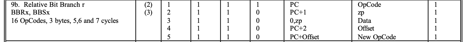

I was reading through the instruction timing chart (table 6-5) of WDC's W65C02S datasheet (February 2004), as one does, and got a little confused when it comes to the behaviour of the BBRx and BBSx instructions.
It is my understanding that they have only 1 addressing mode which is really a kind of juxtaposition of zeropage and relative addressing (how it's described in Bruce Clark's 65C02 tutorial here. Some sources identify this as a bonefide addressing mode, but WDC just call it relative (e.g. c.f. table 6-4).
Looking at the documented bus behaviour of BBRx and BBSx, however, the confusing part is that these sets of of instructions have 2 slightly different entries, one classifed as relative and one classified as zeropage.
The first (relative) goes like this:
WDC instruction timing chart entry for  BBRx and BBSx, classified as Relative

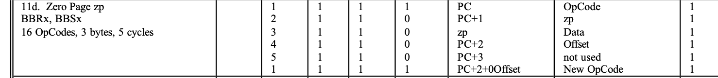

Whereas the second (zeropage) goes like this:
WDC instruction timing chart entry for  BBRx and BBSx, classified as ZeroPage
I also note that the first (relative) description adds a note that an additional cycle is taken if the branch is taken, whereas Bruce's document mentioned in the above states that:
Unlike other branch instructions, BBR and BBS always take the same number of cycles (five) whether the branch is taken or not
This seems to correspond better with the second (ZP) entry from the WDC datasheet.
So my question is whether there is some distinction in the instruction timing that I am overlooking that warrants these 2 different descriptions or whether it is simply an error in the datasheet.
Thanks in advance.

Here's how the 6502 Decoder treats these instruction.
   // Example: BBR0, $50, +6
   // 0 8f 1 1 1 <opcode>
   // 1 50 1 0 1 <op1> i.e. ZP address
   // 2 01 1 0 1 <mem rd>
   // 3 01 1 0 1 <mem rd>
   // 4 06 1 0 1 <op2> i.e. Branch relative target
   // 5 20 1 0 1 (<branch taken penalty>)
   // 6          (<page crossed penalty>)
The instruction is 5, 6 or 7 cycles, depending on whether the branch is taken, and whether it's to a different page.
This is certainly correct for the Rockwell implemenation, and I would expect it would be the same for the WDC implementation.
Posts: 3526
Re: Instruction timing of BBRx and BBSx
Yes, the instruction is 5, 6 or 7 cycles. With Bruce's approval, Garth & I have some edits on the go to correct that little error and to add more info re the C02's undocumented NOPs.
