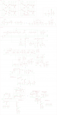

MOS 6522 dissection //NMOS

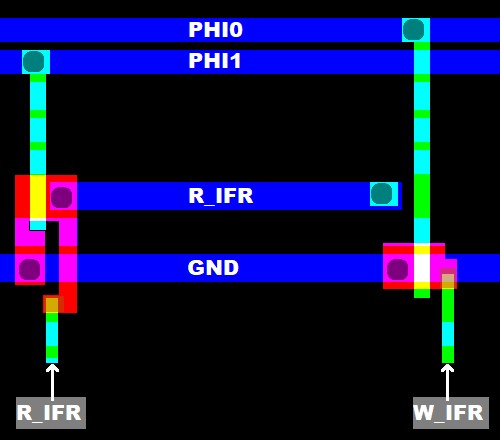

High_active read control signal R_IFR reads the register Bits into the internal
read data bus D0..6r during PHI1=0, also it reads IRQ into D7r during PHI1=0,
so that the MSB indicates an active IRQ# pad.
High_active write control signal W_IFR uses internal write data bus D0..6w# (low_active)
for clearing register Bits during PHI0=0.
Writing 1 to a register Bit clears a register Bit.
Writing 0 to a register Bit does no change to a register Bit.
This way, the 6502 can clear specific interrupt flags by writing IFR.
Of course I'm simplifying things, because the RS flipflops are not built from two NOR gates,
they are built from two "open collector" inverters which have pullups to VCC at the outputs.
Control signals enter the register block from the South,
North of the register blocks we have the usual FETs switching control signals to GND
during a certain clock phase.

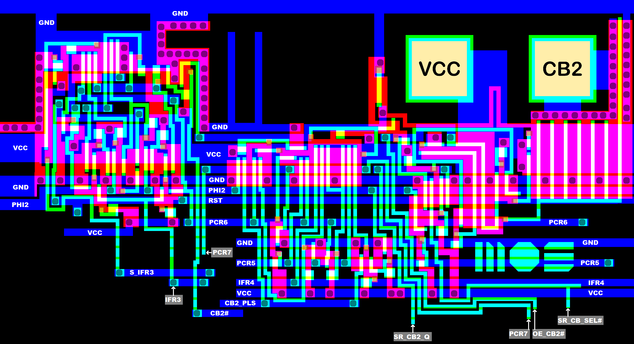

Note, that in the IFR area of the chip silicon, we also have some logic gates related
to handshake logic for clearing IFR0,IFR1.
Plus some other logic gates for clearing IFR6,IFR7 during Timer reads.
IFR7: reads IRQ status, write has no effect
IFR6: SET by Timer 1 underflow, CLEARED by T2L read or R2H write
IFR5: SET by Timer 2 underflow, CLEARED by T1L read or T1H write
IFR4: SET by CB1 active edge, CLEARED by ORB read/write
IFR3: SET by CB2 active edge, CLEARED by ORB read/write if CB2 is not "independent interrupt"
IFR2: SET by 8 shifts completed, CLEARED by shift register read/write
IFR1: SET by CA1 active edge, CLEARED by register $01 (ORA) read/write
IFR0: SET by CA2 active edge, CLEARED by register $01 (ORA) read/write

Now for an overview about the whole Timer 1 + Timer 2 section:

The reason why the circuitry looks like this is that the 6522 actually writes the
register in the first half of the cycle which follows the 6502 write cycle.
The other three RS flipflops are related to handshake circuitry,
for the rest please see the "handshake cheatsheet" up in the thread.

19) CB2 input/output
At the input side, we have an edge detector similar to "13) CA1"
sampling CB2 during PHI0.
When sensing an active edge, it sets IFR3 by high_active signal S_IFR3.
Active CB2 edge is selected by PCR6:
PCR6=0: CB2 falling edge detect
PCR6=1: CB2 rising edge detect
Also, "22) shift register control" taps the low_active CB2# signal
from the edge detector for generating the serial data input
which goes into "10) shift register".
The output side is based on what we had in "14) CA2",
but we have some additional circuitry because the shift register
can use CB2 as a serial data output.
Like with CA2, again we have a RS flipflop and use the low_active /Q output.
But this time, /Q goes through an inverter, then into a 2:1 multiplexer.
Signal SR_CB1_Q also goes into the multiplexer, is the serial data output
of the shift register generated in "22) shift register control".
The 2:1 multiplexer is controlled by ACR4.
ACR4=0: shift register shifts in serial data, and does not use CB2 at all.
ACR4=1: shift register shifts out serial data through CB2.
The output of the multiplexer goes into the non_inverting push/pull driver
which switches the CB2 pad to GND/VCC.
Low_active signal OE_CB2# enables the driver,
it is generated in "22) shift register control.
There is a pullup to VCC at the CB2 pad.
But now back to the RS flipflop.
If CB2 is configurated as an input by PCR7=0,
this forces /Q to low by overriding anything else that goes into the flipflop.
Control signals PCR5 and PCR6 then select, what sets or clears the flipflop
(and what comes out at CB2 if CB2 is configurated as an output).
For more details, please see the simplified CB2 schematic in the "handshake cheatsheet".

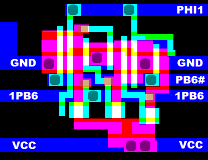

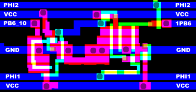

21) PB6 falling edge detector
Not much to say:
A fully static transparent latch taps into the PB6 input circuitry
for sampling PB6# during PHI1.
The latch is located North from "22) shift register control".
The output of said latch feeds an edge detector built from dynamic latches.
It emits the high_active PB6_10 signal during PHI2 after there was a falling edge on PB6.
The edge detector is located South from "22) shift register control".
PB6_10 goes into "15a) Timer 2 low",
Timer 2 then counts down one step after a PB6 falling edge if ACR5=1.
//Timer 2 counts down with PHI2 if ACR5=0, ignoring PB6.
Not much to say:
