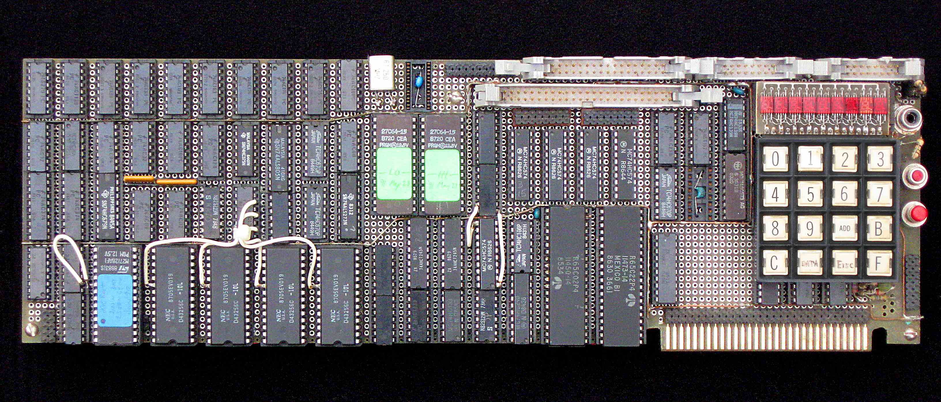

Hi everyone. Yes a 65C02 computer with hardware that accelerates Forth, including a new addressing mode and a very fast, one-byte NEXT instruction:
Not for sale, unfortunately - it's a homebuilt. But very obviously Forth related; hence the post under this topic.
I'm new to this forum and am pleased to become part of your group!
Edit: add a photo of the board. Change link to point to the one-page Short Summary
Edit2: add another photo and the register diagram. BTW, to find specific info (also the photo gallery! :) ) please refer to the Contents and Appendices links here.
File comment: KK with its keyboard, monitor and separate floppy-disk system

File comment: the KK circuit board

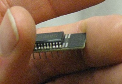

I plan to use my wire-wrap PLCC sockets for the next computer, if I ever get around to building it. They take quite a bit less board space than DIPs, and the 65c02 and '816 have more power and ground pins in PLCC than DIP, and the connections are shorter, making for less inductance, making the part more suitable for higher speeds. Unfortunately I don't find any sources of WW PLCC sockets anymore, but I have my little cache here. They are like conventional thru-hole PLCC sockets but the leads are .025" square posts and come down farther, suitable for wire-wrapping. The pins are arranged like a pin grid array. These are not the huge PLCC-to-DIP adapters. SOICs and PQFPs are pretty easy to solder by hand, but it looks like WDC stopped supplying their parts in PQFP.

I was following my own train of thought there, concerning an upgrade to an 80's micro. I'm not ready to solder surface mount devices
Upgrading an 80s micro? Are there posts I can read re: this project?

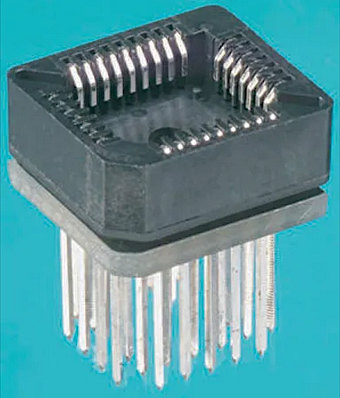

I too cringe at the thought of building with the tiny SMD packages, but they're available and they have advantages, as Garth mentioned.
I've done well by soldering to these adapter boards by Aries Electronics (see photo) which can THEN plug into a wire-wrap socket. There are SOIC, PLCC, QFP... Still a dicey soldering job, but greatly aided by unimpeded access from all directions. [DigiKey lists them in Product Index -> Prototyping, Fabrication -> Adapters, breakout boards]
