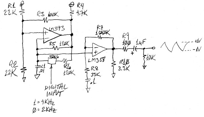

I thought I had posted this recently, but I can't find it now. Here's one version of how the modulator part of "modem" can be done (again literally a back-of-the-envelope sketch):
Adjust R5 and R6 to get the frequencies you want.  You'll probably want to replace the LM393 section with an LM358 section, and leave out R4.  I drew this up quickly for Chad, and he had a spare '393 section available.  The change in frequency is asynchronous and may happen at any point in the wave; but there are no discontinuities.  It's just that the speed at which the progress is made changes, from wherever it is, with no glitches, because we're connecting and disconnecting a resistor, not a capacitor that may have charge left in it from before.  When you demodulate it with the circuit in my first reply, there will be a little jitter, ie, "rattling" of where the edge is, but at 300 baud and the lowest frequency being approximately 1200Hz, the jitter is not enough to cause errors.  The inexactness of where the edge comes is not cumulative.  I've run these circuits for probably hundreds of thousands of bytes in my testing around 1986 or '7, and there were no errors.  When I tried double the baud rate (600 baud) with the same frequencies, I got an error about every 600 bytes on average, IIRC.  The frequencies do not need to be nice multiples of each other (I think I used 1200Hz and 3000Hz, and rather inexact), nor do they need to be an exact multiple of the baud rate.  UARTs will start their clock at the leading edge of the start bit, and then simpler UARTs will sample each bit in the middle of the bit time, well away from the range of jitter.  The '51, IIRC, takes 16 samples throughout the bit time, and "takes a vote," which helps remedy noise.  Here's an illustration of the jitter.  The top waveform is what went into the modulator, and the bottom is what comes out of the demodulator after the signal has been recorded on tape and played back:
(The $55 may look backwards; but remember UARTs go lsb first.)  The exact frequencies and their exact relationship to each other simply don't matter.
