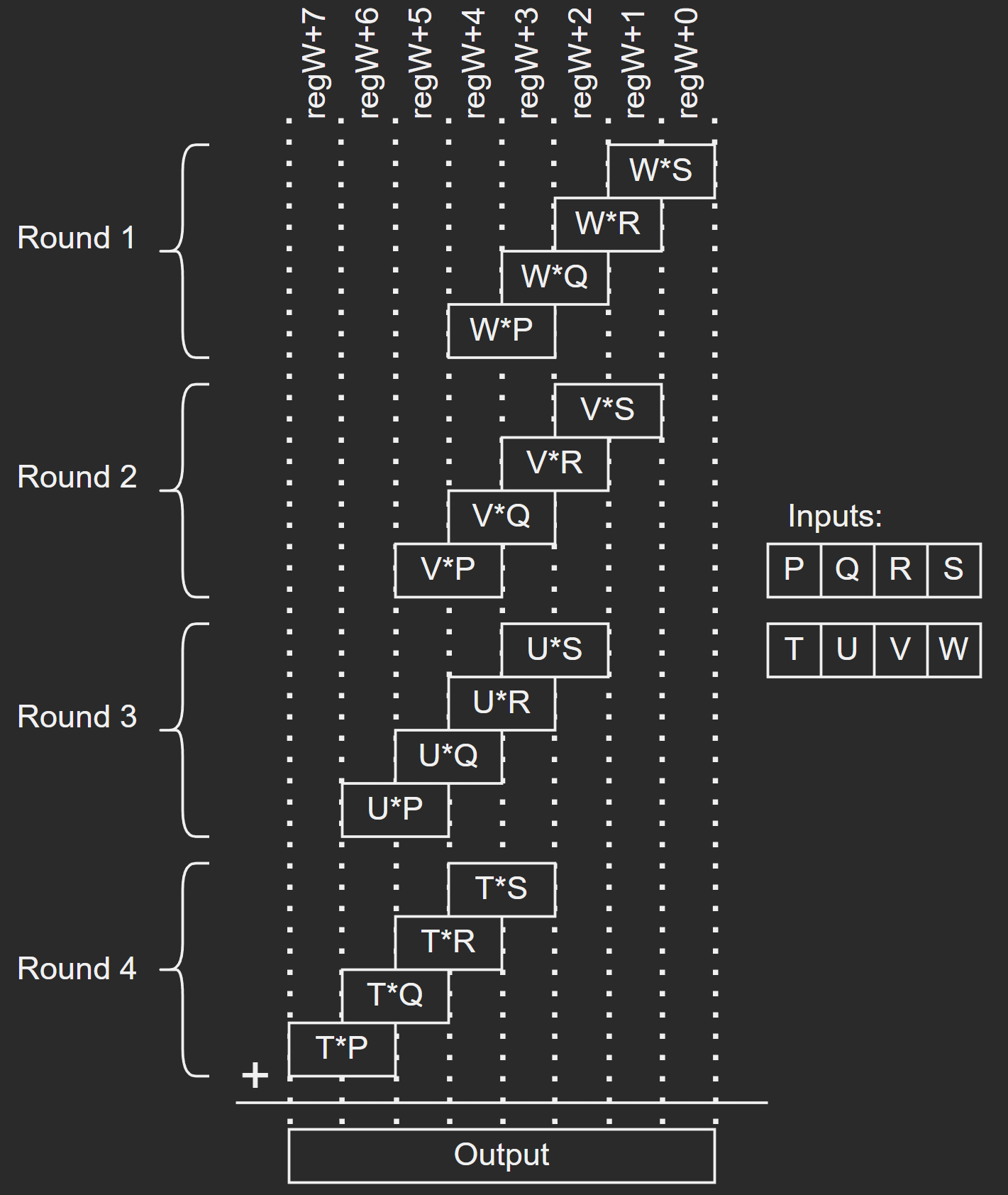

so you just split the input numbers into "x" sized chunks, multiply each part of the first number with each part of the second number, and then add them together somehow.
but could you be more specific about how you shift them "correctly" before adding them to the final result? does the amount you shift depend on the width of the MUL operation or the input values?
from what i can see in drogon's code, each round adds (without carry) to the final result and also each round gets shifted by one additional byte in the result. so each addition to the result overlaps by 1 byte...
except the last operation writes outside of the regW vairable by 1 byte (16 bit STA to regW+3 writes to regW+3 and regW+4), is that intentional or am i mis-reading the code?

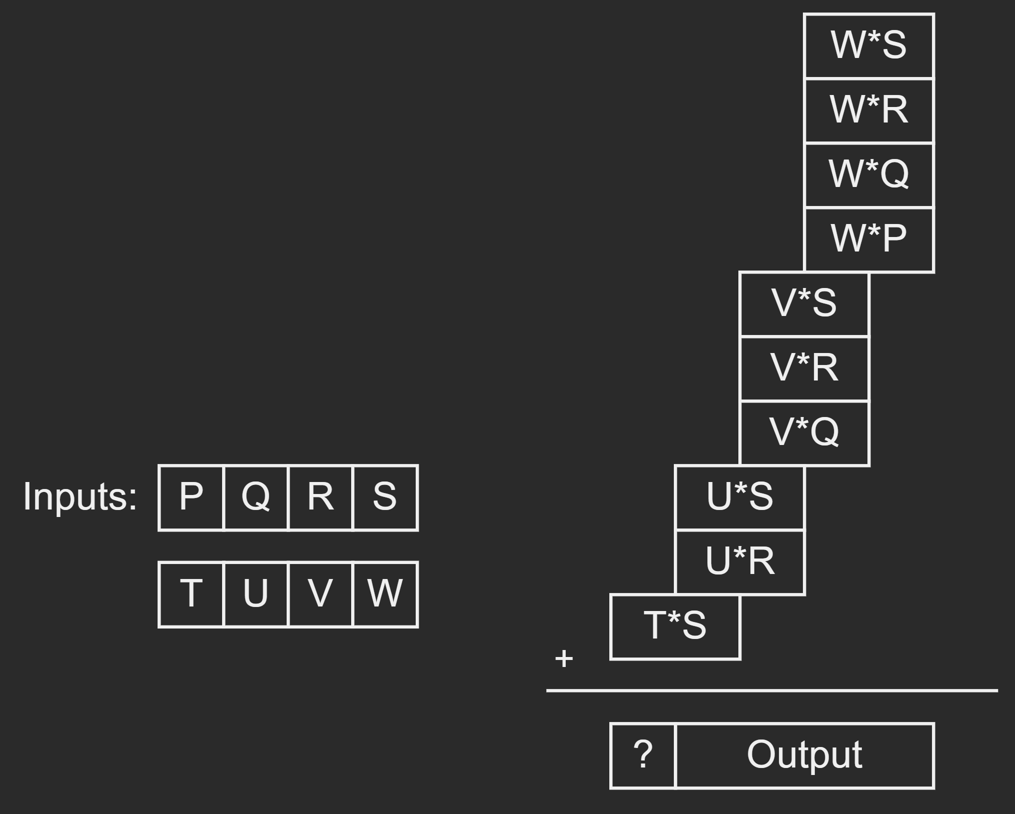

i tried to make a small diagram to better understand what is happening, is this correct for drogon's code?
(i used https://app.diagrams.net/ in case anyone was wondering. it's very useful to just quickly throw together something and have it looking "good enough")

regW here is 64-bits wide - that code is "optimised" for a 32x32 multiply to give a 32-bit result, so it's truncating the last (overflow/carry) byte.
The way it works is the same as my school-days long multiplication, so there it was Hundreds, Tens and Units, Here it's er. bytes. (as I have a "hardware" 8x8 lookup table multiplier)
; 32-32 multiply of
;               P  Q  R  S
;             x T  U  V  W
PQRS and TUVW are 32-bit hex numbers - with each 'digit' being $00 through $FF, so it might be: $12345678 where P = $12, Q = $34, R = $56 and S = $78. (ie. each letter is a byte)
Here I start with 'regW' being all zeros. Multiply P Q R S with W and put the result into regW, so
regW[0] = W * S
regW[1] = W * R + carry
regW[2] = W * Q + carry
regW[3] = W * P + carry
The next line, er move up a place, like putting a zero down under the S,W column, here it's a byte to the left.
regW[1] = regW[1] + V * S
regW[2] = regW[2] + V * R + carry
regW[3] = regW[3] + V * Q + carry
At this point, in that code, I abandon the final step as it doesn't contribute to a 32-bit result, but if I needed the 64-bit result, I'd do the last stage:
regW[4] = regW[4] + V * P + carry (noting that the add would be redundant, but I use a macro and I zero'd regW to start with)
And so on.
This: https://www.mathsisfun.com/numbers/mult ... -long.html has a sort of animated version of decimal long multiplication, rather then decimal digits 0-9 we're using hex numbers 0-255.
I think your diagram is on it's side.

no it's right side up, it's supposed to be regular addition with the line and plus sign at the bottom, each square represents a byte, so the 1x2 rectangles are the 16-bit results from the 8x8 multiplication of the 2 values inside of them. and the 1x4 rectangle at the bottom is the 32-bit output.
but it was still wrong, so i adjusted it and also added some "byte lines" and specified the "rounds" to hopefully make it a bit clearer.
so i assume a full 64-bit result version would look like this (ie the same but without the truncated multiplication "rounds"):

Ah right - that's it. I sum as we go along while 'traditionally' you'd do all the sums at the end.
In my case I'm actually doing an unsigned multiply - I check both numbers and make them both positive at the start, then adjust the sign at the end, so it's really a 31x31-bit multiply returning a 63-bit result.
I've also no idea if this is the fastest way, but it beat all the other methods I tried in that thread I posted earlier - and if I had 1MB of RAM in my Ruby816 board I'd probably have kept using it, but as it only has 512KB, sacrificing 128KB was a bit much as left little space for the BCPL compiler to run ... but a hardware 8x8 multiplier & divider might be nice...
