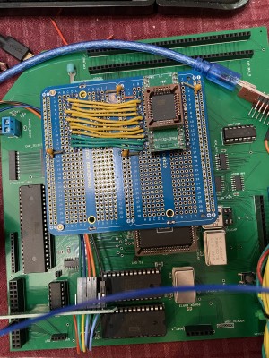

Hey, so I just wanted to post an update on this. I got the W65C265 system up to 8mhz, by making a slap-dash adapted that let me replace the EEPROM with a much faster SST39SF010A-55 NOR Flash. (bottom pic, overhead view).
I used the same trick for a second-processor card I made for the PIB, with a 65C02 clocked at just over 14mhz. I can offload programs there and use it as an application processor, with the 65C265 doing I/O. (middle Pic)
I also built another board for the PIB, a PIC18F47K40 PIB board that let's the 65C265 use that processor and all of its peripherals (first pic), as well as 512kbits of serial SRAM the 65C265 can access.
Now it's time to write some software!
Jon
PS I have some transputers, StrongARMs, and other bits of tech on the way to integrate and tinker with!
PPS Sorry for the crappy pics!

PostPosted: Thu May 26, 2022 11:36 am
Posts: 311
Location: A magnetic field
Jmstein7 on Mon 11 Apr 2022 wrote:
I can't get FCLK over 6mhz.
I have a horrible feeling that W65C265 has 150ns EEPROM. I hoped that a surface mount package with multiple power and ground pins could be easily clocked beyond 20MHz. This may remain possible but it would require any ROM access (including vectors) to be clock stretched.
PostPosted: Thu May 26, 2022 3:29 pm
Joined: Sun May 30, 2021 2:16 am
Posts: 374
Your feeling was correct. I now have 55ns external flash ROM, and I can get the W65C265 up over 8mhz. EEPROMs are a pretty terrible hinderance.
