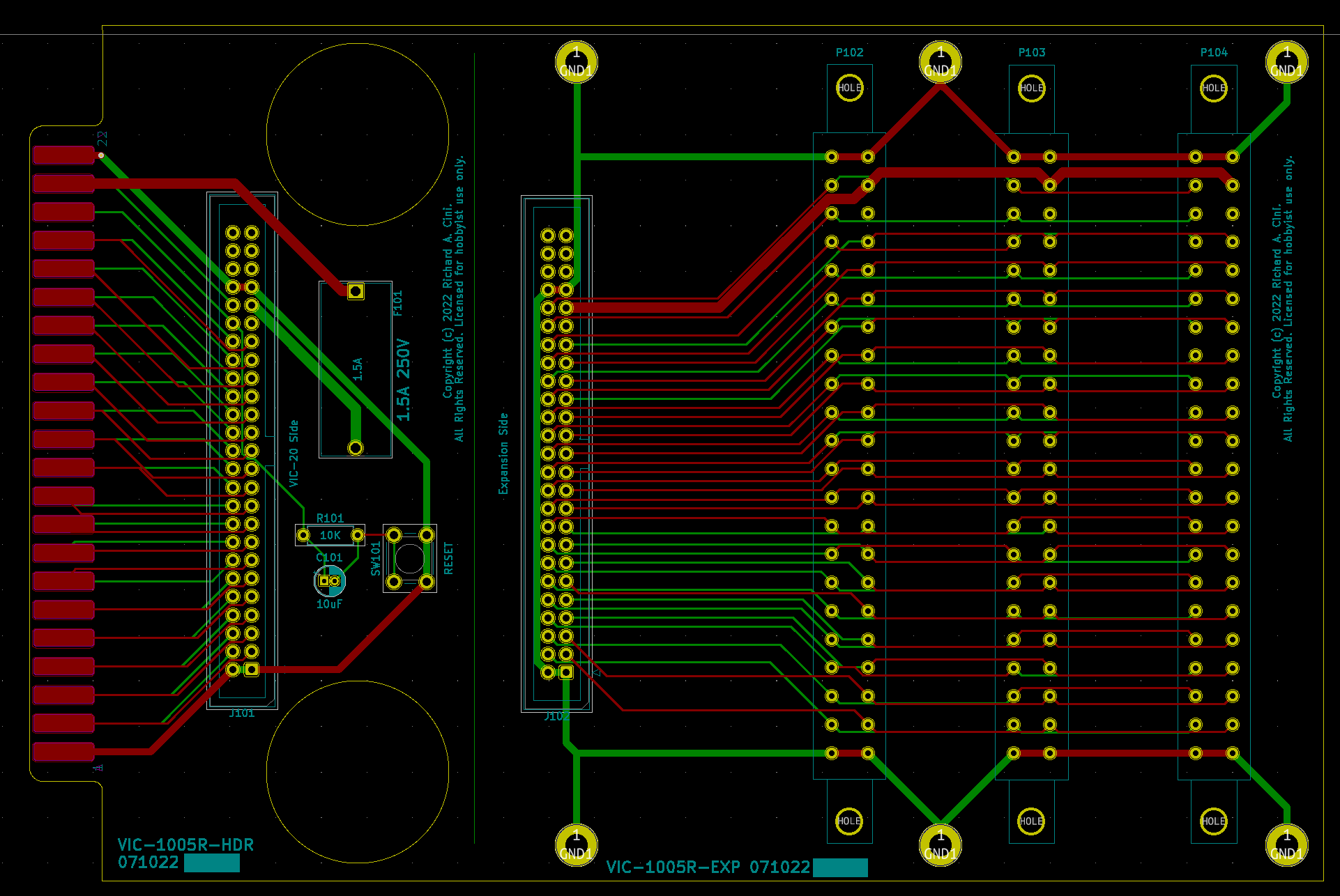

More projects being worked on (untested as of now; files on my Github repro):
VIC-1214 speech synthesizer. I can't find any info on the original, so I used the number for my re-do of an SP0256-AL2 based board I made in 1981. While it has edge fingers, it's designed to solder an EDAC edge connector to it.
VIC-1005 3-slot expansion board. Uses separate header from backplane to accommodate vertical cartridges.
Enjoy
