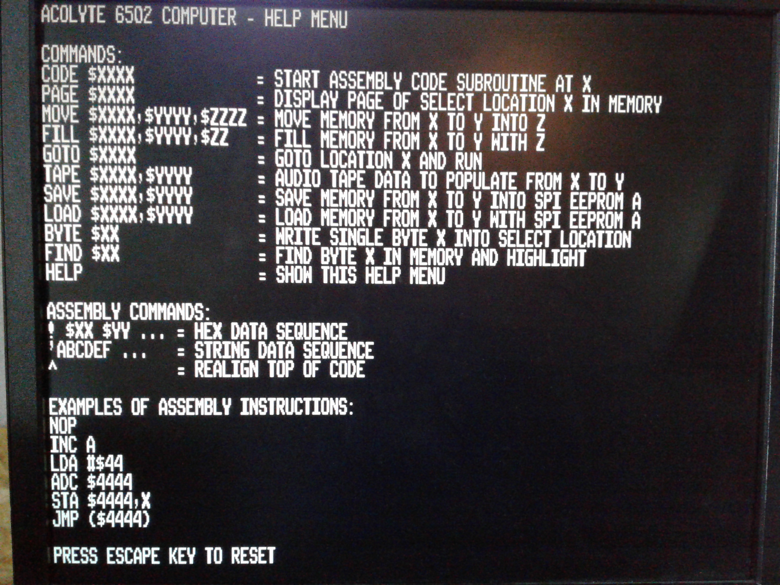

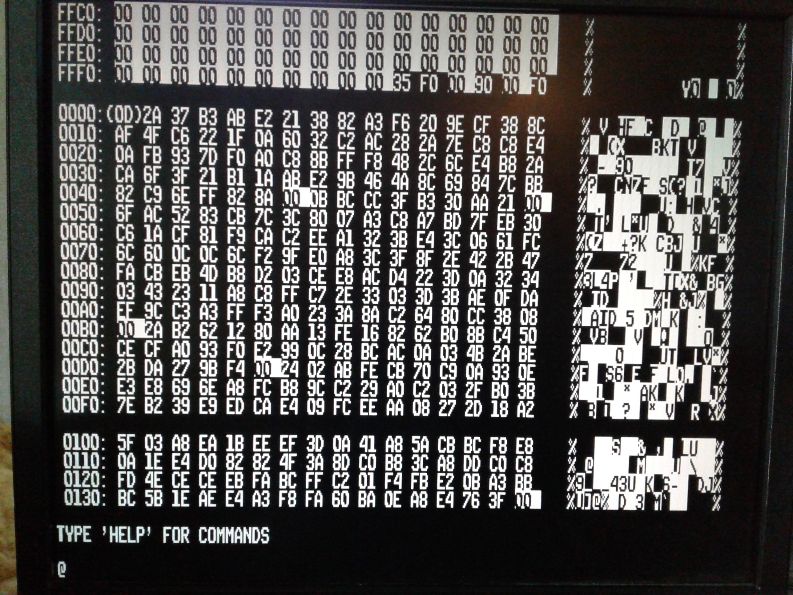

Attached is some pictures of what I did to modify it to what BDD was talking about. I like it! But I am now being tempted to fill up that right side of the screen again!!!
Ah, yes. Much more readable. For a little coding exercise, you could add to the memory dump to also display the bytes as ASCII characters, as well as hex. I've found that useful many times during debugging sessions. You can see that in the Supermon 816 memory dump.
You need to resist that temptation to fill the screen with “stuff.” The more you put there, especially if unrelated, the more likely you will misinterpret something at some point and drive yourself nuts. A machine language monitor is, by nature, a very low-level look into what the computer is doing. If you have to get into the M/L monitor to debug a program (I've often referred to that as “running down into the basement to check the furnace”), you will want to limit the volume of information on the screen to whatever it is relevant to the task on which you are working.
