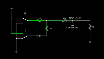

Edit - to elaborate a bit on what I suggested before, if you are using a similar RGBI circuit then adding three diodes in series with the 680 ohm resistors will mean the intensity signal only pulls down, never up, and everything will be fully saturated. The 470 and/or 220 ohm resistors would need adjusting to still maintain full output brightness. It may also work to just add one common diode near the IC pin, risking a little crosstalk between the colour channels.

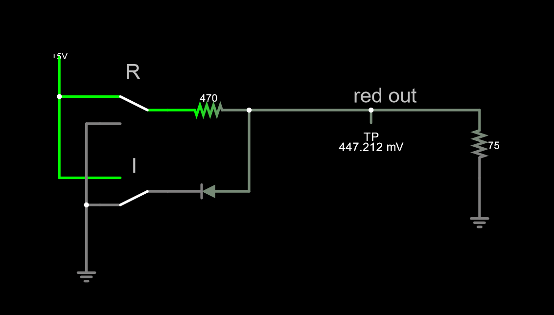

Spot on George. I tested that configuration and it is quite pleasing! I had to modify some values to accommodate for my grounding the monochrome and 4-color resistors, but the setup is a good one. I got R+I=(250,82,82) and R-I=(168,0,0). So basically a deep red and a dull pink. There is good contrast between them, and yet they both still look "red". Also the two greys are different enough from one another, and different from white and black. Thank you!
As for the diodes, I also tested that one:
https://falstad.com/circuit/circuitjs.h ... hv7dkBkGgA
And I'm finding a configuration that would supply R+I=(250,0,0) and R-I=(153,0,0). A full red and a mid red. Like you said, 'bright black' is still just black, so only 15 colors, BUT those 15 really pop!
My biggest worry is which diodes to use, based on:
1) Switching Speed
2) Resistance
3) Thresholds
I see from falstad that it would need to be able to push 1.9V through the diode, I don't know if that's a good thing or not (and I know I'm not using correct terminology here, I'm new, forgive me). Also the resistance the diode has must also be considered, as the diode circuit is much more sensitive to these values.
I have some signal switching diodes at the house. I definitely want to breadboard this to make sure there is enough of this and that to make it work. Any particular suggestions for which diodes would work best for this application? I haven't worked with diodes very much so far.
Thank you all! Good discussion!
Chad
EDIT:
I attached a picture of the two different palettes. The top one is resistors only, the bottom one is using the diodes also.
I don't really understand the circuit with all the switches, but great if it works!
1) Switching Speed
2) Resistance
3) Thresholds
I haven't put these diodes in before so I'm not sure, and don't know much about choosing diodes. I might experiment a little later, it'd be a good excuse to get my electronics stuff set up again!
But you're right, you'd need to choose well. Generally the diode will have a fairly specific voltage drop. One option here is to go very simple and just make a regular voltage divider for each channel, but also connect each output to the intensity input through a diode with a low voltage drop, e.g. 0.3V (note this is lower than you get from most silicon diodes). This means that your high-intensity output will be at 0.7V, and your low-intensity output will be 0.3V lower, i.e. 0.4V. This would probably look quite good - a little too dark perhaps. Here's an example of that:
https://falstad.com/circuit/circuitjs.h ... FIJs0s+iAA
File comment: minimal
Another option is to do the diode bit at a higher voltage range, then divide down again afterwards. My old circuit kind of already does that by having the extra 220 ohm resistors before the output goes to the monitor. In this case you can use a diode with a higher voltage drop and still get a good result like this:
https://falstad.com/circuit/circuitjs.h ... kxCNJvmwgA
File comment: more resistors
I can't vouch for this being a good idea though, and you will need diodes that can switch fully at the right frequency.

gfoot wrote:
The attachment circuit-20220428-1803.png is no longer available
The attachment circuit-20220428-1803(1).png is no longer available
Looks great George, thank you. Yes, that's what I'm thinking about. I'm still debating if I should go with all resistors (your previous model) or the one with diodes (this model). I also experimented with RRGB 4-bit colors, and what that would look like using GIMP. I really like that one, it gives a REALLY nice variety, but it doesn't have grey, so... take some, lose some.

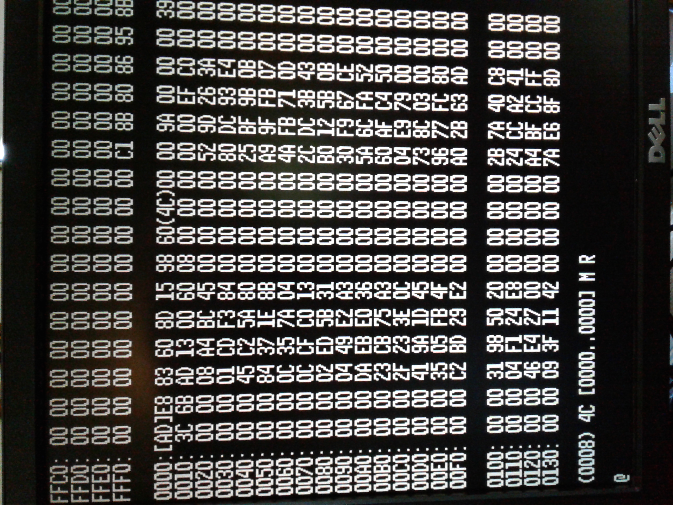

Attached is my new Monitor demo! And the requisite picture of course.
It is a funny little thing, not optimized at all. Simple commands:
(XXXX) changes the 'cursor' location
[XXXX..YYYY] changes the 'selection' locations
XX YY ZZ writes hex values into memory, starting at the cursor location
M moves memory from the selection area to the cursor location and beyond
R runs (rather, it JMP's) to the cursor location
You can get really funky with it too, with weird commands like:
[80.81(40]FFMR
I don't know exactly why someone would want to do something like that, but it is possible I suppose :) The idea is that it doesn't "break" if you put weird things in there, it just does its thing.
You can also use the arrow keys to move the cursor around, and the page up/down keys to, well, move the current page.
It is VERY slow because I basically re-draw the entire screen each time I move or hit enter. There are ways to make it faster, but I just don't care to do that for this initial demo.
I would eventually like to add Assembly commands, and De-assembly of course. But first, I want to add:

PostPosted: Fri Apr 29, 2022 5:07 pm
Posts: 713

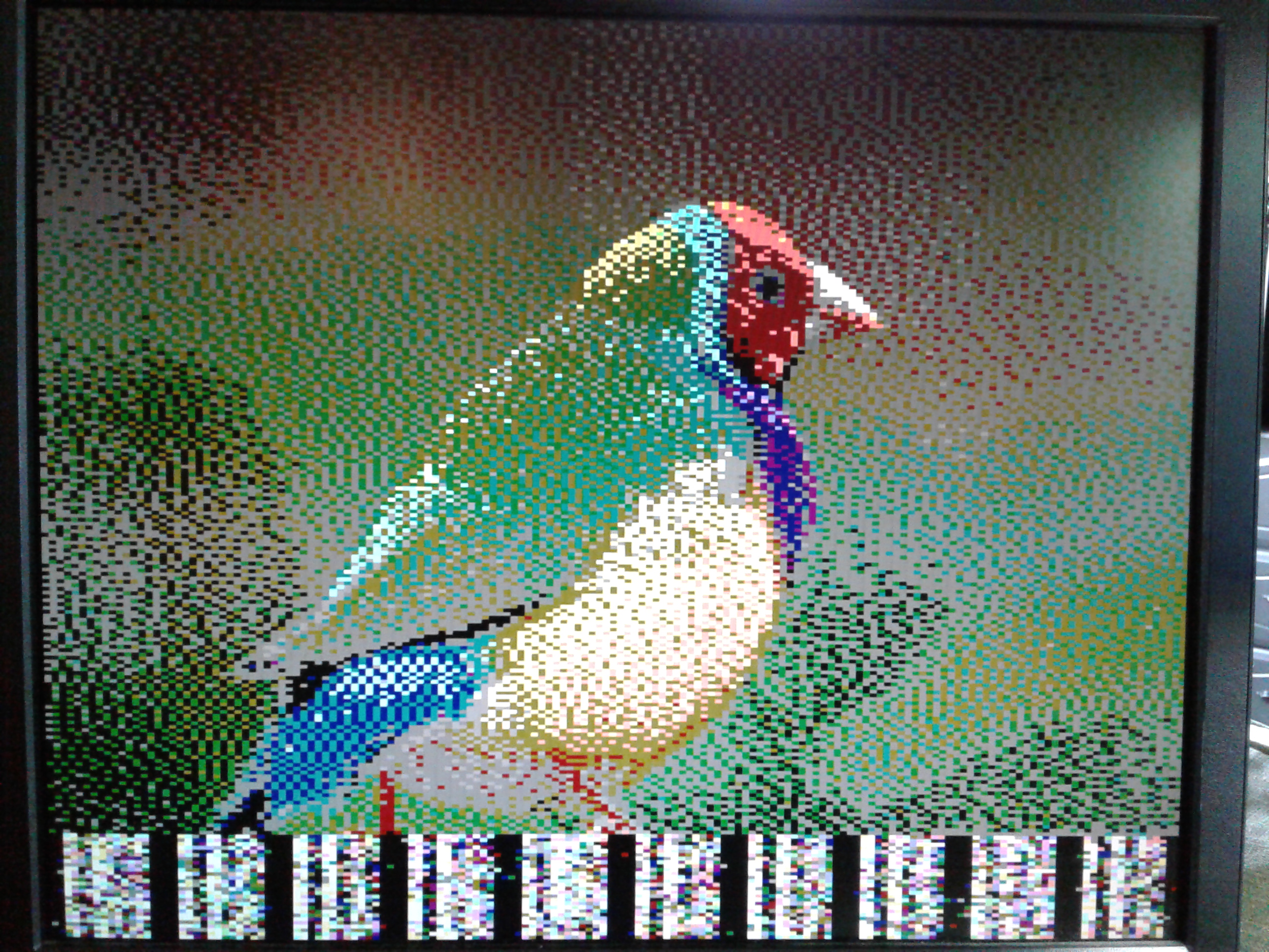

Attached is the latest Monitor program, it now includes "L" command, to Load from 'cassette' audio input.
So I converted the bird data into a binary file, then changed my 'AudioPacket.cpp' program to take a file instead of my hand-typing everything.
It took the computer (no lie) 4 hours to convert 30K into a .wav file that is 53 MB in size. Wow. I even made optimizations to the code to speed it up!
I typed this command on the monitor:
[0600..7000] L
(C000) R
I have a little "copy RAM to VGA" program at $C000 btw.
Then I hit play on the desktop. It is a 4 min 30 sec audio file, but I only loaded 4 minutes of it. And as you can see, it came out beautifully. I recalculated everything, and it seems to be an 888 baud rate, because I'm technically sending 9 bits in duration for each byte of data. I know this is no way shows it's accuracy, but I've been testing that manually along the way.
I do have to say one thing though: Last night I was messing with this, and I was getting BAD results. I would get random pieces of data, nothing at all as expected, the volume changed what was being read (that shouldn't happen on this circuit), and I was just confused. I put a scope to it, and everything seemed fine. I went and tested it again, and it worked. I didn't do *anything* and it was not working, then it was working. I totally blame my desktop computer, it has been acting weird with the audio line-out for some time. I just didn't know how badly it had gotten!
Next up is SPI support. I'm thinking I will code it in very similarly to this audio loading stuff. We'll see, still debating on that one.

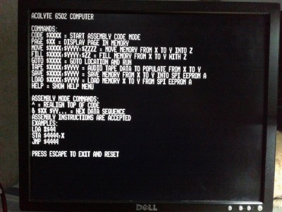

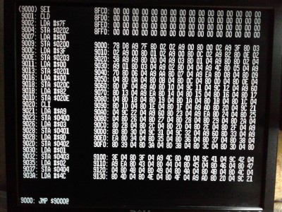

Attached is an updated Monitor program, and requisite picture.
It now has a 'full' disassembler built in! The ! command makes the start of the code happen wherever the (XXXX) cursor is currently.
It does not yet contain any zero-page instructions. Mainly because I'm lazy, but also because their addressing modes confuse me :)
I've been pondering how to do the Assembler part. I think the parsing would be easier now that I know how these addressing modes kind of function. My biggest issue is: How do I display an error? Currently there is never any errors, it just ignores things that are weird or incomplete. But obviously there could be wild errors when actually typing Assembly. Do I ignore only that instruction? How do I know if the next one is ok or not? How will I know if I messed up while coding? Lots of issues besides just parsing.
I also plan on adding a ? command that displays a helpful guide on how to use this program. Would be nice built in!
Thanks everyone. I'm starting to make a miniature operating system here :)

Posts: 713

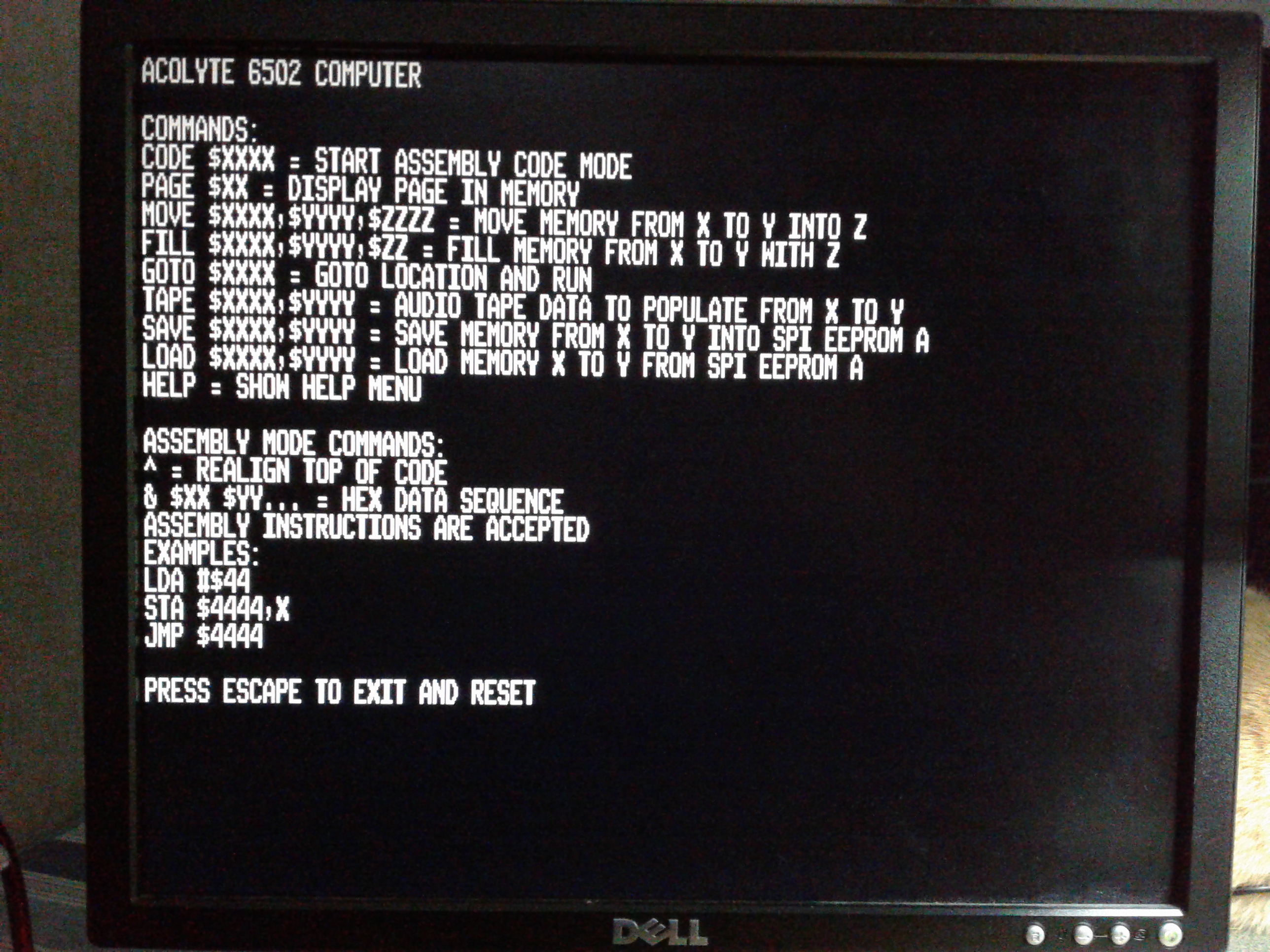

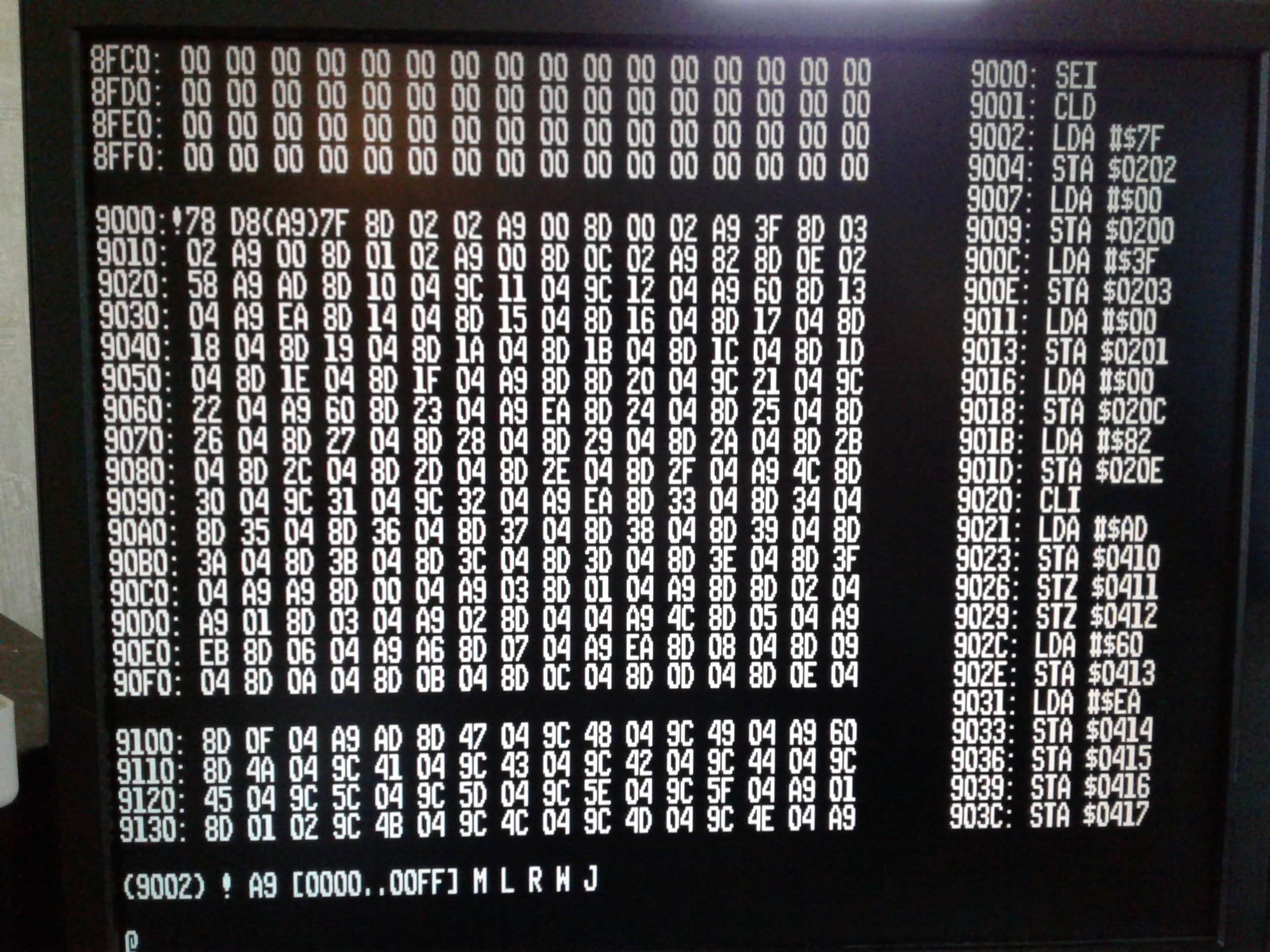

After a bit of helpful critiquing here:
viewtopic.php?f=2&t=7110
I'm back to present a MUCH better 'monitor'. I don't know if I'd call it a monitor at this point though. It is closing in on an 'operating system', maybe just an 'assembler', definitely a replacement for BASIC.
I switched the Disassembler to the left side where it is more important. I removed all that 'cursor' and 'selection' stuff for the memory, instead going with straight 4-letter commands that expect addresses and stuff later.
I took hints from SMON (https://www.c64-wiki.com/wiki/SMON) and others for the Assembler mode. It's not a copy/paste at all, but it does mimic functionality. You can type Assembly code in, and it will accept wild variants as well. For example: LDA#44 will work just as well as LDA #$44, and STA4444X will work just as well as STA $4444,X. So it is a flexible Assembler. You can also 'realign' the top of the code at any time, and also write out a sequence of hex bytes. Because the code and memory are drawn independently, this speeds up coding a LOT.
Any zero-page assembly and disassembly functions are still not included at this point. That will come later.
There are currently no 'find' or 'hunt' or 'compare' commands, mainly because that would have to return a value to the user, and I'm not exactly sure how I want to display that at this time. The command HELP shows all that I currently have available.
Creating the Assembler code was actually VERY easy, once I had a good idea of what to do. Sometimes I type code at work in Notepad, and because I can't test it, I have to be very careful, and go through it a few times before I'm happy. Then I come home, and it mercifully works nearly every time! At least it works enough. :)
The attached code is NOT YET COMMENTED. It's still a work in progress, I'm only including it for posterity sake.
Thanks everyone!
Chad
AcolyteMonitor2.asm [77.67 KiB]
Downloaded 59 times

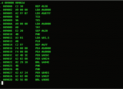

PostPosted: Fri May 06, 2022 6:23 pm
Posts: 8402

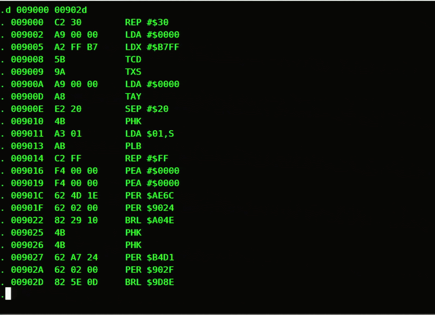

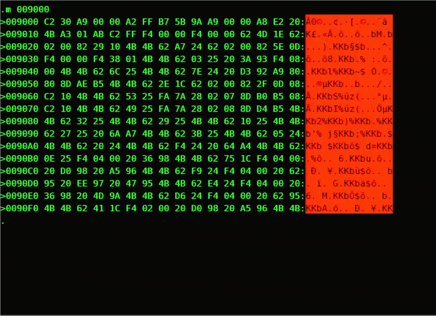

I dunno...the screen seems to be awfully busy. Being used to a “traditional” 6502-ish monitor, (Supermon and its derivatives), I think you are trying to cram too much info on the screen, possibly creating a “forest vs. trees” situation. A memory dump is not necessarily machine code, hence I’m not sure what it is I’m supposed to be seeing in your display. How it functions and looks is up to you, of course, but I’d keep the two separate, such as these screen captures from Supermon 816.
File comment: Code Disassembly
File comment: Memory Dump
