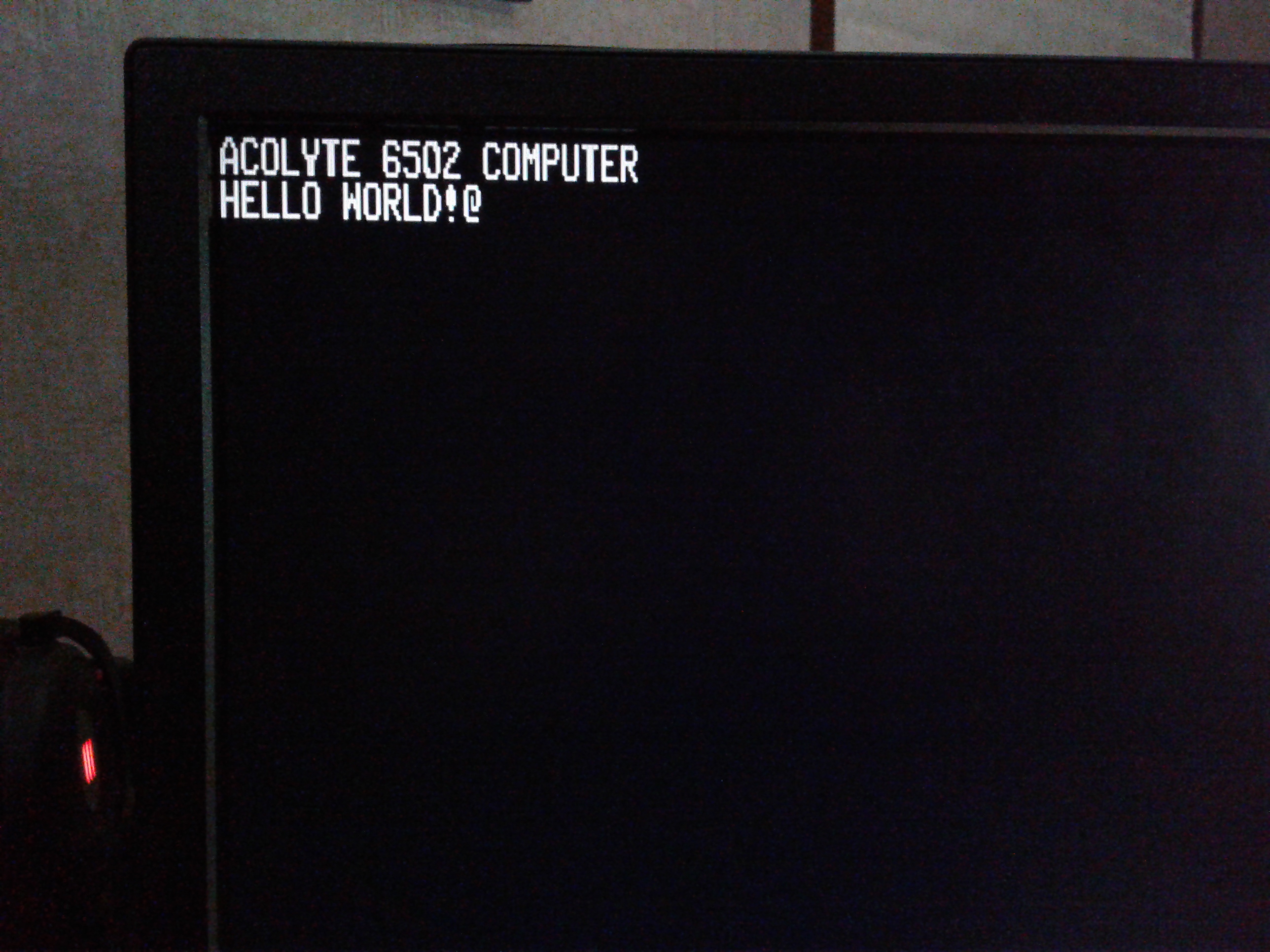

Introducing the Acolyte "Homebrew" 6502 Computer with VGA capability!
The 6502 processor is running at 3.14 MHz. It has 32K RAM (expandable up to 80K) and 32K ROM (expandable up to 128K).
VGA modes include:
640x240 monochrome
320x240 4-color
160x240 16-color
Look at my Gouldian Finch now! :) Also, the monochrome text looks great!
Attached are some pictures from some demo code I have been working on for the past couple of weeks. The bird came out great, the text looks good, BUT:

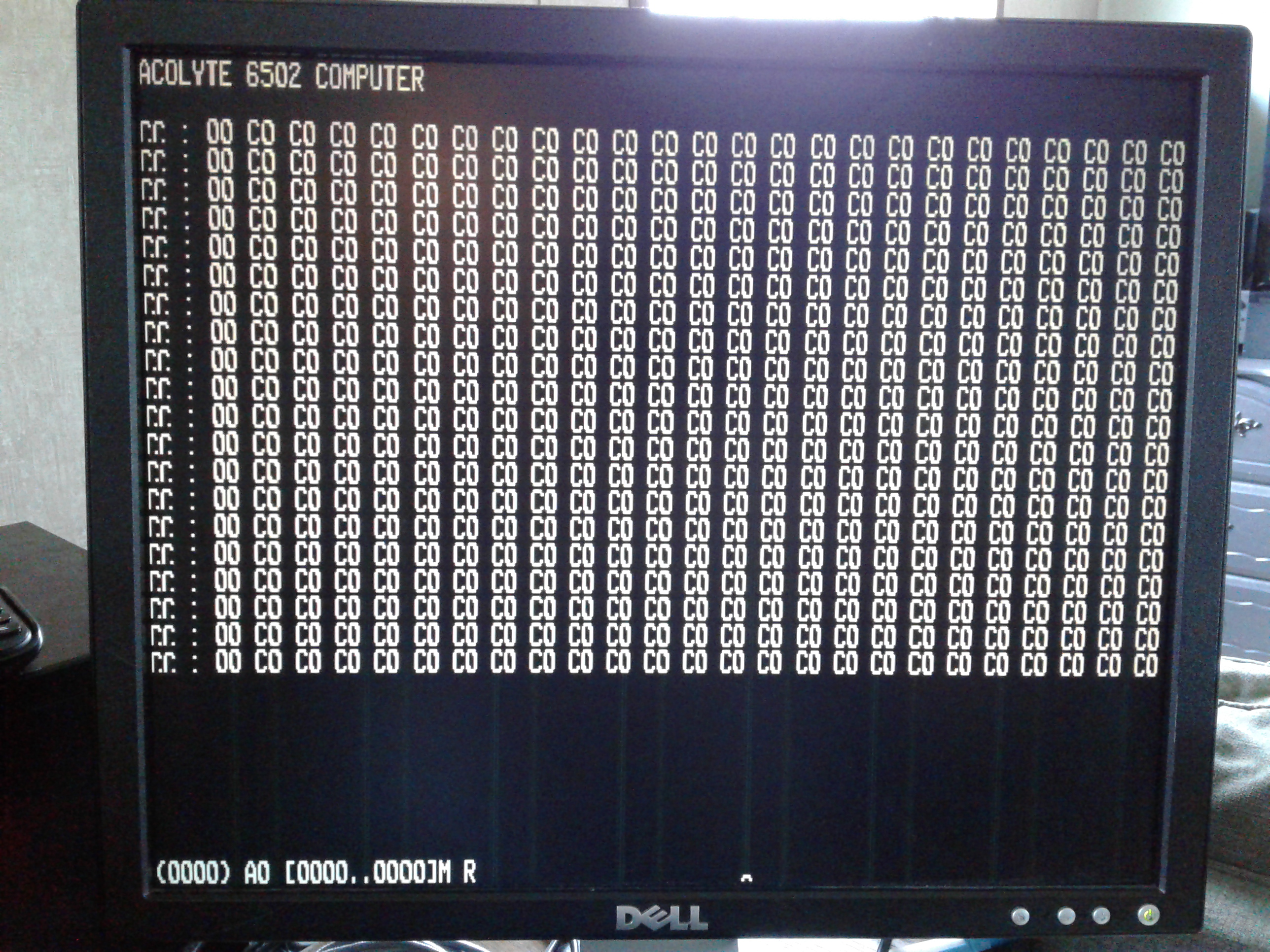

1) My ML monitor is not exactly 'correct' yet. Now that I can test my code, I'm sure it will look better soon. A good start though!
2) My bird is blue tinted, and a bit dim. I was sure I got my resistor values right. Hm...

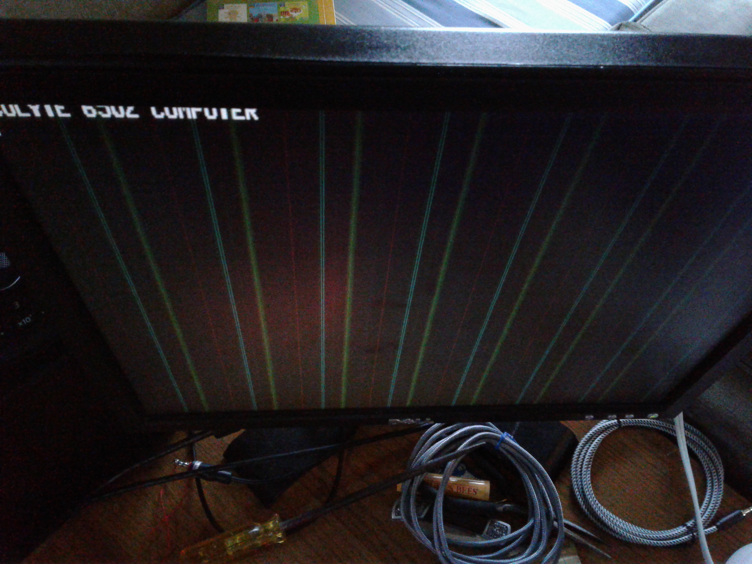

3) Lastly, there are these thin green lines at specific intervals. They occur even when I have no ROM plugged in, so it seems to be a hardware issue. I'll be checking into that first. If any of you have seen this behavior before, please tell me what you know!
Whelp, there we have it! A good start to a new project. And more to come soon. Thanks everyone!

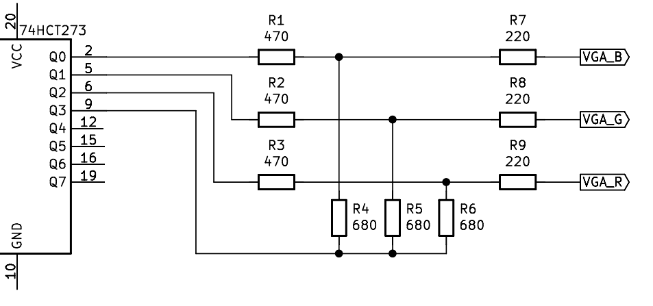

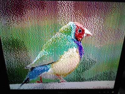

Attached is the new 16-color bird. And it's just as expected now. It is no longer blue tinted. Why was it blue???
Well... My schematic connected these 3 resistors together. My board layout connects these 3 resistors. I grabbed a blank printed board and they connected these 3 resistors. BUT on the board I was soldering... they were not connected. I mean, I *could* have sliced through it somehow. Somehow? Or burned through it? I don't know, SO weird.
Has this sort of thing ever happened to you? As in, the board manufacturer doesn't have 100% guarantee or something? So strange, never had an issue in the past. It *could* have been me, but that would be strange unto itself!
Lastly, I connected it to another monitor, and I got DIFFERENT lines. Still green (there are some red ones in there too, you can't see at some angles), but they were almost static. All over the place, moving around. I would bend the cable, and it would change the brightness of the green lines.
So! I am convinced it is the cable's fault. Unfortunately I don't have another cable, all my equipment is at the office from Math Day. So tomorrow I will bring home the CRT and some extra cables, and see what happens there. One step at a time.

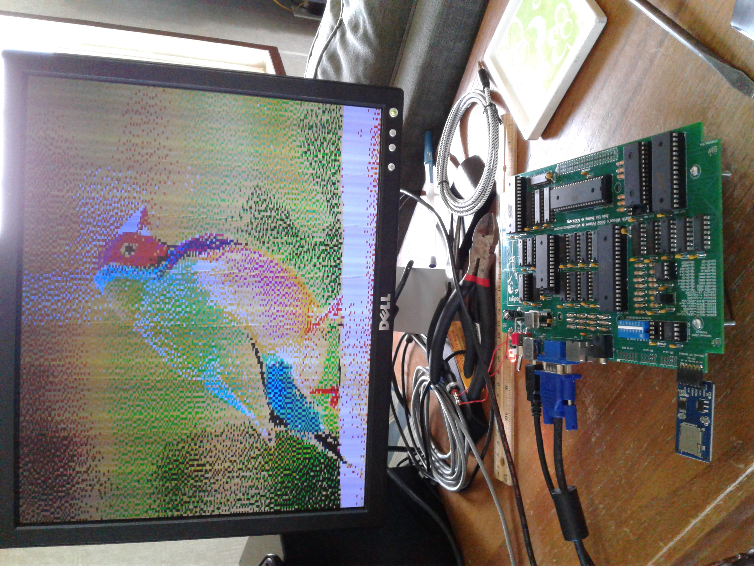

Three out of four monitors work fine.
From the bottom up:
My normal widescreen LCD monitor for my own desktop computer. Looks fine. When it's black I see a bit of fuzzy greenish stuff, but you almost have to be told it's there.
My super-huge LCD monitor, looks great, I can't see any issues at all.
My CRT monitor is perfect, spot on as always.
My little Dell LCD is... messed up. The monitor is still displaying weird lines.
The last picture is from the same Dell at a top viewing angle. You can see various colors of lines going on. They aren't moving, so...
I think this is a noise problem. Cables, monitors, etc, something isn't *perfect* so the monitors are acting differently to compensate. Some just ignore the noise, some think it's important, some just blend it in.
Attached is the 'analog' portion of the board, where the color signals are sent to the VGA connector. Should I have not put power and ground traces around this area? Because I am seeing non-moving vertical lines on the Dell monitor that it is detecting this noise at specific time intervals, thus it is involving the clock, and thus it could be when there are big transitions of bytes or something. Just speculation.
Or the Dell monitor could be broken after Math Day. I mean, all types of things happen when you transport stuff around in boxes.
Thoughts?
I'll test on another Dell LCD monitor soon. But three out of four is pretty darn good.
Thanks everyone.
Chad
EDIT:
OH darnit... I went to the Dell monitor menu, and noticed "phase" and "clock". Adjusted those, and the lines moved! Then I hit "auto adjust" and... the lines are gone. Entirely.
*sigh* Case closed. Thanks. Now onto software!
