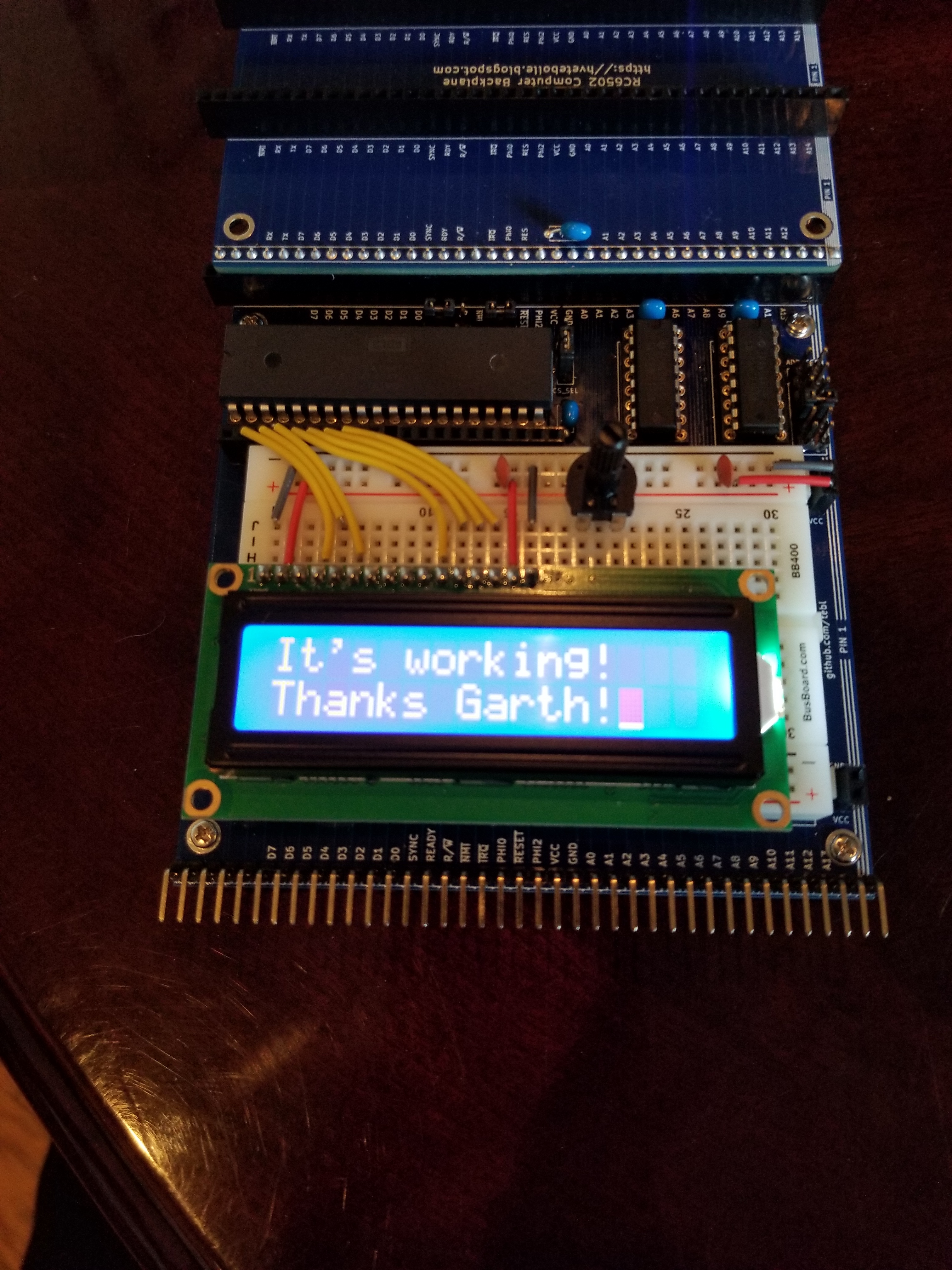

I am still having some trouble with this. I wired it up like Garth's example:
And I can verify that the '595 is working, by replacing the LCD with some LEDs, and the delay loops are long enough that I can actually see the bytes changing. I suspect the problem might have to do with this:
Be sure to leave E down after every read or write, and only change the RS and R/W bits when E is down, and never at the same time with raising or lowering E.
From an old thread.
With the control signals on bits 0 and 1 of the SR, they appear instantly, along with the nibble of data, when I pulse the 595. I am thinking that I will have to do something like this, in order to send, say 00111100 to the LCD:
High nibble send:
 0011  0000
 0011  0001 <- Enable bit
 0011  0000
Low nibble send:
 1100  0000
 1100  0001 <- Enable bit
 1100  0000
In other words, send 6 bytes per byte of data, along withe accompanying 16 clock delays for the SR. That seems like a fair bit of extra steps / delays; before I try it that way I want to make sure I have the concept right.

I guess I shouldn't have reduced it so much, losing some of the resolution and making it kind of hard to read. It's a scan of the page in the 3x5" loose-leaf ring binder quick-reference guide I keep on the workbench. It was not originally intended for anyone else's eyes.
Right. These displays have few enough characters though that it will still appear to be instant, which would not be the case if it were 132 columns of 43, 50, or 60 lines and you had to change it all at once! :) 16 clocks is only about four instructions' worth though, so the added delay to get there isn't much. Five NOPs might do it, six definitely would, or find an instruction with more cycles that doesn't do any damage, like rotate an unused RAM byte.
I did zoom in on it some, but I think it's pretty clear. Some of your pin names were different from my datasheet, but you also gave pin numbers, so I could cross reference. That made getting everything hooked up pretty straightforward.
Hah! OK, cool.
I made a subroutine called "wait_16." Levinthal says jsr is 6 clocks and rts is six clocks, so I just filled in two nops. It seems to work OK - at least my LED s blink the right bits!

Paganini wrote:
I made a subroutine called "wait_16." Leventhal says jsr is 6 clocks and rts is six clocks, so I just filled in two nops.
NOP is 2 clocks; so JSR to an RTS is 6 NOPs' time. The STA SR itself adds 4 more clocks. So
      STA  SR
      JSR  <to an empty subroutine>
      ORA  #1
      STA  SR
already gives you 18 from one write to the SR to the next, without any NOPs. However, you still need to pulse the 595's latch input after completing each byte shift. You can do the ORA #1 (for the second write, to set E true) and the AND #$FE (for the third write, to set E false again) while the shifting is being completed, before pulsing the latch input. By the time you do that, the JSR will be overkill for delay, especially if you need the accumulator for both the latching and the ORing and ANDing of what you write to the SR. Without testing, what I don't know is whether reading the SR after the shifting is completed will give you back the byte you wrote to it, such that you could do INC SR...DEC SR (since your LCD's E line is on bit 0) so you wouldn't need the accumulator for the ORing and ANDing, so it's free to use exclusively to pulse the 595's latch line after each byte shift is completed—if indeed you do need the accumulator for that. (Again, I don't know what you have it connected to.)

I did get it working using the VIA shift register... kindasorta. The shift register was working properly, latching data, etc., and the LCD would initialize, but not reliably. My particular one seems to be extra fussy about the timing loops - probably because it's a cheap Chinese knockoff. I decided to go back to using the the VIA's output port (but now in 4-bit mode) so I could check the busy flag. That's where it is now. I don't consider the serial excursion to be wasted time even though I ended up abandoning that path; I gained a good basic understanding of how to use the 6522's shift register; it seems like there are plenty of interesting things to do with it so that it's almost a waste only to use it to drive the LCD!
I do have a question about how the 'pla' instruction works though. Right now I'm doing:
pla
cmp    #$FF
bmi    etc
To check the busy flag in bit 7. I wasn't sure if the cmp instruction is necessary; it looks like pla does set the N flag, but the (exceedingly confusing) diagram in Leventhal seemed to suggest that it does it based on the value of the SP (maybe to be used for testing for stack overflows and other such errors?), not the value pulled off the stack. So, I added the cmp just to be safe.

Paganini (do you play violin?), for reliable LCD initialization, be sure to write the function set three times, and if you can't poll the busy bit, wait the prescribed amount of time after each write. Both of these are shown in my sample code at http://wilsonminesco.com/6502primer/LCDcode.asm . Most instructions take 10 HD44780 controller clock cycles to process, except the "clear display" and "home cursor" instructions which take 410. The clock is typically in the range of 100-250kHz, which puts the time per cycle in the range of 4-10µs; so 10 cycles may be as long as 100µs, and 410 cycles may be as long as 4.1ms. You should wait at least 15ms after power-up before starting the initialization procedure. Observing these delays, I've never had any timing problems, regardless of LCD brand.
PLA's flag results do reflect the contents of what you pulled off the stack, not the contents of the stack pointer.
