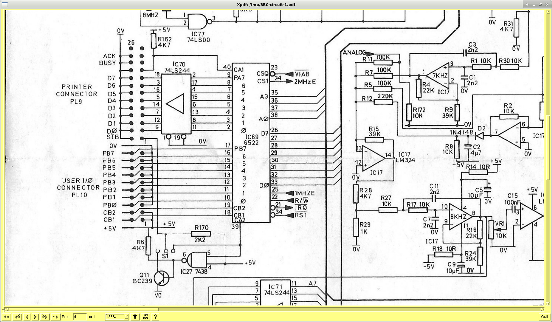

PostPosted: Wed Apr 27, 2022 8:19 am
Posts: 1488
gfoot wrote:
There is a mode where it holds one handshake line low until the remote end pulls the other one low to confirm receipt. Maybe that would have worked better for the printer you used - I think the BBC Micro did use it this way for example.
The Beeb uses Port A of one of the VIAs in a more or less standard data+strobe... wait for ack mode. I used several different printers with it, never noticed any issues - it "just worked" from what I recall.
Extract of the schematic here:
The busy signal isn't used, but the ACK from the Printer goes to CA1 and the Strobe comes from CA2.
