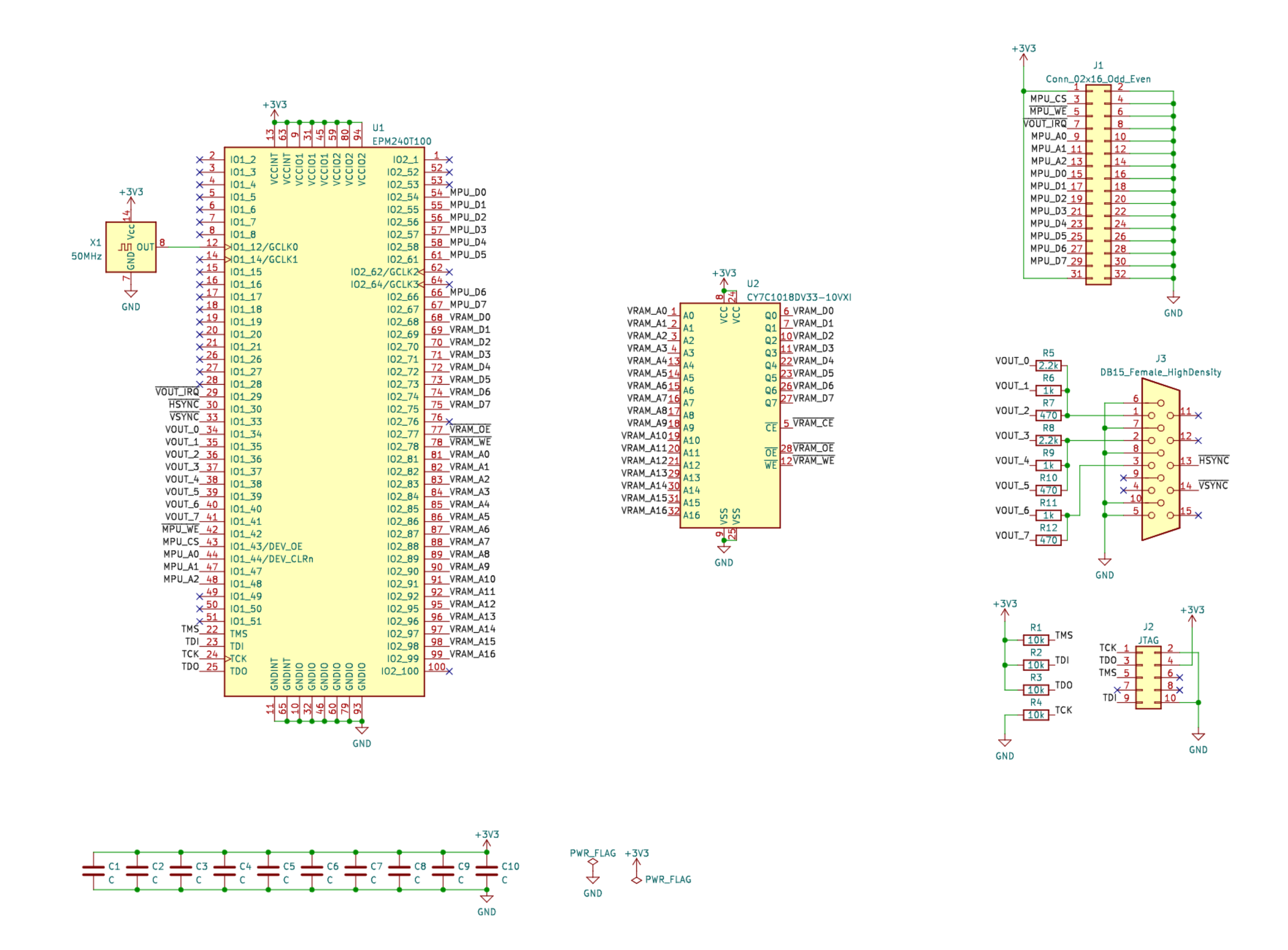

I put the entire source up on Github in case this comes in handy to anyone. The Max II is technically obsolete, but easily obtainable from AliExpress, even with all the FPGA/CPLD shortage going on, and it costs a pittance. The design leaves enough resources unused (about 15%, and roughly 20 pins) that it should be possible to use the extra room for glue logic or other applications to reduce the chip count in an SBC design.
To wit, I have ordered some PCBs from JLCPCB; the design ends up being small enough that I was able to splurge on a 4-layer board, so I'm looking forward to seeing how well that works when it gets here. In the meantime, I have built an even-worse-than-usual rats' nest using the development board:
I would love feedback on the design—I'm sure there are plenty of ways to improve it (and probably a few bugs). In particular, I couldn't get the MPU interface to work bidirectionally… if I add functionality to expose data through the bus, the CPLD always ends up picking up a bunch of garbage when a write occurs, even though I wait a full clock cycle for the signals to stabilize. This doesn't matter too much—I don't really need the read functionality at this point, but it nags me that I can't understand what I'm doing wrong, and I suspect that I may one day want to add the ability to send data back to the MPU anyway.

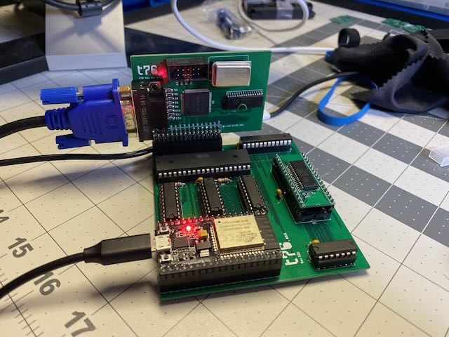

Time for a quick update: I finally got the PCB for my reference design, and it looks pretty spiffy:
Soldering the CPLD to the board was quite the adventure… the first attempt ended up releasing a bunch of magic smoke, but the second time around I took care to avoid shorts and it worked right away. I was silly enough to place the decoupling caps on the other side of the board—a mistake that I'm not going to make again, because they're a pain. Also, I think that I should make a version of the board that acts as a shield that connects to the MAX II development board, which should eliminate the need to solder SMDs altogether.
I was pretty surprised to find out that the circuit worked right away… it only needed a bodge wire because I had forgotten to force the RAM's chip select line low. It took a little doing to interface it with a version of my 6502 SBC running at 3.3V, but only because I had forgotten to qualify the chip select line with PHI2, much like you have to do when interfacing to RAM.
Once I figured that out, it worked like a charm with the 6502 running all the way up to 13MHz (at which point my SBC ceases to work for reasons that I have not yet investigated—I suspect that the video interface can handle faster clock speeds). Here it is connected with some temporary wires while I await angled pin headers from China:

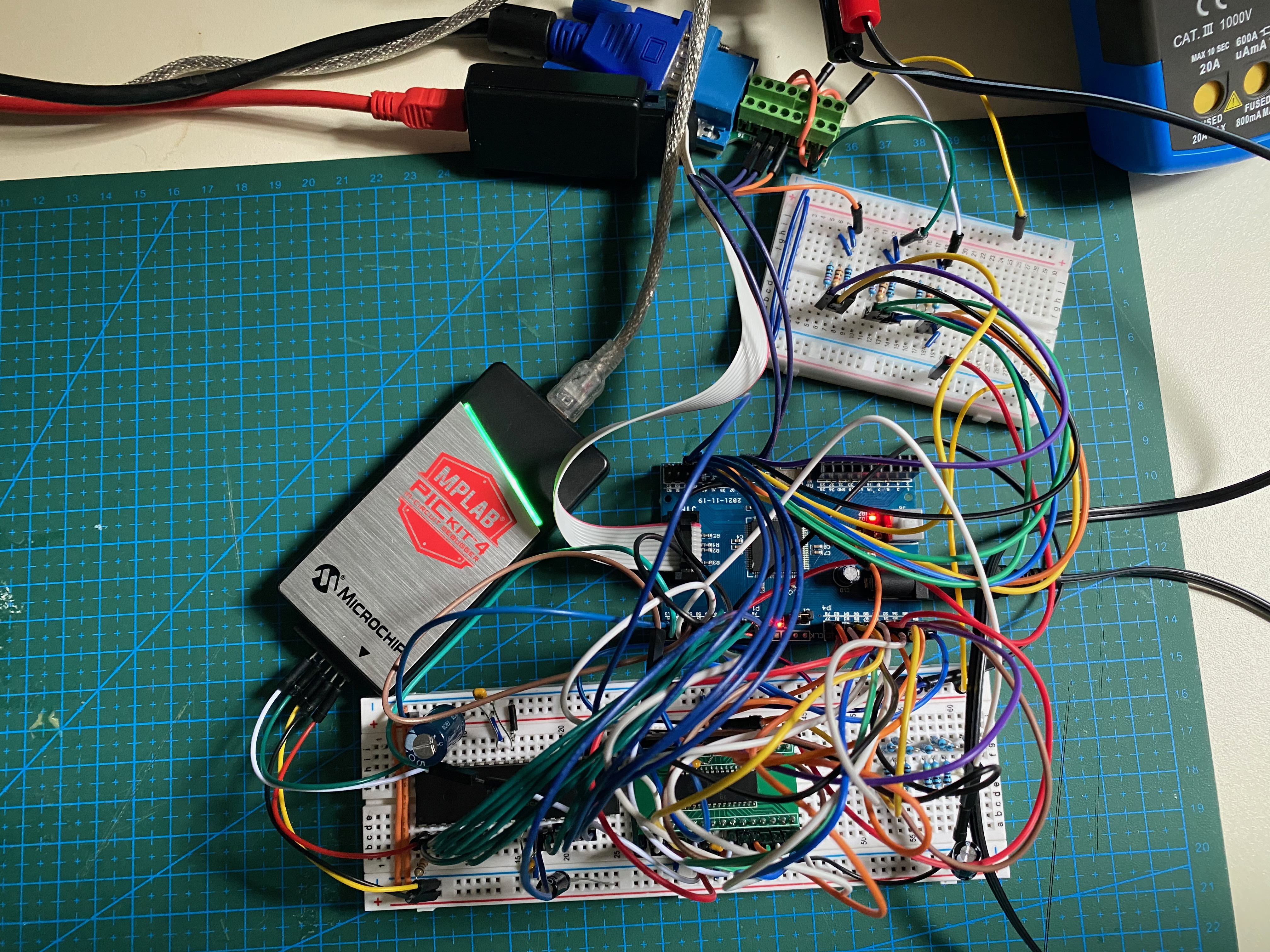

I also managed to make the interface's registers readable (previously, you could only write to them), although I have yet to bother enabling read access to the onboard video RAM.
I'll send one more update once I have a demo to show and maybe some additional functionality that I'm working on.

A final update on this project: I have added support for reading the video RAM and for blanking interval detection/interrupt. This makes the interface with the host computer bidirectional and allows for smooth animation.
I still plan to create an advanced version with a customizable palette and support for sprites, but I'm going to call this version of the project complete for now—if for no other reason that I have used all but one of the available macrocells in the CPLD :-)
The interface works really well, incidentally. I was able to test it with my SBC running all the way to 20MHz and it's nice, responsive, and completely glitch-free (though, in all fairness, my code isn't yet fully optimized).
Just for fun, here are a couple shots of the card plugged into the SBC, and some 80-column text output from the SBC to my VGA monitor, using Gordon's most excellent font (thanks again, Gordon!).
67485268540__9B2FAE27-9573-49CC-BD70-4969934E67CC.jpeg [ 88.26 KiB | Viewed 39979 times ]
