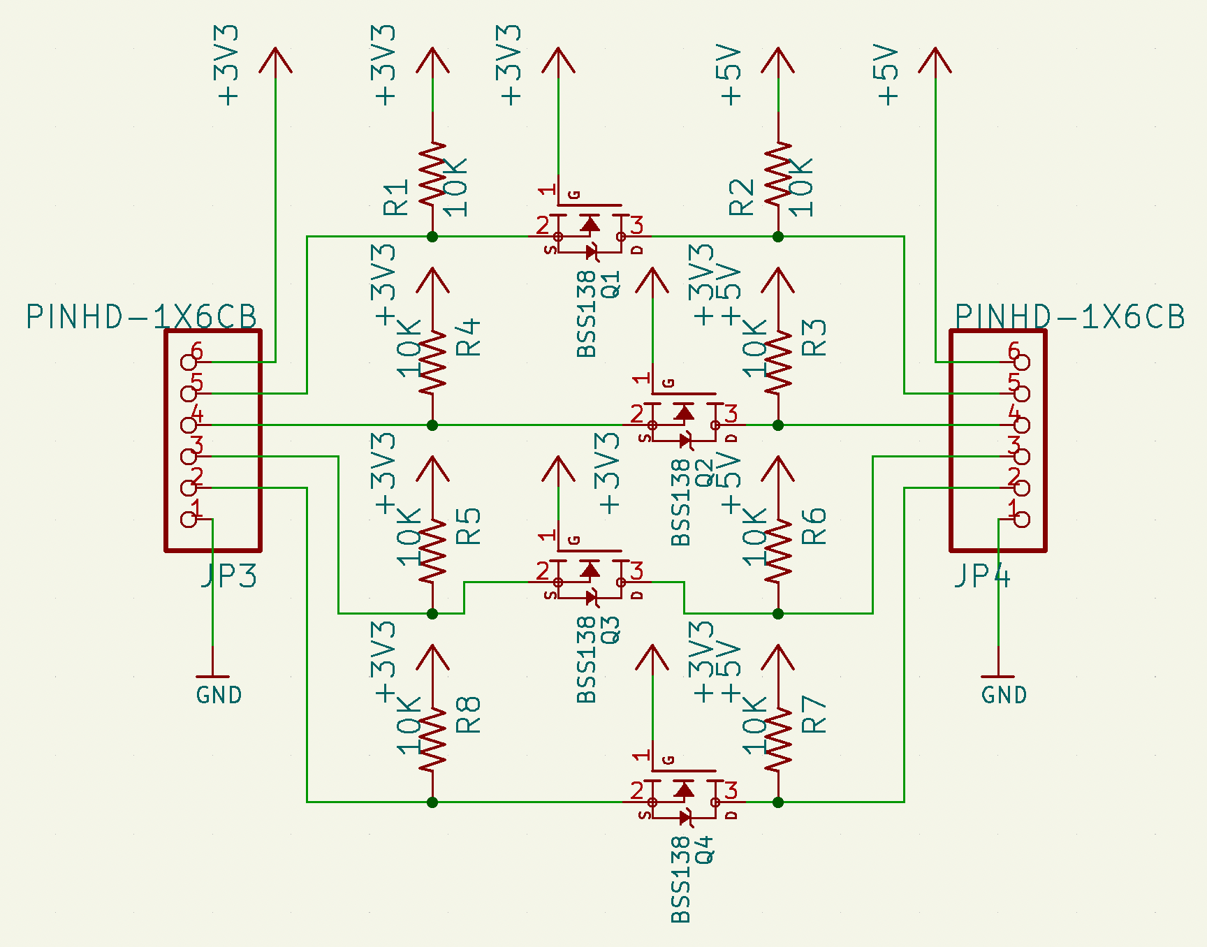

PostPosted: Sat Apr 02, 2022 10:01 am
Posts: 1488
What about something like this? https://www.adafruit.com/product/757

Interesting. I'd rather not use boards like this, but this might be simple enough to reverse engineer to incorporate into my own design. Looks like two 10K resistors and one FET per channel. (Mind you, that still adds up to 48 components in total!)

PostPosted: Sat Apr 02, 2022 4:04 pm
Joined: Tue Apr 03, 2018 2:10 pm
Posts: 125
So that Adafruit board basically works by connecting the source & drain connections of an N-channel enhancement mode FET to the 3V3 and 5V signal pins. The gate is connected to 3V3. Each side is also pulled up with a 10K resistor to the relevant voltage (3V3 or 5V).
I don't know enough about FETs to really understand what's going on here. But would I be right in thinking that whatever is on the receiving side needs to be open drain?

PostPosted: Sat Apr 02, 2022 6:18 pm
Posts: 741
No, it's fully bidirectional in the sense that either side can drive or not at any point in time. The receiving side needs to just be high impedance as usual for something that's receiving a signal. You need to choose the right transistors though (with a rather low gate threshold voltage), and put them in the right way around.
To understand it, I think it helps to separate the two cases based on which side is inputting and which is outputting.
If the 3V3 side (left) is in input mode and the 5V side (right) is in output mode, then if the 5V side outputs low then the body diode in the MOSFET will pull the 3V3 side low as well, winning out over the weak pull-up resistor on the 3V3 side; and if the 5V side outputs high then that won't happen, and the pull-up resistor on the 3V3 side will pull it high.
On the other hand, if the 3V3 side is outputting and the 5V side is inputting, then if the 3V3 side outputs low then it drives the MOSFET's source terminal to 0V, while the gate is held at 3V3, and (if you choose wisely) that's enough higher than the source terminal that the MOSFET will conduct enough to pull the 5V side low (beating the weak pull-up resistor on the 5V side). And if the 3V3 side is outputting high, then as the gate of the MOSFET is also at 3V3, that's not enough higher than the source to allow the MOSFET to conduct, and the 5V side's pull-up resistor will pull it all the way to 5V.
PostPosted: Sun Apr 03, 2022 7:04 am
Posts: 125
Great explanation. Thanks. The Adafruit product uses the BSS138, which seems to be readily available.
