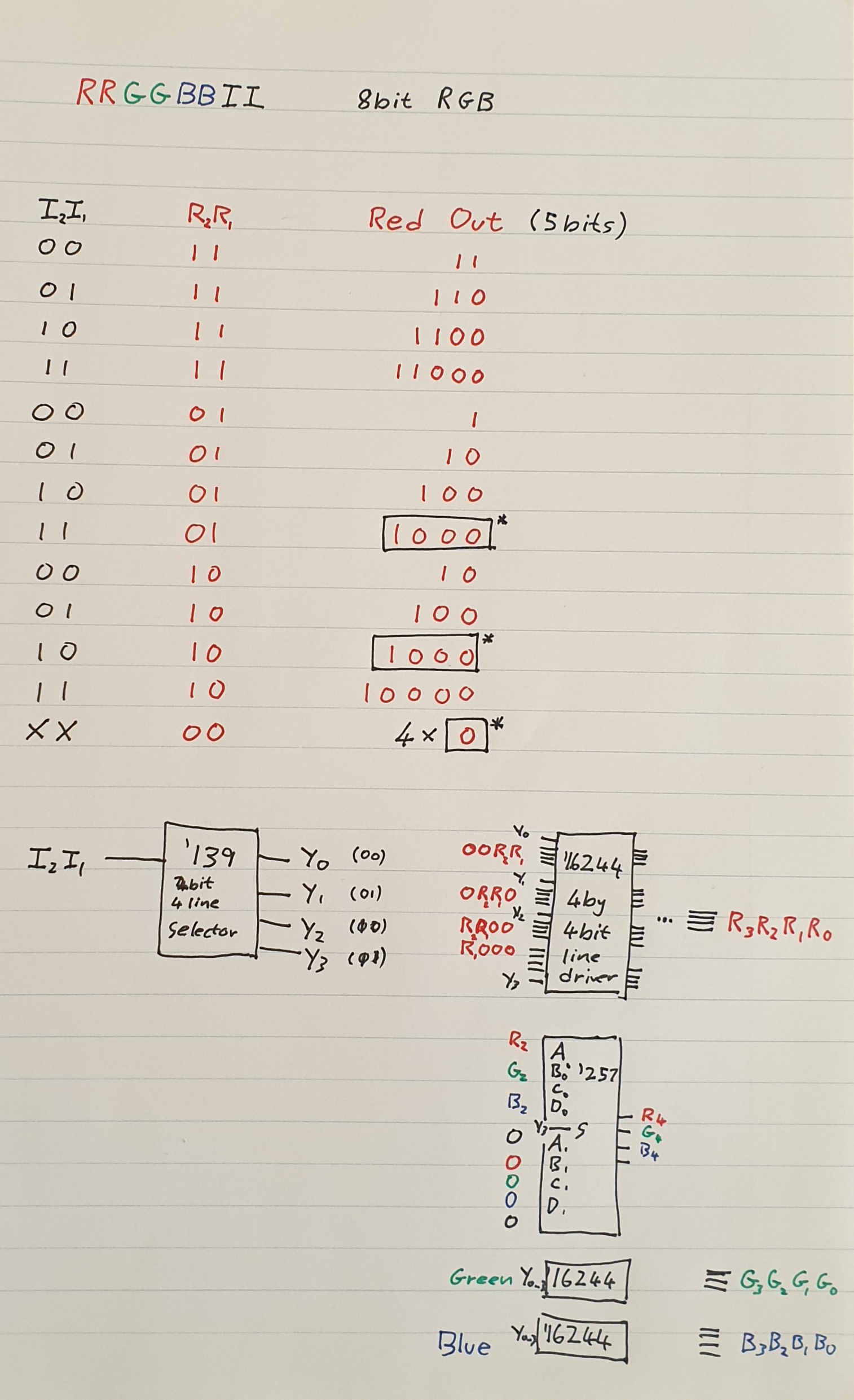

akohlbecker wrote:
You might find this interesting https://www.bigmessowires.com/2008/07/0 ... tte-setup/
Having a brief pause in the crazy deadlines we have at the office at the moment I though I'd try and sketch up a digital solution instead. I think it should be possible to take an 8Bit RRGGBBII value and turn it into a 15bit (or 24bit padded with zeros) value using only 5 ICs. One '139 (or '138) selector, three '16244 line drivers and one '257 multiplexer. Wire II into the '139 and send its 4 outputs into the 4 enables on RED '16244. Wire RR into the inputs of the '16244 four times but offset by the intended intensity (wire the two unused inputs to ground in each case). Wire all the same outputs of the '16244 together. i.e. All bits 0 get wired together, all bits 1 get wired together, all bits 2 and all bits 3. This creates a nice single chip 4 bit by 4 to single 4 bit multiplexer.
Do the same using another '16244 for GREEN. And another for BLUE. This gives us 12 bit colour which might be good enough if you only allow II values of 00, 01, and 10. However going 8bits RRGGBBII to 12bits R3R2R1R0G3G2G1G0B3B2B1B0 seems like a bit of a waste.
The fifth bit can be generated using a single '257 for all three colours. Wire the high bit of each colour into the 'zero' selector inputs. Wire ground into the 'one' selector inputs. Wire Y3 from the '139 into the '257s Selector. The 4 bits of output on the '257 become the fifth bits of RGB with the last output unused. That gives us a decent 15bits R4RRRRG4GGGGB4BBBB (or even RRRRR000 GGGGG000 BBBBB000 if you have a 24bit DAC) from 8bits of RRGGBBII.
For all of the work above it's probably just easier to write a palette into 3 8bit data by 8bit address ROMs (or RAMs) and use the 8bits of RRGGBBII as the address. At which point you just a have normal 256 colour palettised to 24bit colour display

Re: A question regarding 6502 being interfaced to a 8/16 bit
Regarding RRGGBBII, I've drawn a diagram but this may only confuse the matter. RRGGBBII is, technically, a four dimensional color-space, like CMYK. Therefore, I have omitted green and drawn a projection of red, blue and intensity on a two dimensional plane. I am not adverse to drawing a projection of a hyper-cube but it is time consuming and doesn't advance my argument.
Starting from RGBI, we have two cubes of color: a dark cube where I=0 and this overlaps with a light cube where I=1. Along the diagonal from black to white, we have four colors where R=G=B: black, dark gray, light gray, white. This is similar to EGA. RGBI can be extended to two bits per channel. This leads to four overlapping cube meshes where each mesh has 64 points. Also, we have 16 colors where RR=GG=BB. Within each cube, there are four points where RR=GG=BB and there are four cubes. This scheme is always superior to RRGGBB unless two bits are used for horizontal and vertical sync (as occurs in Gigatron design). In particular, an even tempered allocation of bits is best for representing light and dark skin tones. From empirical tests using Perl to make GIMP palettes, I found that schemes with superior representation of light skin tones do so at the expense of dark skin tones. Don't be a casual racist.
The (dis)advantage of RRGGBBII is that colors are muted because the overlapping color cubes only meet the black and white corners of RGB color-space and not the red, green, blue, yellow, cyan or purple corners. This provides more compatibility with brightness oriented Y* and *K color-spaces, such as YUV, YIV, YCbCr and CMYK. In these cases, one axis provides brightness (Y) or darkness (K). The reason for these color-spaces is to maximize the representation of color over bandwidth limited composite video cable, to minimize perceptual allocation of bits or to minimize the cost of ink. Viewed from the basis vectors of RGB color-space, one axis is along the diagonal from black to white and the overlapping volume of cuboids is awkward. However, RRGGBBII, with six clipped corners, is partially aligned with the clipped volumes common to RGB, CMYK and other color-spaces. Therefore, RRGGBBII reduces the proportion of colors which can be displayed but not printed, printed but not displayed, displayed but not streamed and streamed but not displayed.
I would implement RRGGBBII using three 74HC161 in a non-counting latch configuration. The use of three identical components would minimize signal skew. This would be commonly followed with three R2R DACs and no-one considers the slew rate of 25.175MHz 640*480 VGA using through hole passive components. However, R2R DACs introduce their own non-linearity because there is unwanted current flow within the resistor network. Use of diodes only complicates the situation. If the least significant bits are redundantly latched then non-linearity is contained within each channel. To reduce components, people may be inclined to have one eight bit latch, such as 74x574, and arrange the highest resistances such that a small amount of back-flow occurs between the three color channels. Don't do that. It will further mute the colors and it is a distinctly different color-space. The only place where resistor cross-flow is useful is in gfoot's 2 bit per pixel hack where green is the average of red and blue. This provides the never-known-for-its-subtlety Commodore Amiga WorkBench 1.3 palette of black, orange, blue and white.
I really hadn't considered non-linear brightness response and this is a fraught problem. Mammal brightness perception is non-linear and involves square roots. Meanwhile, linearity of NTSC/PAL/VGA is implicit and rarely equivalent. Does a equal step in voltage represent an equal step in monitor luminance, an equal step in perceptual brightness, or something else? I prefer maximum perceptual range but a minimal system may be approximately linear and this may skew towards a pastel palette. Some monitors may convert linear voltage into perceptual brightness but this feature may be absent from cheap LCD panels. R2R values can be tweaked to approximate perceptual brightness but this may be counter-productive in common scenarios.
AndrewP's barrel shifting eliminates most of the unwanted non-linearity while keeping most of the wanted non-linearity. Full implementation requires 15 bits of latch (two 74HC574) and monitor gamma setting remains desirable, if available. However, any decent discrete implementation requires multiple chips and gamma settings.
You may be inclined to store RRGGBBII such that BPL/BMI/BVC/BVS could be used on the intensity bits. This may seem preferable to advantaging one color channel over the others. However, it is preferable to store intensity in the least significant bits because a video codec can approximate MPEG lighten/darken by using INC/DEC. This doesn't work for all values and the effect is guaranteed to be worse than MPEG encoding. However, it requires minimal clock cycles and it works effectively if there is a huge number of tiles. INC/DEC is also preferable for computing LUT for drop-shadow of partially occluded video windows. Specifically, it is possible to select anything from zero shadow to absolute shadow. A utility for the Amiga had similar functionality. Therefore, it is definitely within range of 14MHz 65816. As I previously noted:
