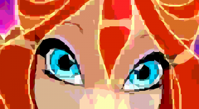

I have previously attempted to transcode 3840*2160p video to my own format. I used a trailer for Elysium as test data. My conclusion is that everything looks awesome at 4K. Even when error metrics for 8*8 tiles were completely fubar, the result is excellent because there is a mix of 480*270 flat tiles and other encodings. This is the Mrs. Weiler's Law: "Anything is edible if chopped finely enough." Well, 120 columns of PETSCII with 8/16 bit color is definitely chopped finely enough.
A quick win to improve image quality and reduce bandwidth is hierarchical encoding. Specifically, I suggest concurrent use of 16*16, 32*32 and 64*64 tiles. I also suggest XOR of tiles at each scale prior to display. This allows selective addition or subtraction from a base color without incurring ripple carry. It also minimizes sections of dropout when a video is not played on target hardware. Hardware with support for two or more tile sizes allows small video to be upscaled by a factor of two or more while incurring no additional processor load. It also allows thumbnails to be played at lower quality. In particular, the top tier of a hierarchical video can be played on a Commodore 64 if it does not exceed 40 columns.
The hierarchical encoding process is similar to JPEG. Blocks of the broadest scale are processed first and residual data is processed in subsequent passes. This process is compatible with SIMD. If luma/chroma is conventionally summed, then thumbnails on any proposed hardware may incur dark patches in high detail areas. This would be particularly prominent on the lowest specification equipment. Although XOR incurs redundant impulse and worsens compression, it also provides the most graceful degradation. Where bandwidth and storage are not the priority, this atypical use is preferable. If this design choice is in error, it possible to fix in hardware by selectively incorporating XOR into a full adder. It is also possible to fix in software.
The astute may notice that large tile sizes are not compatible with the accepted list of high vertical resolutions. The result may be a strip of half or quarter tiles. Likewise, a tile hierarchy may place constraints upon user interface. This may include CJK on even columns only and windows which snap to a four column and four row grid. However, all of this is ancillary to the primary usage. The main purpose is mutually influenced hardware and software with the purpose of training people to make better hardware and software.
What is the quality of hierarchical, bi-level texture compression? You are probably using it already because most PCI and PCI Express graphic cards manufactured since 2005 support it. Indeed, fundamental patents regarding texture compression have subsequently expired. My technique to use the order of operands to share commutative opcodes is taken from a common texture compression format where the order of palette entries determines the compression technique. I would not be confident sharing my use of this technique with an active patent.

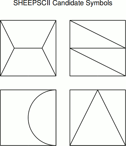

I have thought further about encoding tile alpha masks in one byte or so. This may be of most immediate interest to ElEctric_EyE.
A non-obvious arrangement is a square with nodes along all four edges at the 1/8, 3/8, 5/8 and 7/8 mark. This leads to 192 interesting permutations where it is possible to draw a chord diagonally across the tile. Furthermore, there are two encodings for each pair or points. This is sufficient to indicate which side of the chord should be solid or transparent. The remaining 64 prmutations may indicate chords drawn at the 1/4 and 3/4 mark. The remaining 16 permutations may indicate chords in a diamond along the 1/2 mark of each edge. Of the remaining four permutations, one may indicate fully solid, one may indicate fully transparent and two encodings are unused. These unused encodings may not be useful for a basic hardware implementation but they are sufficient to indicate an escape code for future functionality.
A more obvious method to chord a square tile includes all four corners and nodes along all edges and 1/4, 1/2 and 3/4 mark. This provides 176 interesting permutations. The remaining 80 permutations may be allocated to curved alpha masks. These may be allocated such that there are zero, one or two concave or convex between nodes. Given the lack of available encodings, all of the shortest curves can be excluded from consideration. This is due to the shortest curves providing the least variation. The intention is to provide the best fringe - ideally within four pixels - for pre-calculated sprite data where the alpha channel is known and remains fixed. Therefore, it is not necessary to compute an alpha channel mask by any fast or obvious method during display.
alpha-tile0-0-0.odg
(6.55 KiB) Downloaded 113 times

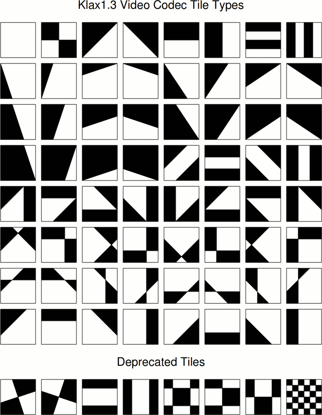

Working with 16*16 tiles, it is possible to approximate one arbitrary tile of video with one byte for foreground color, one byte for background color and one byte for texture. This is not new. I was unable to find details but it is possible that Avid's old proxy video format was 32 bits per tile where foreground/background was 4 bit per channel RGB. I suggest similar but with even tempered 8 bit palette to make a more compact 24 bit. This may not be original, but I found that it is possible to approximate horizontal and vertical texture independently by using Walsh functions. Specifically, 2^N bi-level values may be approximated with N bits. In the case of 16*16 pixel tile, it may be approximated as two nybbles.
Mapping arbitrary video down to foreground/background palette and Walsh function nybbles is awkward but within the ability of 65816 in a batch mode. When the same format is the known output of a blitter pipeline, it is possible to work backwards and define the minimum resources for rendering. The task is simplified because the foreground and background colors are given. Most importantly, there is no need to calculate all 256 pixel values for the tile. Instead, it is possible to compute one horizontal stripe and one vertical stripe. Any stripe will do. However, to minimize error, the middle stripe is preferable. Specifically, (x,8) and (8,y) pixels where x and y are integers from zero to 15. This is 31 pixel values because (8,8) is common to both sets. The stripes may be computed in parallel or computed in iterative steps, for example, over 16 clock cycles.

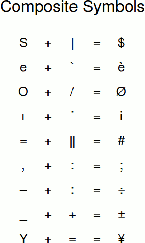

I've looked at symbol encoding, such as Latin1 and Unicode. It doesn't seem to be implemented efficiently. Many of the symbols have diacritical marks, such as upper case E with acute, grave, circumflex or umlaut. These are often stored and rendered in a highly duplicated manner. I believe this could be represented very concisely using two bitmap ROMs and a set of OR gates. Specifically, one ROM would contain 7 bit ASCII, Greek and Cyrillic. The other ROM would contain diacritical marks. Indeed, this arrangement allows the correct rendering of Spinal Tap with the umlaut on the n.
If less than 32 diacritical marks are required, three bits may be allocated to underline, strikethrough and overbar. The remaining five bits are allocated to diacritical marks, such as acute, breve, tilde, double grave and cedilla; possibly at two heights to allow for upper case and lower case. Even this is a scheme with redundant allocation. However, it allows a broad, symmetric range of symbols to be displayed. In a more general scheme, the output of eight or more ROMs may be ORed together:

Separately, I am considering extensions to PETSCII and I have unconventional ideas for displaying any symbol. This is loosely inspired by a spoof proposal for character encoding, a graphical language where up to seven symbols could be super-imposed to convey nouns and verbs and the HalfBakery's Two thousand glyph script. This is best described graphically where, for example, S super-imposed with a vertical line makes a dollar symbol. This can be achieved by logical OR of two or more character ROMs. However, it becomes quite tricky to place the symbols so that the maximum number of useful permutations can be selected. This is due to the combinatorial explosion of possible symbols. It may be worthwhile to redundantly place symbols into multiple ROMs while also assuming that only one ROM is fitted by default. In the case of one ROM, underline/strikethrough/overbar is not available. In the case of two ROMs, either may provide underline for symbols in the other ROM. However, this arrangement prevents symbols in two ROMs being combined. Therefore, a third or fourth ROM may also provide underline functionality. This allows two or more symbols to be combined while allowing relatively unrestricted decoration.
Ignoring 3D, I'm considering video writes with maximum throughput. I'm considering a scheme where bulk data is written to a region which shadows RAM (like plasmo's VGA6448 and others) or a region which shadows ROM (like sburrow and others) and available graphics functionality can be queried via SPI. 8KB RAM or ROM can be split into four or more pieces where one segment is video peripheral registers, one segment is for bank switching registers and two segments are for stereoscopic viewports. (Write to the left viewport is automatically copied to the right viewport. Differing data should be written to left then right.) Write to peripheral register sets display number, tile hierarchy or pseudo-proportional configuration. By default, this is not implemented or activated. Using one of Bill Mensch's tricks from RIOT, it is possible to use address and data lines to convey 18 or more bank bits in one write cycle. This allows, for example, 4 bit character/color plane and 10 bit display row to be specified in one cycle. (Unfortunately, this bank latching scheme might be a virtualization nightmare.) Provisionally, character/color planes are in two groups where:
  • Four planes are for video, Roman, Greek and Cyrillic.
  • Four planes are for Chinese, Japanese and Korean symbols.
  • Three planes are for 8 bit per channel RGB foreground.
  • One plane is for RRGGBBII foreground.
  • Three planes are for 8 bit per channel RGB background.
  • One plane is for RRGGBBII background.
  • A minimum of eight further planes are undefined.
It might be useful to configure the eight palette planes for 10 bit per channel color or possibly allow color emoji with reduced palette range. The color planes should be written in a specific order for downward compatibility. Actually, all planes should be written in a specific order for downward compatibility. Specifically, the Roman, Greek or Cyrillic plane should be written last on the assumption that a minimal, monochrome system only has one Roman, Greek or Cyrillic ROM fitted. In the minimal system, all writes are directed to one plane. In small systems, writes to most planes are ignored. For example, the following writes may be ignored or directed to the only plane: high quality background, low quality background, high quality foreground, low quality foreground, underline, accents and finally ASCII value. The last write will be the most significant data; possibly with the chroma and decoration discarded.
In the laziest SPI configuration, a loopback configuration indicates that 32*24 monochrome text is present. Considerably more resolution and functionality may be available therefore the sequence of writes should maximize compatibility. A knock protocol may drop the SPI loopback and provide a more advanced interface. (A 6502 video system with a knock protocol can be found in a Commodore 128.) The SPI configuration may be a legacy, downward compatible mode, although only major step revisions may be supported. Actually, over SPI, it might be possible to auto-configure MicroSD, MAX3100 UART or blitter over any number of ports. (This might extend to other devices, such as MAX3421 SPI to USB bridge or VERA.)
Anyhow, that's the plan. Make a simple video system. Make the video bus *much* wider. Then add an unconventional triangle blitter. Then add the full pipeline before the triangle blitter. Maybe make it 3D. I am very likely to start with monochrome text using one or two character ROMs. However, it is very re-assuring to know that a text system can be massively scaled out. Likewise, it is highly re-assuring to know that it could be fitted in a RAM or ROM socket; such as the ROM socket of POC2.0 or XR2602. It is most re-assuring to know that the Commander X16's VERA is available as an alternative display system.

Since at least Mon 21 Dec 2020, I have idly described a tile video codec suitable for 8 bit computers and 6502 in particular. On Fri 12 Aug 2022, my idleness advanced to taking screen-shots of videos, down-sampling them in GIMP and reducing them to my preferred 8 bit palette of RRGGBBII. Totem video player has the annoying "feature" that left arrow skips forward 15 seconds while right arrow only skips back 5 seconds. Regardless, I was able to move to the end of a video, skip backwards in 5 second offsets and manually build 40*25 pixel GIF animation with the correct ordering within GIMP. I repeated this process almost 20 times on short videos. This was for the purpose of viewing the lower bound of video quality. From previous failed experiments to convert 3840*2160 pixel video into 16*16 blocks, I found that the very worst case was flat texture with an effective resolution of 240*135 pixels. While many would strive to implement 240 JPEG tiles or something more seamless, I assure you that everything looks awesome in 240 columns of PETSCII. My new target of 40*25 pixels is 1/6 of the horizontal resolution, approximately 1/5 of the vertical resolution and 1/3 of the color-space. However, with a loose superset of PETSCII, some of this loss can be recovered and the result is quite watchable.
Sheep20 was wholly unimpressed with my animated examples and was particularly unimpressed that I hadn't written any software to perform the conversion. After a further four weeks of idle talk, Sheep20 effectively said "put up or shut up." Therefore, on Thu 8 Sep 2022, I began work on the Klax1 video codec. The name is a reference to The Clacks communication network in Terry Prachett's Discworld and I hope that 6502 tile video may be transferred over network in the near future. Klax is also a reference to the "clackers" of the Difference Engine where one of the many consequences of a successful Analytical Engine would be a cottage industry of people developing compression algorithms. Furthermore, public lectures would likely use a semi-standard presentation system; much like PowerPoint and a projector is regarded as standard infrastructure. However, if we consider a hypothetical Victorian PowerPoint using cogs, gears and lensed candles, it is highly likely to use an addressable array of tiles. A vector scheme with deflection mirrors is desirable but infeasible. I have also just discovered that Klax is a block game on Atari 2600.
I have previously worked on audio and video codecs with mixed success. One of the most prominent problems is a quest for efficiency. Specifically, an audio or video codec which can encode or decode in real-time has considerable practical benefit. Unfortunately, barriers to entry have increased while expectations have also increased. In particular, for video codecs, increased horizontal resolution is typically accompanied with increased vertical resolution. With the exception of a transition to widescreen, doubling the width also doubles the height and this quadruples the total number of pixels. For video encode and decode, the large volume of data is typically handled with parallel processing. This is commonly described as "embarrassingly parallel" given that video can be partitioned and assigned to separate processing cores with almost no loss of efficiency. However, a paradigm of embarrassingly parallel processing works against the plucky amateur who wishes to implement video on a single core, 8 bit system. Bandwidth is already constrained by whatever can be soldered at home or programmed on affordable FPGA. Options to scale home-brew hardware linearly are limited or absent. A further impediment is sourcing example material. When an increasing proportion of video is 4K HDR or better, getting it into an 8 bit system is also a minor challenge.
Understandably, my previous work with video codecs suffered from premature optimization. Specifically, I was too focused on byte streams and marshalling with the expectation that I could make it run at 30Hz - if only I could solve the immediate problems. Unfortunately, I could not get different features of my video codec to interact gracefully despite writing an elaborate assertion system. With hindsight, the assertion system was more focus on detail and offered little help with structure or semantics. This time around, I have been careful to avoid previous traps. Helpfully, tile video eliminates many of the fancy features typically found in video codecs, such as motion deltas. Unhelpfully, multiplication and compression are also excluded. Such minimalism has led to constant consideration about upward compatibility and this leads to the next most obvious traps of portability and over-abstraction. I could have written the absolute minimum amount of software to encode and decode one video frame. Instead, I was slowed by making my work open ended. My standard workflow for writing a video codec is to boot-strap using ffmpeg, libgd, libpng and zlib. ffmpeg has features to split and join frames in PNG and many other still image formats. libgd allows manipulation of bitmap images and this includes rectangle drawing. libgd calling libpng calling zlib performs read and write of GZip compressed PNG images. Therefore, a small amount of C, an unremarkable Makefile, some standard libraries and the external invocation of ffmpeg is sufficient to start writing a video codec. However, I didn't choose this route. Instead, I started work on a laptop with a live-boot, no compiler, no make system and without ffmpeg. In an attempt to make a video codec which was portable rather than fast, I spent two evenings attempting to decode PNG files using Unix shell scripts and Perl. I made shockingly good progress. Specifically, I decompressed chunks of PNG's RIFF variant and obtained the raw RGB byte stream of the first chunk.
This tedious approach was abandoned when, by chance, I discovered that my live-boot system had an ImageMagick binary. ImageMagick was hugely significant in the 1990s because it allowed batch processing of pictures not restricted to cropping, resampling, titling and - most significantly - image format conversion. This was a very intensive task when servers typically ran at 50MHz and had 16MB RAM. It did not occur to me that ImageMagick would be the type of fossil which survives in the default Debian Linux distribution or derivatives. Regardless, I quickly formed a cunning plan. I could make a Perl program which has ffmpeg and ImageMagick as dependencies and use Perl's shell pipeline spawning functionality to read and write all PNGs as uncompressed TGA. Specifically, to decompress PNG:
open(IN,sprintf("cat 'foo/%08d.png' | convert - tga:- |",$frame)) || return 0;
This provides an input stream with a fixed length header and raw RGB data. The header describes the size of the image and the bit depth. Dependency on ImageMagick's convert binary is not ideal. However, it is not particularly onerous when ffmpeg is also required. Unfortunately, I encountered a multiple problems across different systems. The root problem is that versions of ffmpeg and ImageMagick weren't consistent and functionality differs across versions. ffmpeg has a deprecated set of parameter names for splitting and joining images while different versions of ImageMagick "helpfully" reduce RGB input to bi-level or monochrome. The initial work-around was to use PNG for input and JPEG for output. This work-flow reduced error but it was insufficient across all versions of ImageMagick. The subsequent work-around was to add SMTPE style chroma boxes (black, red, yellow, green, blue, purple, cyan, white) to inputs or outputs. I also added the black and white boxes for the bottom 10 bits of the frame number. (This was greatly appreciated by Sheep20 who has previously edited 16mm film and dubbed the audio separately.) The forced color prevented, for example, black frames being output as a bi-level PNG or monochrome JPEG. Many videos start with a black frame but the subsequent switch to color encoding caused ffmpeg to fail. It took a while for me to identify the root cause and this was not helped by encoding and decoding a broad selection of test videos on multiple computers. A further problem was truncation of frames caused by the processing delay of ImageMagick. I was reluctant to add a one second sleep in a video codec - and especially so when this only makes the problem less likely rather than solve it. A null stream is trivial to identify and redo. However, there is a more insidious case where the header is complete but the payload is short.
A codec requires an encoder and a decoder - and these components require data format. Following the example of TGA, Klax1.0 video format has fixed length header and stores tile data in 7 byte tuples where 1 texture byte is followed by 8 bit per channel RGB foreground and background. I hoped to store textures as two nybbles representing a XOR of two Walsh basis functions (horizontal and vertical) to approximate an area of 16*16 pixels. For downward compatibility, I hoped to store these nybbles in a non-obvious, non-contiguous format. Nybble encodings 8-15 represent the highest frequency encodings. The order of the bits is unimportant because they are typically used to select one pattern from a character ROM. The top bits of each nybble can be grouped together and this allows the highest frequency encodings to be mapped down. On 8*8 pixel systems, such as Commodore64 or Commander X16, NV bits can be tested or cleared with the least number of cycles. This allows 64 encodings to be sought in the most rapid fashion on systems with smaller tiles. This is not original thinking. I merely follow the examples of IEEE-754 floating point format and 65xx peripheral chip registers. The original part is that the scheme can be nested. Any encoding can be trimmed down to an encoding where each Walsh function has less bits. Regarding texture and color together, 16*16 pixels at 3 bytes per pixel (768 bytes uncompressed video) are approximated as 7 bytes per tile. This fixed length data reduction allows linear seek and read/write operation within an unindexed file. The overall scheme may have similarity to Avid's old proxy video editing format but I do not have sufficient information to confirm or refute it. Uncompressed data is reduced to less than 1% of its original size and this is a sufficient reduction to display video on 6502. It can be squashed further but the 7 byte tuple format is more flexible for experimentation. By retaining maximum RGB depth at the intensive encode step, we minimize the need to repeat encode. Whereas, decode has very little to perform. Experiments with palette mapping can be performed rapidly and repeatedly on 7 byte tuples. Although the tuples could be smaller, the gain is a false economy.
By Mon 12 Sep 2022 - three days after I started - I encoded and decoded my first video frame. After that, I encoded and decoded my second video frame. I then cursed for two hours. Speed was a concern. Klax1.0 encoding took 40 minutes per frame. It was a brute force technique where each 16*16 pixel tile was partitioned using a XOR of two Walsh basis functions (horizontal and vertical) and the minimum RMS error found. This is standard codec theory to minimize encoding error.
My greatest concern was that trivial examples failed horribly. I assembled a small library of video stills which were challenging but representative of anticipated inputs. This included a selection of frames from the standard Bad Apple animation, Winx Club Believix Transformation, AKB48's distinctly NSFW [Not Safe For Work] Baby! Baby! Baby! music video and others. Unfortunately, one frame from Bad Apple revealed that more than 95% of the tiles were either solid, horizontal half tiles, vertical half tiles or the PETSCII Battenberg symbol. The frame could be more efficiently encoded using two bits per tile with minimal loss of quality. It looked moderately better than the output of an Atari 2600. Encoding 40*25 tiles, I had an effective resolution of 80*50 pixels - with the exception that one corner of a tile could not be set independently. AKB48 was blurry and also highly skewed.
I was in a very bad mood. I planned to re-use this tile encoding in a large number of other contexts including textured polygon blitting, video sampling and Virtual Reality. I spent many hours drawing diagrams and it was all undermined by one empirical result. I was reluctant to continue because more than one year of doodling had been dashed. Unfortunately, I was accustomed to this type of failure in the field of video codecs. To salvage the situation, I needed to increase effective resolution; the illusion of independent choice. I had already described this problem to AndersNielsen:

I sought a better encoding. My initial plan was to have 48 types of Walsh tile where either the horizontal or vertical frequency may be large. This leaves 16 miscellaneous encodings which may define the most obvious omissions. This subsequently became a residual pool of 4-16 Walsh encodings, 48-60 other encodings and - potentially - 192 upwardly compatible encodings. This leaves the mere problem of defining 48-60 tile types. I thought that I was original to define diagonal chords. However, I already published a variant of this idea when suggesting an alpha channel of tiles to ElEctric_EyE:
Sheep64 on Mon 28 Dec 2020 wrote:
A non-obvious arrangement is a square with nodes along all four edges at the 1/8, 3/8, 5/8 and 7/8 mark. This leads to 192 interesting permutations where it is possible to draw a chord diagonally across the tile. Furthermore, there are two encodings for each pair or points. This is sufficient to indicate which side of the chord should be solid or transparent. The remaining 64 permutations may indicate chords drawn at the 1/4 and 3/4 mark. The remaining 16 permutations may indicate chords in a diamond along the 1/2 mark of each edge. Of the remaining four permutations, one may indicate fully solid, one may indicate fully transparent and two encodings are unused. These unused encodings may not be useful for a basic hardware implementation but they are sufficient to indicate an escape code for future functionality.
64 encodings seems generous but they are rapidly consumed because the typical encoding requires four-way rotational symmetry in addition to a mirrored form. Therefore, symbols are typically defined in groups of eight. Only special cases require four, two or one encoding. A blank encoding is not specifically needed because it can be defined as any tile with the same foreground and background. However, the video codec is intended to work as an overlay for ASCII text where both planes share the same palette values. This multi-plane scheme is also intended to be upward compatible with Greek, Cyrillic, CJK [Chinese, Japanese, Korean] and a variety of dingbat symbols which would be primarily useful for a video player and circuit CAD. So, a blank encoding in the video plane is not strictly required but it allows other planes to be viewed without obstruction. It is desirable for the blank symbol to use encoding 32 because this would be consistent with ASCII space. It is desirable for a corresponding reserved-for-future-expansion symbol to use encoding zero because this can be rapidly tested on 6502. It is also desirable to group symbols into powers of two because this allows, for example, FPGA character generation to use the least logic. It is also desirable to group symbols such that the most likely transitions are adjacent encodings. I have suggested a palette encoding where INC/DEC operations simulate MPEG lighten/darken operations. INC/DEC on suitably arranged textures may simulate motion deltas. Sheep20 recommends that horizontal motion should take priority on the basis that horizontal panning of video is more common than vertical.
There are a few more constraints which should be enumerated. A smattering of high frequency encodings is desirable but not at the expense of rendering diagonal impulse - as occurred with Walsh basis functions. The union of PETSCII and Walsh functions would be desirable for display but the intersection is essential. The best precision for scroll-bars is desirable. In particular, 1/2 tile precision is grossly inadequate. The foremost application for scroll-bars is to convey position and duration of a video. This can be achieved using encodings 0-31 in the ASCII plane but this excludes other uses for that range. Most importantly, all encodings should be chosen with equal probability. Obviously, a blank frame will use one encoding. However, good tile encodings must be chosen frequently while also minimizing error. An encoding which is never used is obviously useless but it is less obvious that two or more marginal choices will maximize encoding error rather than minimize it.

klax-tile-type0-0-3.odg
Vector artwork.
