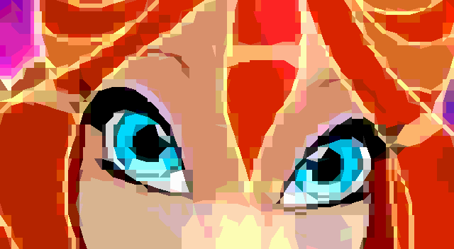

I like driving games. I prefer the simplicity of two dimensional sprite games, such as Sega's OutRun. However, three dimensional games, such as Virtua Racing, Daytona USA, Scud Race and Ridge Racer, also have appeal. For general appeal, 3D, perspective correct texture mapping is probably a baseline specification.
The standard technique of MIP mapped texturing will rapidly exhaust all bus bandwidth. The patents on early texture compression algorithms have expired. However, others are ongoing. There are other techniques to generate textures. For example, one of the earliest uses of fractals in film was generating metal textures in StarWars. In another example, I'd like the skeuomorphic brushed metal textures of Apple GUIs to be generalized to animal textures, such as cow print.
Ah, yeah, this'll work. A while back, some guy theorized that animal foetus development involved a phase where unknown molecules imprinted an animal pattern, such as leopard spots, zebra stripes or raccoon ring-tails. That guy was Alan Turing and his biology paper on the topic was surprisingly rigorous. I hope you enjoy vector field and curl. Furthermore, the molecules have been subsequently identified as protein and an unstable solution of the differential equation has been observed in the changing patterns of zebra fish.
Anyhow, I'm considering an FPGA blitter which can only write. It can only draw triangles with 256 animal textures. It can only output bi-level foreground/background textures in RRGGBBII. And to make things more interesting, it will only work with 1970s/1980s style tile video systems. It is intended to be a hypothetical blitter extension for a Commodore 64 or similar. Indeed, it would be possible to make a simplified version as a Commodore 64 cartridge.
Working with 16*16 tiles, it is possible to approximate one arbitrary tile of video with one byte for foreground color, one byte for background color and one byte for texture. This is not new. I was unable to find details but it is possible that Avid's old proxy video format was 32 bits per tile where foreground/background was 4 bit per channel RGB. I suggest similar but with even tempered 8 bit palette to make a more compact 24 bit. This may not be original, but I found that it is possible to approximate horizontal and vertical texture independently by using Walsh functions. Specifically, 2^N bi-level values may be approximated with N bits. In the case of 16*16 pixel tile, it may be approximated as two nybbles.
Mapping arbitrary video down to foreground/background palette and Walsh function nybbles is awkward but within the ability of 65816 in a batch mode. When the same format is the known output of a blitter pipeline, it is possible to work backwards and define the minimum resources for rendering. The task is simplified because the foreground and background colors are given. Most importantly, there is no need to calculate all 256 pixel values for the tile. Instead, it is possible to compute one horizontal stripe and one vertical stripe. Any stripe will do. However, to minimize error, the middle stripe is preferable. Specifically, (x,8) and (8,y) pixels where x and y are integers from zero to 15. This is 31 pixel values because (8,8) is common to both sets. The stripes may be computed in parallel or computed in iterative steps, for example, over 16 clock cycles.
Transformed co-ordinates are incremented with a delta and a delta of the delta. These values are the input of the texture function. If we work in a floating point format, we may choose a de-normalized format or overflow format which eliminates barrel shifting and the corresponding multiplexer latency. Or we may take a devil-may-care attitude and accept minor rendering error. This requires the least resources but does not preclude a more accurate implementation.
Inputs may require division operation. This may also occur over 16 clock cycles. Indeed, it may be desirable to supply parameters in a shuffled order. This provides the most opportunity to re-use one division unit. For example, horizontal texture offset, co-ord X0, horizontal texture scale, co-ord X1, foreground color, co-ord X2, vertical texture offset, co-ord Y0, vertical texture scale, co-ord Y1, background color, co-ord Y2.
Use of a blitter means that tiles do not have to be memory mapped. As an example, it is possible to have 7680*4320 video (480*270 tiles, 129600 cells) and processor with 16 bit address-space. FIFO to the blitter handles clock domain crossing problems from processor to video. And hardware double-buffering allows maximum bandwidth for blitter writes while also allowing maximum bandwidth for video display. In particular, both may be 24 bit or wider. For 16*16 tile video, for one row of characters, rastering will take 16 passes through tile references. Meanwhile, polygons may be overdrawn at least 16 times without loss of frame rate. This satisfies Radical Brad's recommendation to have at least 7x blitting bandwidth.
You may think that the jaggies will be horrendous. However, as resolution increases, it is more like working with textured pixels. Indeed, with no further refinement, 480*270 PETSCII is suitable to render 80 column text.
It should be possible to implement this blitter using Lattice iCE40 FPGA. The version with 3520 LUT may be sufficient. If this is implemented on Commodore 64, 8*8 tiles only require 64 Walsh textures and some of the iterative steps only require eight cycles.

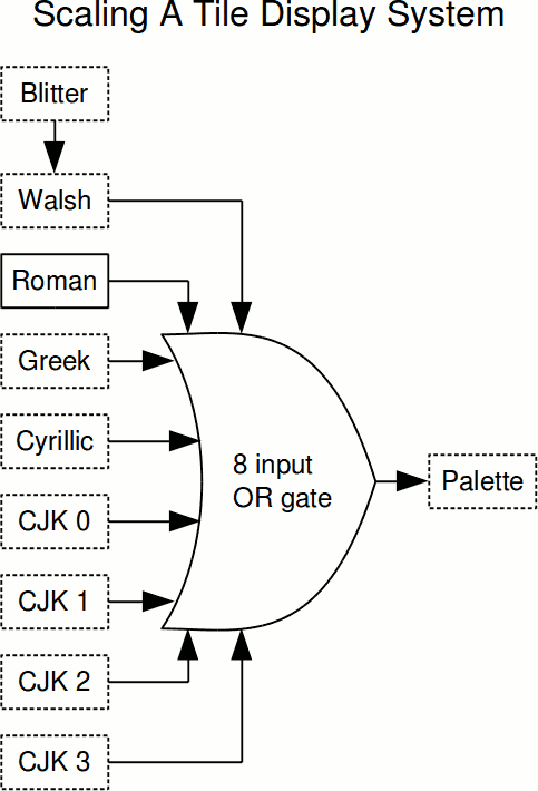

With a triangle blitter, stereoscopic output is possible with no extra bandwidth. Set the desired stereo seperation and then blit to two buffers in parallel. You may think that the result will be awful. I argue that it will be better than noise stereograms which were initially developed to disprove the edge detect correlation theory of stereoscopic vision. I've written stereogram software on Amiga and it was an awful piece of 68000 assembly which read depths from planar data and then selectively rotated a buffer by 17-32 bits. The buffer started as alternate bits. However, it was common for bits to become clumped. This reduced the effective resolution of the stereogram. Two stereo viewports would be superior to stereograms. Mis-aligned jaggies and mis-aligned textures in one axis will be more than sufficient to obtain a stereo effect.
Sheep64 on Mon 21 Dec 2020 wrote:
FNE on Sun 10 Mar 1985 wrote:
One way to mix graphics and text is simply to use an exclusive-or gate to mix conventional 25-line, 80-column text with graphics.
I've considered XOR of text and graphics. I've considered XOR of text at different scales. I'm now considering OR of character ROMs.
I've looked at symbol encoding, such as Latin1 and Unicode. It doesn't seem to be implemented efficiently. Many of the symbols have diacritical marks, such as upper case E with acute, grave, circumflex or umlaut. These are often stored and rendered in a highly duplicated manner. I believe this could be represented very concisely using two bitmap ROMs and a set of OR gates. Specifically, one ROM would contain 7 bit ASCII, Greek and Cyrillic. The other ROM would contain diacritical marks. Indeed, this arrangement allows the correct rendering of Spinal Tap with the umlaut on the n.
If less than 32 diacritical marks are required, three bits may be allocated to underline, strikethrough and overbar. The remaining five bits are allocated to diacritical marks, such as acute, breve, tilde, double grave and cedilla; possibly at two heights to allow for upper case and lower case. Even this is a scheme with redundant allocation. However, it allows a broad, symmetric range of symbols to be displayed. In a more general scheme, the output of eight or more ROMs may be ORed together:
  • Walsh function ROM.
  • SHEEPSCII, Roman monospace and Roman pseudo-proportional ROM.
  • SHEEPSCII, Greek monospace and Roman diacritical ROM.
  • SHEEPSCII, Cyrillic monospace and Greek diacritical ROM.
  • Chinese, Japanese, Korean ROM 0.
  • Chinese, Japanese, Korean ROM 1.
  • Chinese, Japanese, Korean ROM 2.
  • Chinese, Japanese, Korean ROM 3.
None of these ROMs requires more than 256 entries. In the trivial case, only one ROM is fitted and one path of tile indirection is implemented. This is upwardly compatible with more general implementation. In particular, two or more reads may be multiplexed through the same data path. If this is implemented in FPGA, savings may be obtained from sections of ROM which do not use the edge. In the case of diacritical marks, the mid section is rarely used. Walsh functions are defined independently for horizontal and vertical nybbles. These may be XORed to obtain 16*16 pixel textures. The only exception case is zero which is empty. Indeed, in all ROMs, case zero should be empty to ensure that useful bitmaps may be selected from individual ROMs.
I don't read Chinese, Japanese or Korean but I work on the basis that Chinese has more than 2000 symbols but many of them appear to be repetitive in the same manner that acute and circumflex is repeated. I assume that 4*64 is sufficient to represent half tile bitmaps and that 4*192 is sufficient for full tile bitmaps and miscellaneous decoration. Actually, a default bitmap size of 8*32 or 16*64 may be preferable. Odd and even sets may or may not be duplicates. In this design, two (or more) tiles are required to make the majority of symbols and a lookup system is used to select the appropriate values. In the case of CJK, one 24 bit word provides half tile bitmap references and one 32 bit word provides full tile bitmap references. This top tier of indirection is stored outside of the rastering hardware and may be compressed. In the case of Latin1, up to four bytes may specify portions of a pseudo-proportional font face. In this case, most punctuation and lower case I would be 8*32 pixels. Most lower case letters would be 16*32 pixels. Most upper case letters would be 24*32 pixels. In this arrangement, w is v with a mid-section. Likewise for m and n. Sections of c, d, o and b may be shared, although this should not be over-fitted to one font. To maintain video codec speed, it should be possible to write 32*32 tile references in one cycle.
One of the joys of PETSCII is the ability to define pixel perfect scroll bars; horizontal and vertical. Unfortunately, the arrangement of the symbols is extremely haphazard and there was no facility for upscaling scroll bars beyond 8*8 pixels. 32 or more sequential values would be highly desirable. Dithering could be used to specify 1/4 pixel increments or suchlike. It is possible to support full PETSCII without mapping the symbols. However, this is highly inadvisable because PETSCII is a mix of input stream keycodes, output stream cursor/color control and bitmaps. The bitmaps are defined 32-127 and 160-191. Presumably, this is mapped to a contiguous range of 0-127 and the top bit defines reverse video. Unfortunately, there are two sets of symbols. The default set displays upper case ASCII but 92-127 is not standard ASCII. The alternate set reverses upper case and lower case. It is a mess. It is preferable to implement monospace Roman, Greek and Cyrillic with the least effort and then map PETSCII to upscaled symbols wherever it is most convenient.
Some symbols will be defined redundantly across two or more ROMs. For example, seven permutations of underline, strikethrough and overbar in one ROM may be applied to all symbols in another ROM. However, this arrangement requires reciprocation. In the case of ancient Greek diacritical marks, the full range must be placed outside of the Greek ROM. More than 200 symbols are available for SHEEPSCII and many of them are composable. Many emoji benefit from being spread across multiple ROMs. For example, catface smiling may be composed independently from a choice of head shape, eyes and mouth. The result intersects with Unicode but provides a more regular set of symbols which are outside of Unicode.
Symbols not supported include:
  • Most of the IBM PC text mode symbols. Specifically, double line boxes. PETSCII's single line boxes with optional round corners are preferable.
  • Most of the symbols in Unicode, such as the ridiculous $26C4 or the NSFW $1F3E9.

Separately, I am considering extensions to PETSCII and I have unconventional ideas for displaying any symbol. This is loosely inspired by a spoof proposal for character encoding, a graphical language where up to seven symbols could be super-imposed to convey nouns and verbs and the HalfBakery's Two thousand glyph script. This is best described graphically where, for example, S super-imposed with a vertical line makes a dollar symbol. This can be achieved by logical OR of two or more character ROMs. However, it becomes quite tricky to place the symbols so that the maximum number of useful permutations can be selected. This is due to the combinatorial explosion of possible symbols. It may be worthwhile to redundantly place symbols into multiple ROMs while also assuming that only one ROM is fitted by default. In the case of one ROM, underline/strikethrough/overbar is not available. In the case of two ROMs, either may provide underline for symbols in the other ROM. However, this arrangement prevents symbols in two ROMs being combined. Therefore, a third or fourth ROM may also provide underline functionality. This allows two or more symbols to be combined while allowing relatively unrestricted decoration.
Ignoring 3D, I'm considering video writes with maximum throughput. I'm considering a scheme where bulk data is written to a region which shadows RAM (like plasmo's VGA6448 and others) or a region which shadows ROM (like sburrow and others) and available graphics functionality can be queried via SPI. 8KB RAM or ROM can be split into four or more pieces where one segment is video peripheral registers, one segment is for bank switching registers and two segments are for stereoscopic viewports. (Write to the left viewport is automatically copied to the right viewport. Differing data should be written to left then right.) Write to peripheral register sets display number, tile hierarchy or pseudo-proportional configuration. By default, this is not implemented or activated. Using one of Bill Mensch's tricks from RIOT, it is possible to use address and data lines to convey 18 or more bank bits in one write cycle. This allows, for example, 4 bit character/color plane and 10 bit display row to be specified in one cycle. (Unfortunately, this bank latching scheme might be a virtualization nightmare.) Provisionally, character/color planes are in two groups where:
  • Four planes are for video, Roman, Greek and Cyrillic.
  • Four planes are for Chinese, Japanese and Korean symbols.
  • Three planes are for 8 bit per channel RGB foreground.
  • One plane is for RRGGBBII foreground.
  • Three planes are for 8 bit per channel RGB background.
  • One plane is for RRGGBBII background.
  • A minimum of eight further planes are undefined.
It might be useful to configure the eight palette planes for 10 bit per channel color or possibly allow color emoji with reduced palette range. The color planes should be written in a specific order for downward compatibility. Actually, all planes should be written in a specific order for downward compatibility. Specifically, the Roman, Greek or Cyrillic plane should be written last on the assumption that a minimal, monochrome system only has one Roman, Greek or Cyrillic ROM fitted. In the minimal system, all writes are directed to one plane. In small systems, writes to most planes are ignored. For example, the following writes may be ignored or directed to the only plane: high quality background, low quality background, high quality foreground, low quality foreground, underline, accents and finally ASCII value. The last write will be the most significant data; possibly with the chroma and decoration discarded.
In the laziest SPI configuration, a loopback configuration indicates that 32*24 monochrome text is present. Considerably more resolution and functionality may be available therefore the sequence of writes should maximize compatibility. A knock protocol may drop the SPI loopback and provide a more advanced interface. (A 6502 video system with a knock protocol can be found in a Commodore 128.) The SPI configuration may be a legacy, downward compatible mode, although only major step revisions may be supported. Actually, over SPI, it might be possible to auto-configure MicroSD, MAX3100 UART or blitter over any number of ports. (This might extend to other devices, such as MAX3421 SPI to USB bridge or VERA.)
Anyhow, that's the plan. Make a simple video system. Make the video bus *much* wider. Then add an unconventional triangle blitter. Then add the full pipeline before the triangle blitter. Maybe make it 3D. I am very likely to start with monochrome text using one or two character ROMs. However, it is very re-assuring to know that a text system can be massively scaled out. Likewise, it is highly re-assuring to know that it could be fitted in a RAM or ROM socket; such as the ROM socket of POC2.0 or XR2602. It is most re-assuring to know that the Commander X16's VERA is available as an alternative display system.

File comment: 21120 bits per frame. 40*22 tiles with 6 bit texture, 9 bit foreground and 9 bit background. It is awesome at 25Hz, especially with audio.
