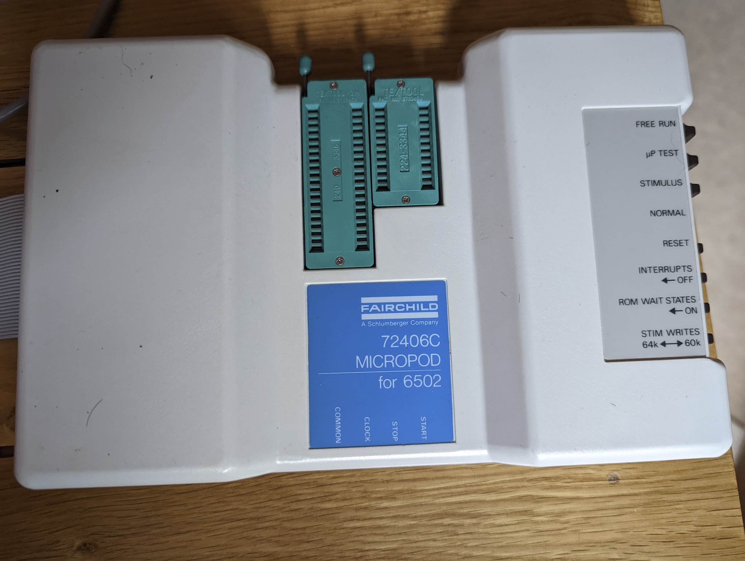

Strange 6502 device
I found a strange device in the bottom of a box of 6502 trainers, probably used to diagnose problems. I can't find anything useful and my Google-fu is outclassed... The device is called "Fairchild 72406C MICROPOD for 6502" - I have put a 6502 into the ZIF socket and plugged the pin header into a 6502 trainer and I can run programs as per usual, so it is "working", but what does it do and does anyone have any user manual/instructions for it?
