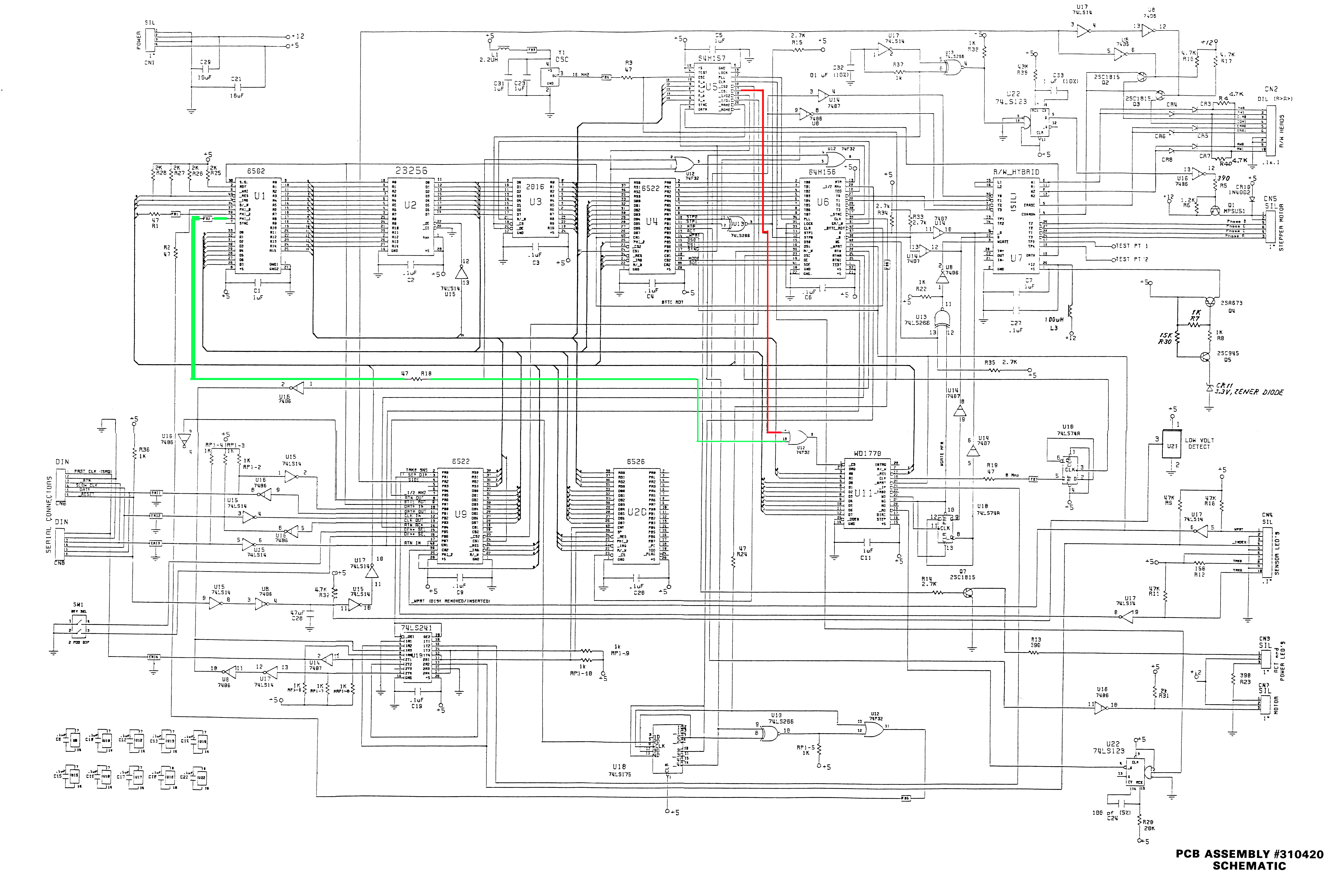

For the 1570/1571, it is different (cf. marked schematics at
in the attachment):
The -CS of the WD177x is generated through a 74F32 (a 2-Input OR gate)
and pin 17 (-CS1) of the 20 pin gate array (marked in red), and PHI1 (!
- marked in green).
So, it seems that the "wild guess" of Frank is right! I did not find any
numbers in the 6502 data sheet of when PHI1 goes high after PHI2 goes
low, but it seems to be later than PHI2. It must be later, because
otherwise, PHI1 and PHI2 would be overlapping.
So, the time to react for the -CS of the WD177x is shortened. This might
explain why Commodore used a 74*F*32, which has a shorter propagation
delay (max of around 7 ns) than a 74LS32 or 74LS00, but it could be that
this is still not enough!
This would explain why the tests of the forum.6502.org thread did not
show any bad effect when the NOP was removed: On the 1581, it seems not
to be critical, but on the 1570/1571, it might be critical!
Now, I think you are more knowledgeable on the 6502 than I am. Does anyone know how long the delay of the PHI1 going high after PHI2 going low? The data sheet only says "0 ns min." for "Delay between PHI1 and PHI2", which does not help much.
Of course, even if it is a problem, it might not be a problem with all 1570/1571 drives.
File comment: 1571 Schematic with the inputs to the -CS of the WD177x marked

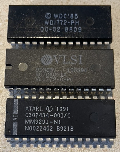

In 2017 I posted some experimental hardware hacks intended to correct the problem and thus verify the theory. The hacks involved adding a transparent latch that'd prevent the FDC from receiving the updated A1 and A0 that appear during the opcode fetch. But Francesco's remarks have inspired me to consider mods to the clock signal instead -- an easier approach.
Said mods could take various forms, and although they're fairly simple I'll make them the subject of a separate post. The goal is to ensure the FDC gets deselected earlier so it doesn't see the A1, A0 values associated with the opcode fetch. Comments and suggestions welcome.

I also spent some time over the past few nights digging into this. I also grabbed some schematics for the Atari ST machines, which also use the WD1772 controller. With the Atari machines, all of the CPU interface lines are connected to their DMA controller, including the data and address lines, R/W, DRQ and CS. Granted, no real knowledge or info on Atari's DMA chip (custom chip), but it does give them absolute control and timing for all registers in the FDC.
I would also reference the WD datasheet, which is not all that great to be honest. It's a bit odd that they don't show any address lines on Read Timings to the FDC, yet they show address lines on Write Timings to the FDC, odd.
Based on everyone's recent input, I would tend to take a different approach for accessing the WD1772. WD did what I would call a half-a** approach to a Motorola 6800 interface (as there's no clock line), so the clock qualification has to happen outside the chip. I would think that isolating the address lines from the address bus and only having them driven when truly selected could in fact be a fix. I'm thinking this is what Atari is doing by having all host interface signals managed by their DMA controller and never being connected to the actual CPU bus. This eliminates any timing anomalies between the various CPU cycles.
To address this (pun intended), either a few gates might be added, or just use a PLD and replace more of the existing circuitry as well... things like all memory and I/O decoding, qualified read and write signals for memory and managing the address lines along with the chip select for the WD1772.
Lastly, I would note that the 1581 drive does not use the PH1 signal from the CPU. PH2 is used for the FDC CS qualification however (and the clock line to the 8520 CIA), and the main CPU clock is used via a 7406 inverter for driving the half of the 74LS139 to generate a qualified write signal for the 8KB SRAM.
Now I need to think if it would be reasonably easy (without hacking the 1581 PCB) to implement such a fix.... hmmm, some more nights ahead on digging.

Jeff (Dr Jefyll) and I have had some PM going on over the past month or so related to this. Jeff has suggested that the timing is too slow for the /CS line and suggested replacing the 74LS00 with a faster chip (74AHCT00).
A few years back, I took my second 1581 drive and removed all of the chips, capacitors and can oscillator from the PCB. I cleaned out all of the holes, installed new caps and a full set of high quality Mill-Max sockets. I then used new 74HCT logic chips, a new 8KB SRAM and a Rockwell R65C02P4 CPU. The only chips that were kept were the 8520A CIA and the Western Digital WD1772-PH floppy controller. Well, even with the faster HCT logic, there was no difference. The WDTEST Macro was still required! Jeff's suggestion of getting even faster chips was noted (and added to my existing Mouser order).
I opted to do some additional testing... my first 1581 (which is a higher serial number than the first) has a VLSI 1772-02 floppy controller (soldered in). Some years ago, I ordered a few NOS VLSI1772-02 FDCs (which were licensed by WD) and also picked up a few of the Atari made chips, which support the higher data rates for the HD diskettes. I opted to install a VLSI chip, modified the source code and commented out the WDTEST macro. To my surprise, the drive still works... and I've done significant testing over the past few days on this. Note: The Atari controller also works fine in the drive. If replace either the 74HCT139 or 74HCT00 with the original LS parts, the drive eventually fails.
This does highlight that early WD1772-PH controllers have some internal timing problems. It would appear that these were likely corrected when they brought out the WD1772-02 (and even later -02-02) parts, which also have high performance digital data separators. Still, the datasheet is identical to the initial version... so nothing to suggest there is any difference, but there certainly is.
I think Jeff had the right idea... and it seems to be the case. I've added some faster logic chips to my existing shopping list, and at some point, I'll perform additional testing and see if it's possible to have the WD1772-PH controller work without the macro as well... but it will likely be a while... just not sure.
