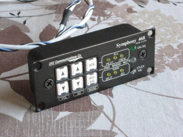

Where can I get a Hex keyboard? I have looked everywhere. I guess I could buy a 16 button pad and label the buttons myself but I would rather have a hex keypad.
This one is kind of nice for a 16-key keypad, although it's not labeled for a hex keypad.
The Grayhill 87 series is nice because you can piece together different lengths of strips into any size keypad you want, with 1/2" square keys, and the transparent tops snap out so you can print whatever labels you want under them. I used them in this project for 6502-controlled automated test equipment :
although I just wrote the labels with a marker on paper for this one. I used the same key type again for the control head of an aircraft product I designed in 1993 that we sold for 14 years:
The control head(s) could be mounted even in the ceiling over the crew if they didn't have room in the panel, while the box with the bulk of the electronics went behind the panel. That was 6502-controlled as well.
I have a tiny keypad I use with my 6502 workbench computer, but no picture at the moment to show you. I used the printer to make neat labels for that one.
There's a .pdf on the Grayhill 87-seires keys here.
