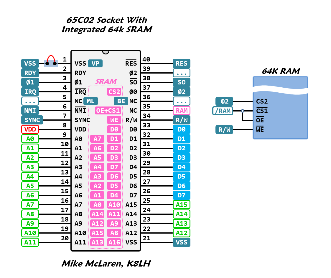

BTW, I also made a small 0.8-mm thick PCB with a 64K RAM chip that fits onto the shoulder of the pins on a 40-pin machined pin socket intended for a 6502 CPU that might be used to simplify PCB routing and reduce board space. You could solder the socket with integrated RAM directly onto a PCB or place it in-between a CPU and existing CPU socket (I'd be happy to send you a PCB, if you'd like).

Just thought I'd mention it as a simple low-profile solution. I thought about using the method for a mini' SBC by stacking sockets (see below).
