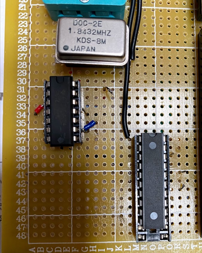

I implemented this in one 74AC00.
https://photos.google.com/u/2/share/AF1QipM1BPMjKumR_siFSWqlkTik-T303uN3s1Gt12JGhWNUjX1JeWQdzOpDRnCW4SYbyQ/photo/AF1QipN0xcydyFm9X3VHGuV41eXBMBVDttAs79Z-bFrf?key=MEEyV0kxR1JZT0xkVklickNfR19jZFRMZmxFOERn
I used Dr. Jefyll's connection scheme: http://forum.6502.org/viewtopic.php?f=1&t=6777#p87025
It goes through a 74AC245: https://photos.google.com/u/2/share/AF1QipM1BPMjKumR_siFSWqlkTik-T303uN3s1Gt12JGhWNUjX1JeWQdzOpDRnCW4SYbyQ/photo/AF1QipMhaaL93r8QUio6OxY-QXh0FYfqKA4Z1yZHxEyo?key=MEEyV0kxR1JZT0xkVklickNfR19jZFRMZmxFOERn
As you guys said, the B side faces the CPU and the A side faces outward to the bus.

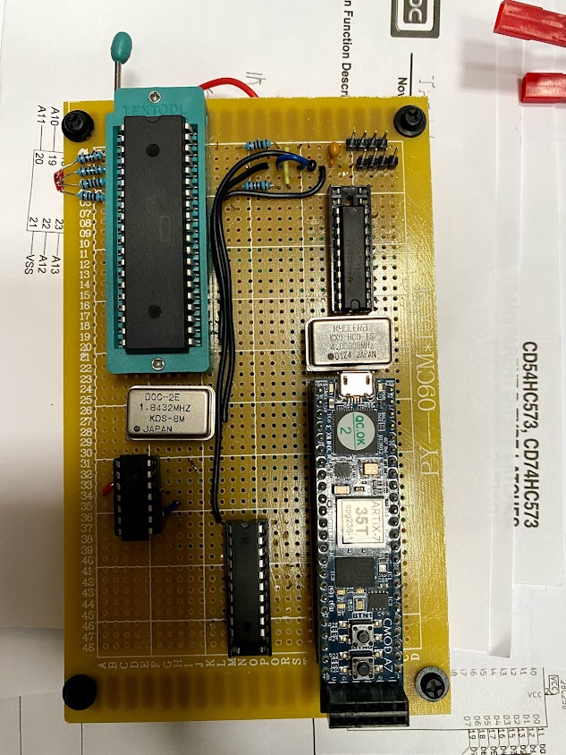

Then, I implemented the bank address capture scheme found in the 65c816 data sheet, through a 74HC573: https://photos.google.com/u/2/share/AF1QipM1BPMjKumR_siFSWqlkTik-T303uN3s1Gt12JGhWNUjX1JeWQdzOpDRnCW4SYbyQ/photo/AF1QipPj8f0Ns84LB3bV0qJ7HQzPTrY5j_BKv1Gujbwa?key=MEEyV0kxR1JZT0xkVklickNfR19jZFRMZmxFOERn
Then I ran all the lines (data out from the '245, bank addresses from the '573, addresses from the cpu, and /rd and /wr from the '00) into a CMOD A7 35T (has 512k SRAM): https://photos.google.com/u/2/share/AF1QipM1BPMjKumR_siFSWqlkTik-T303uN3s1Gt12JGhWNUjX1JeWQdzOpDRnCW4SYbyQ/photo/AF1QipNjD_R_5yLNmFslgzT18rOuD_1yS7Axrxqeh26O?key=MEEyV0kxR1JZT0xkVklickNfR19jZFRMZmxFOERn
I was extremely careful with the wiring, testing and retesting with the multimeter as a soldered. I also ran a 4mhz clock into the FPGA for phi2 and a 1.8432mhz into the FPGA for LIV2's soft ACIA.
I tested extensively with my multimeter and logic probe, and I caught one issue, but everything checks out now.
My usual verilog tricks don't seem to work. Even with all those signals generated in hardware, I cannot get it to play nice. Can someone propose a verilog scheme that might work? I'm just trying to hook the cpu signals into the internal SRAM and LIV2's acia for basic testing and verification.
I have the data signals from Port A of the '245.
I have the bank signals from the '573.
I have all the processor signals.
And I have the /rd and /wr from the '00.

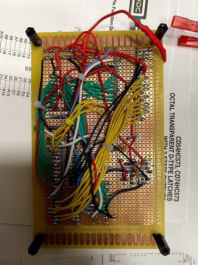

First comment I think is that you don't have enough decoupling capacitance. Normally we see one electrolytic where the power is brought to the board, and then a ceramic or tantalum next to each chip.
Next, you need to know that you've built what you've designed. So, with all chips out, and your multimeter in continuity mode, you need to test all the pin-pairs which should be connected, to check that they are connected, and then test all pins against the adjacent pin, to check that they are not shorted (unless they are supposed to be.) This only takes a few seconds per pin.
And then, I think you're looking for a review of what you've designed.
After fixing up the capacitors and performing the circuit checks, put your chips back in, and tell us what you see and what you don't see.
Ed, you’re right, and every chip has a 100nf capacitor. Check the bottom of the board. Also, I checked every connection, for continuity as well, and we’re good. J
PS do the resistors on the cpu look properly placed?

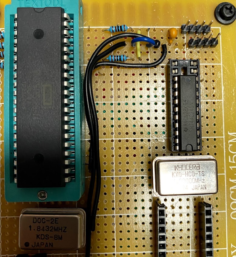

PostPosted: Fri Sep 17, 2021 5:03 pm
Good news on the caps.
I notice your 245 is upside down compared to the other chips. That may be as intended, but as a principle of least surprise it's worth placing all chips the same way up.
PostPosted: Fri Sep 17, 2021 5:09 pm
Joined: Sun May 30, 2021 2:16 am
Posts: 375
Good eye! Yeah, I had to do that to line up Port B with the CPU.
PostPosted: Sat Sep 18, 2021 6:37 am
Posts: 460
You could use the integrated logic analyzer (ILA) component to dump the signals as the FPGA sees them.
This would show if the address / data is what is expected.
Is block RAM in the FPGA being used as the ROM?
