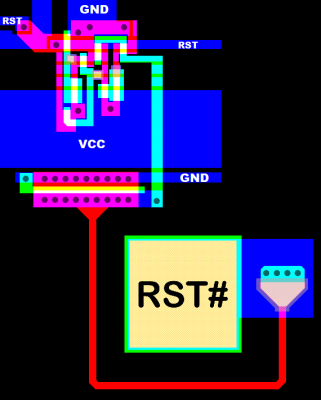

3) RST //reset
The low_active signal from the RST# pad goes through an inverting super buffer,
then through a non_inverting super buffer, and becomes the high_active RST signal,
which puts the innards of the 6525 into a reset.
Note, that the reset in the 6525 happens asynchronously,
because the 6525 has no PHI2 input pin.

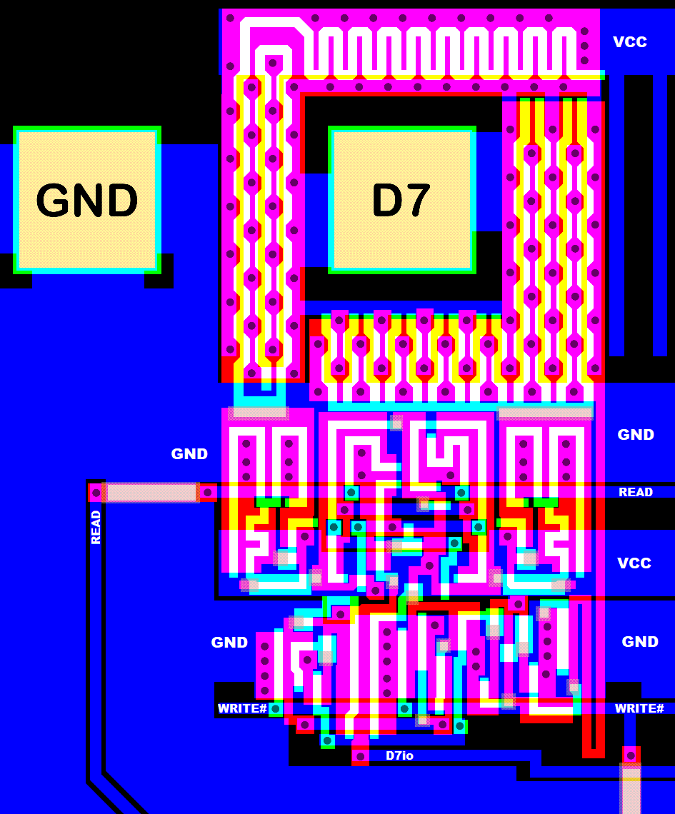

4) D7
D0..D7 buffers/drivers have identical layout, so we just focus on D7.
D7 > D7io: write.
Signal from the D7 pad goes through an inverting super buffer, then through an inverter.
The input and output of the inverter is used to set/clear a RS flipflop which is built from 2 three input NOR gates.
The outputs of the RS flipflop control FETs which are switching D7io either to GND or to VCC.
One trick is that because of the RS flipflops, the FETs switching D7io to GND or VCC do non_overlapping switching.
We already have seen something like that in clock generators, and in the 8726 buffers\drivers.
The other trick is, that both NOR gates of the RS flipflops are fed with the low_active WRITE# signal,
which acts as an output enable for the buffer:
if WRITE# is inactive/high, both outputs of the RS flipflops are forced to low,
what disables the FETs which are switching D7io to GND or to VCC.
The WRITE# control signal is generated in "2) R/W".
D7io > D7: read.
D7io goes through an inverting super buffer, then through an inverter, then through a second inverter.
Two drivers are fed by the input and the output of the second inverter.
The trick is, that a FET controlled by READ switches the low_side FET of the drivers to GND.
Means, if READ is inactive/low, the output of the drivers either is high or "high impedance".
Each driver has a pullup FET at the output, making sure that it _is_ high when a driver is in "high impedance".
Each driver output goes through an inverting super buffer.
The outputs of the super buffers control the FETs which are switching D7 either to GND or to VCC.
So if READ is low, the FETs switching D7 to GND or VCC are disabled.
The READ control signal is generated in "1) CS".
