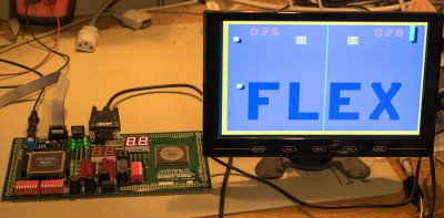

Georgia Tech was using the UP2 for instruction so there are a good number of examples on their website:
https://hamblen.ece.gatech.edu/ALTERA/altera.htm
I downloaded the 'Pong" program to try out on my board. It was originally compiled for Maxplus so I converted it to Quartus. The program is mostly VHDL and consume 883 macrocells out of 3744 available (24% utilization). It ran nicely on my UP2 board. This is a good checkout of my board. Attached is the converted design to Quartus for anyone interested.
