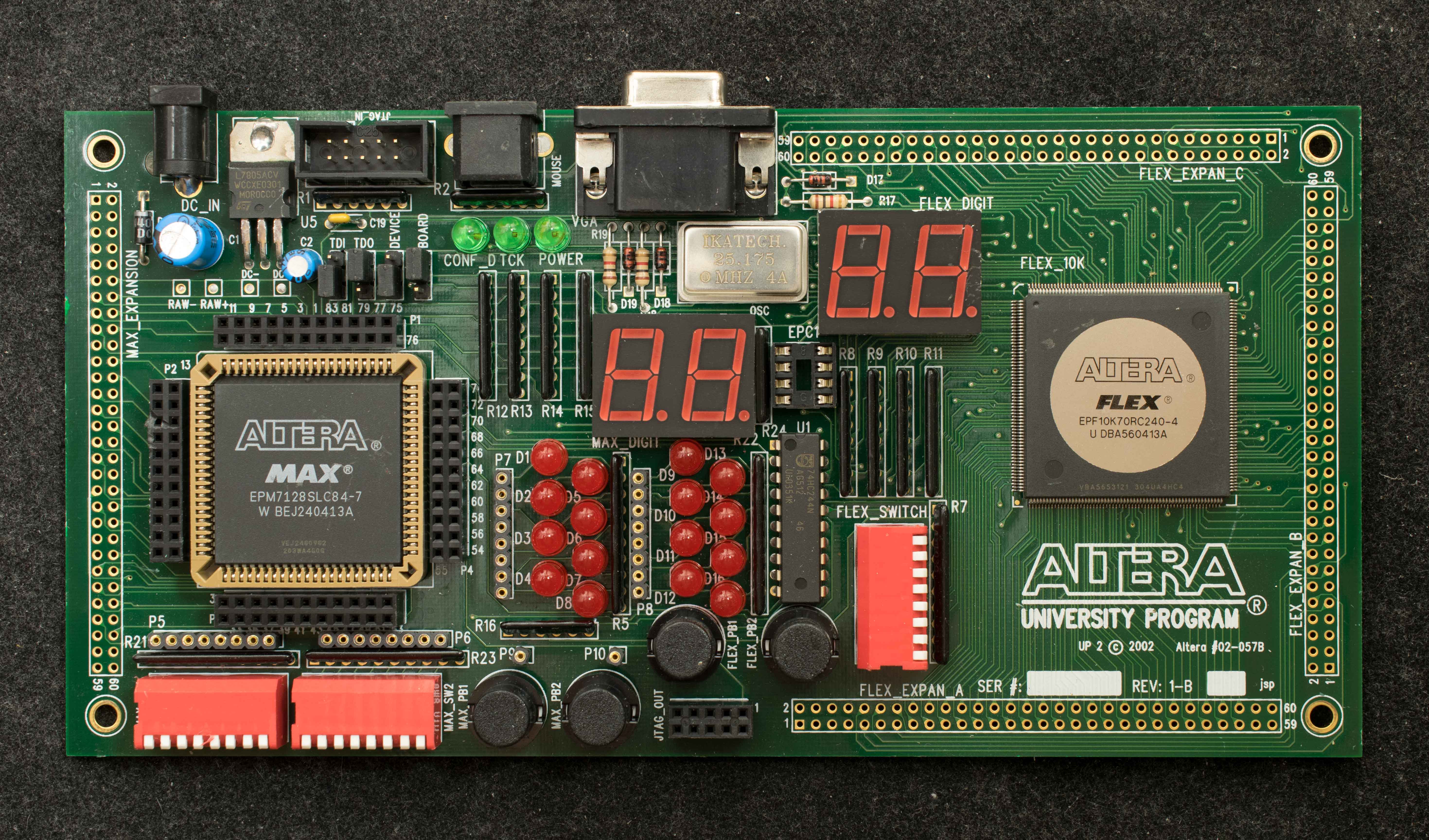

Received the Altera UP2 boards today. It is much nicer than I remembered. The EPF10K70 is one of the few 5V FPGA developed right around the turn of this century. It was rapidly superseded by newer, more dense 3.3V FPGA so now it is pretty much an unobtainum. $32 & free shipping for this board is a great deal now I have a good look at it.
I'm pretty sure EPF10K70 is big enough to accommodate 6502 in Verilog or VHDL so an emulation of 6502 SBC is probably do-able with this hardware. It doesn't have lots of embedded RAM, but should be enough to run small program. I'll play with it a bit this weekend before my pc boards come in from JLCPCB.

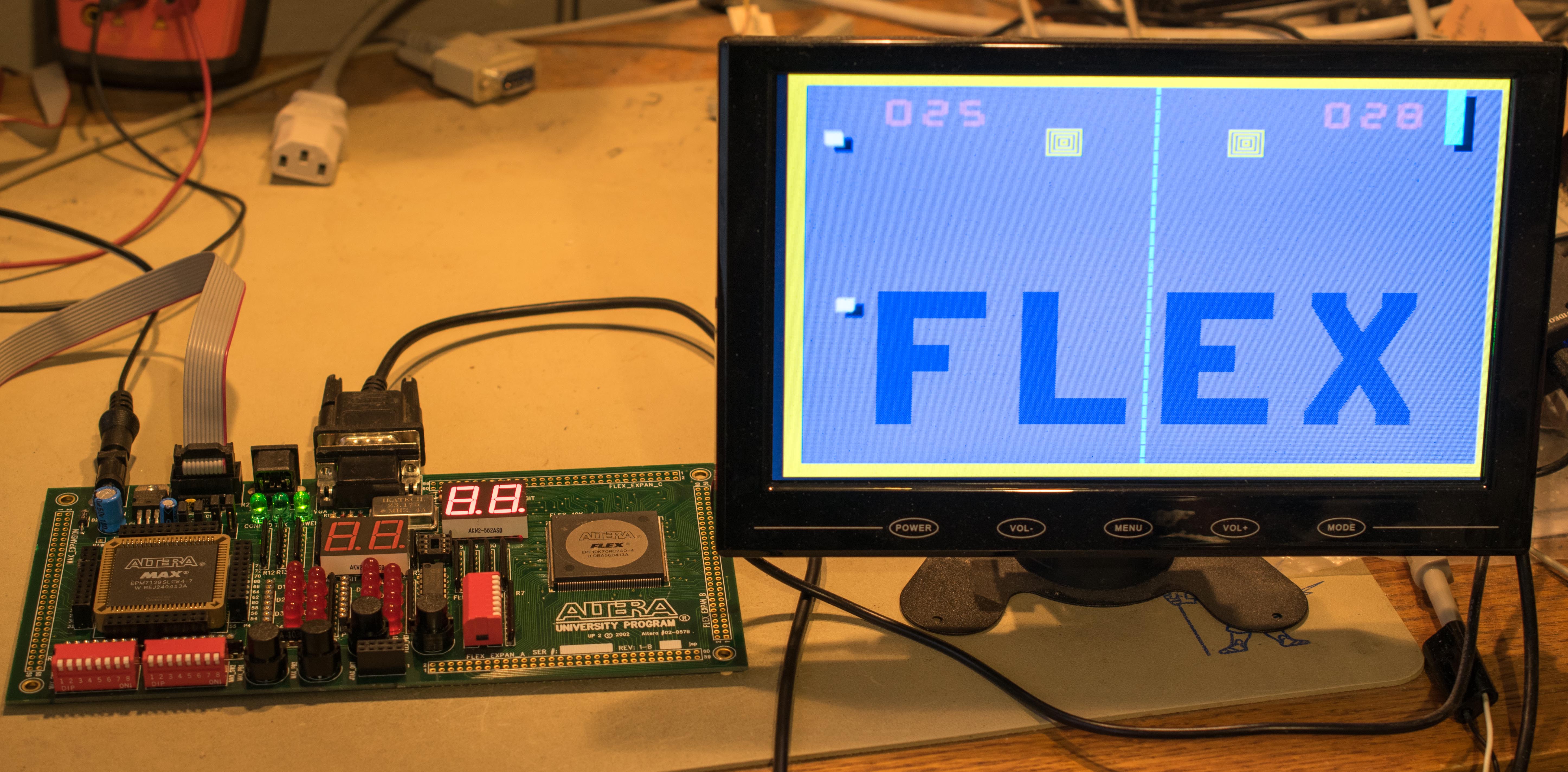

Georgia Tech was using the UP2 for instruction so there are a good number of examples on their website:
https://hamblen.ece.gatech.edu/ALTERA/altera.htm
I downloaded the 'Pong" program to try out on my board. It was originally compiled for Maxplus so I converted it to Quartus. The program is mostly VHDL and consume 883 macrocells out of 3744 available (24% utilization). It ran nicely on my UP2 board. This is a good checkout of my board. Attached is the converted design to Quartus for anyone interested.
