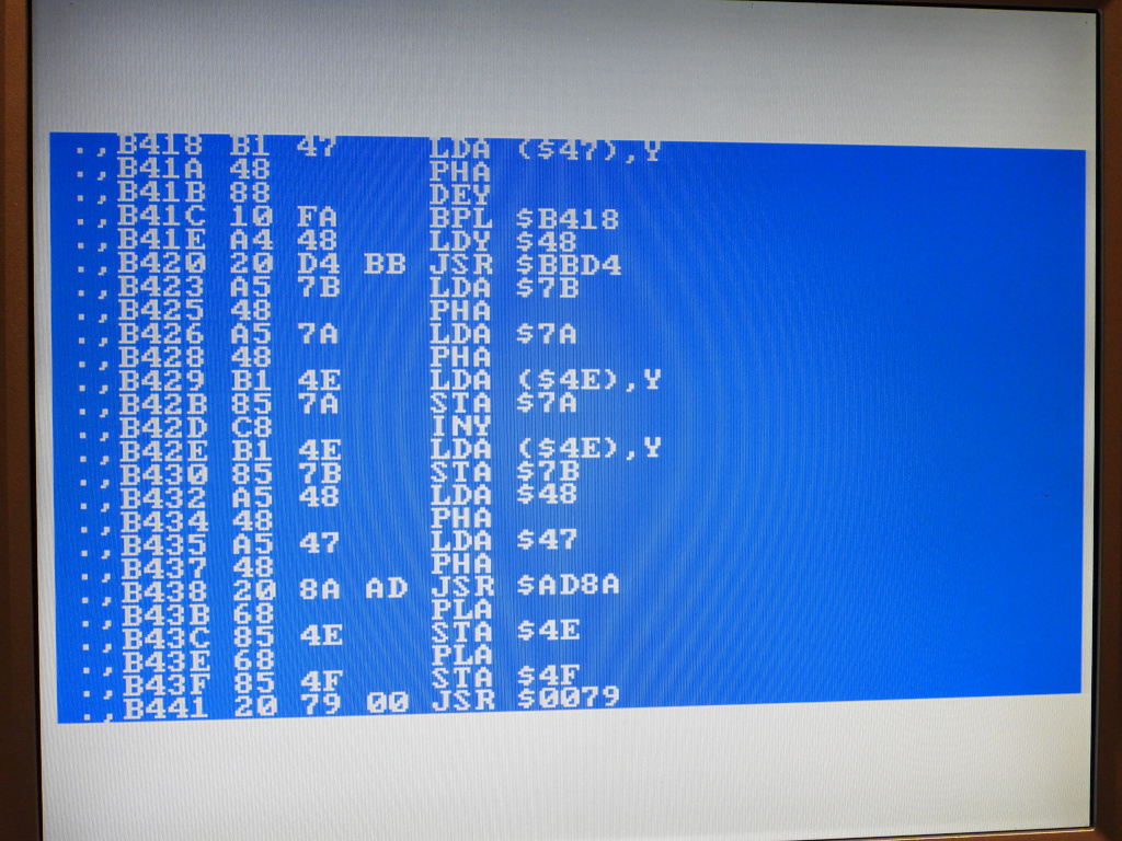

Hi all.
It's been a while since I've posted anything here, I was sidetracked by a few *life hurdles*
One of the last FPGA projects I came up with was a 6502 disassembler written in VHDL, I thought it might be of interest to some members of the forum.
Features of note:
. Independent of host CPU
. Independent of host RAM
. Dynamic display (self modifying code and data changes show in real time)

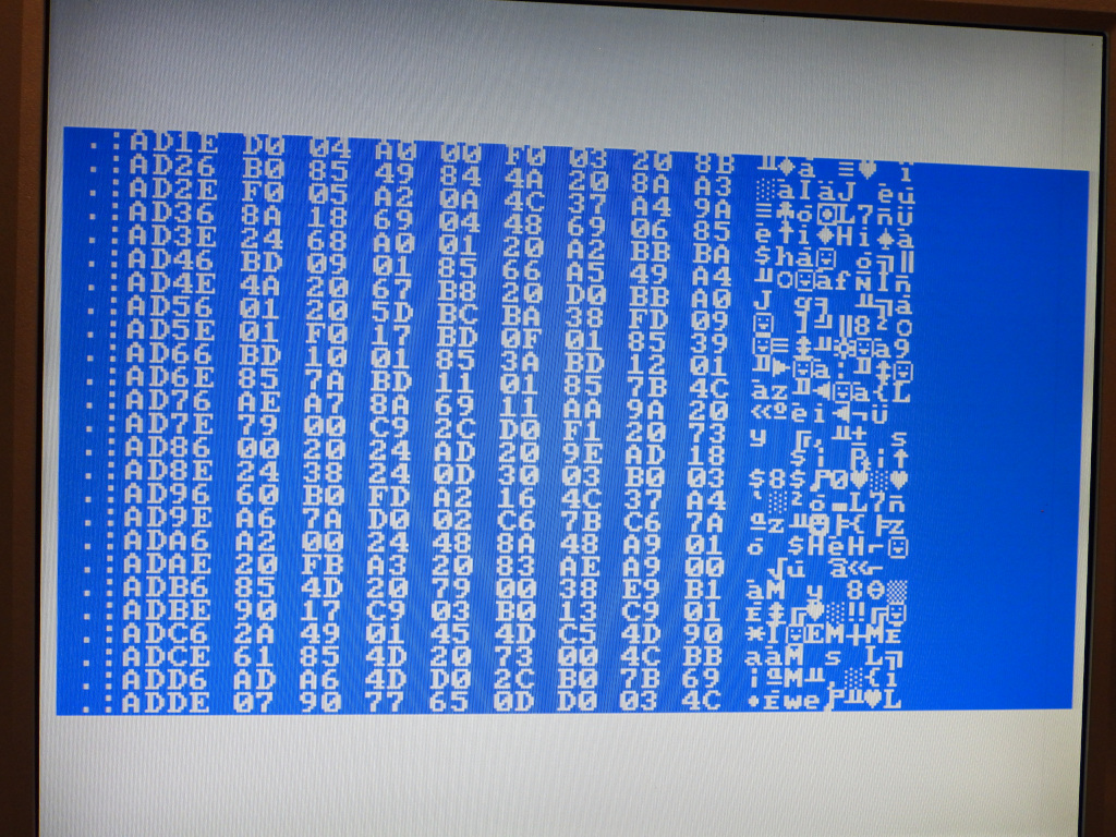

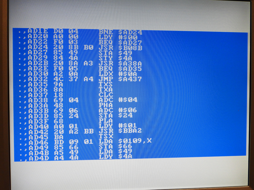

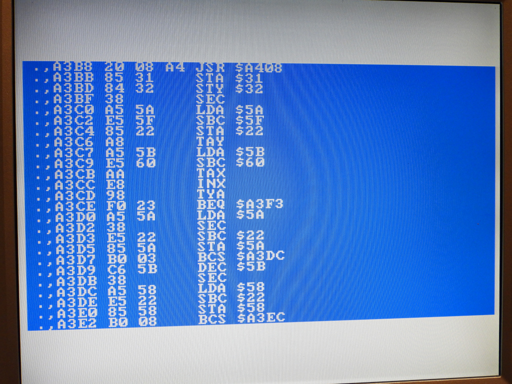

. Disassembly and HexDump modes
. Small size
Currently just a proof of concept, I have it connected to a C64 ROM (and a PC font ROM for character output), though I plan to integrate it into a FPGA based 6502 system at a later date.
̶T̶h̶e̶r̶e̶ ̶a̶r̶e̶ ̶b̶a̶s̶i̶c̶a̶l̶l̶y̶ ̶n̶o̶ ̶c̶o̶m̶m̶e̶n̶t̶s̶ ̶i̶n̶ ̶t̶h̶e̶ ̶s̶o̶u̶r̶c̶e̶,̶ ̶I̶ ̶p̶l̶a̶n̶ ̶t̶o̶ ̶a̶d̶d̶r̶e̶s̶s̶ ̶t̶h̶i̶s̶ ̶s̶o̶o̶n̶.̶ * Source is now commented *
Currently only the 6502 is supported, though I'll add 65C02 support at a later date.
Disassembly of three random sections of the C64 BASIC ROM.
HexDump mode.

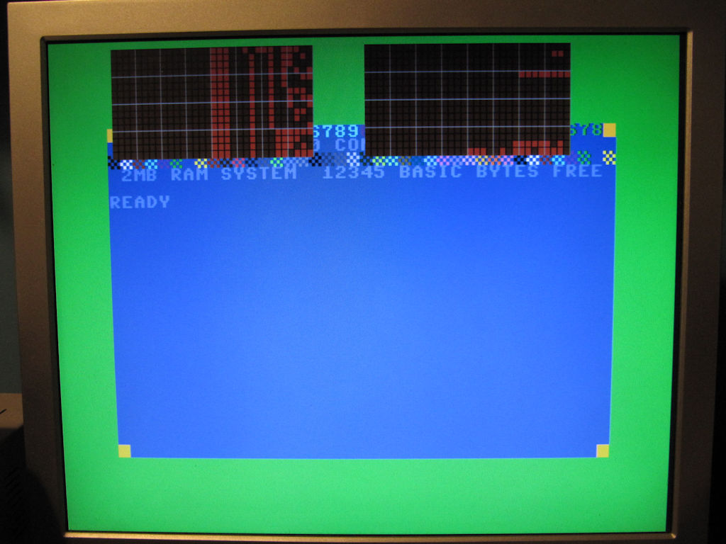

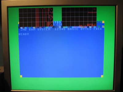

That's pretty cool. It puts my 'debugger' to shame.
(On the left is a list of the addresses of the last few instructions. On the right is the current values of the user-visible registers. In binary. There's a button to execute the next instruction. It's been a lot better than nothing)
C640 'debugger'
C640 'debugger'
